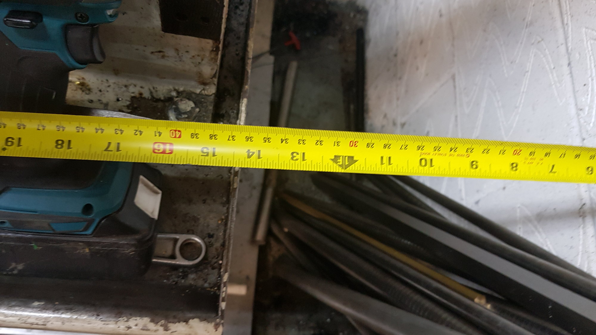

    Well i have now located the problem the cross slide gib jumped past the adjustingscrew at the rear of the cross slide and is now jammed solid.
    The removal of the feed and leadscrew is tricky inany situation and unless the feed gearbox is removed first then the only option is to gently ease off the support bracket past the dowles and slide it off. NOT THE BEST APPROACH i know. but i needed to get into the workings fast and checking with a stright edge all is well (phew!!)
    So all i have to do now is to tap out the brokn Gib strip and see what else has broken

    Before you condem me for bodgery ask the previous owner why the gib strip was cut

    Good news, new gib strips available from 600 group.
    Bad news, £143 ea!

    You do not really need the full length of the gib strip for it to be functional, weld the bits back on and make sure they do not foul the dovetails, all sorted.
