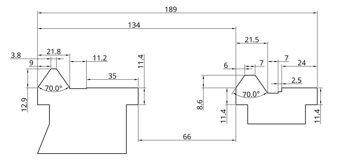

    Does anyone know if the Way profile on the M250 and M300 are the same? They look it but I'm guessing form pictures. I'm after a bed stop, rather than make one i know of one going cheap but it's for an M300.
    Also, i want to build my collection of change gears, again they look the same in photos?
    I know some parts carry over, and some accessories such as the Taper turning Attachment are the same.
    Any pointers would be much apreciated.

    I believe this is for an M300, I got it off the Yahoo Harrison group ages ago. Might be of use?
    R-D-R likes this.

    In case it's of any use, a while ago I had an attempt at measuring and sketching the ways of the M250. I'm not convinced the dimensions are spot on as it was only through measurement and it was quite hard to measure accurately in a lot of areas. So caveat lector, but here it is:
    Please don't go and spend any significant amount of money that depends on the accuracy of this drawing!

    Can't comment on the M300, but the M250 change wheels are 10 mm thick and module 1.5. The internal spline has a critical inner diameter (I'd have to check what this is) but the outer diameter isn't important, so when I made some of my own out of acetal, I used a 3 mm end-mill to make the splines and the gears work really well: https://www.cgtk.co.uk/metalwork/m250/smallmods#changegears
