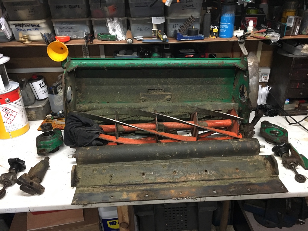

    Had this to work on
    Most of it was lack of maintenance seized up adjusters worn out bushes etc.
    Had to turn up a few nylon bushes free up adjusters

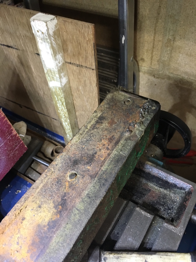

    The worst bit was the cutting blade had been welded on some of the 3/8 unc cap heads had broken off

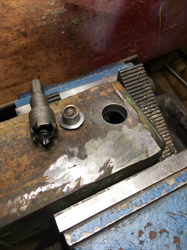

    manage to get them all out bar one that had a broken drill in it so had to come up with an alternative way to fix it so drilled it out with a hole drill and made a plug to weld in

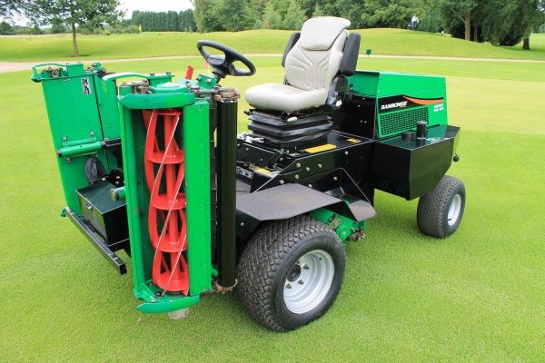

    So its all back in one bit and on the mower just the other two to do lol
    Something different to my normal repair jobs
    Its a RANSOMES HIGHWAY 2130 with Sport 200 Cutting Units 4wd Hydraulic driven powered by a
    Kubota 25Kw @ 3000rpm, 4
    cylinder (in-line) vertical Diesel
    engine, 4-stroke, water cooled

    Out of interest, who’s are the hole cutters? I have a couple of random sizes I’ve “acquired” over the years but never looked into getting any more until recently.

    These
    work very well my only complaint is the spring falls out and the couple I have tried to bend a bit tighter broke :(

    get the cutter's off ebay suprisingly cheap....1 of the best buys on ebay tho......I usually buy 2 off each size.........had a few shatter....
    I save my best magdrill bits for the more acurate jobs.......
    these I treat like disposable.....
    just add the cost to the bill everytime....
    did use 1 of these cutters to drill out about 400x16mm holes in 3 and 6mm plate / bar.....
    still good at the end but did use proper milk type coolant coolant......
