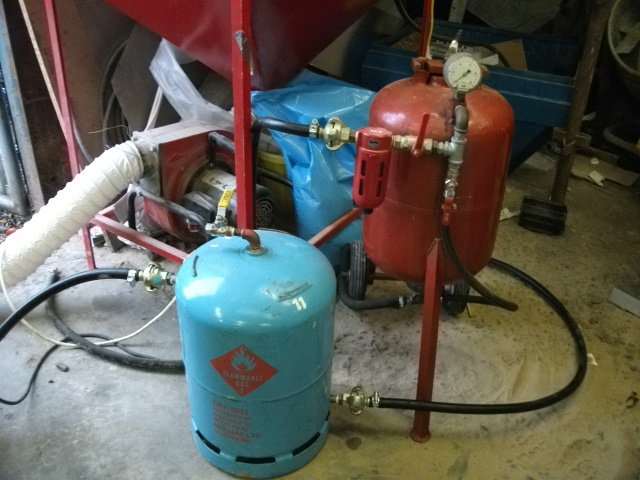

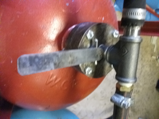

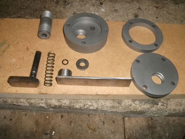

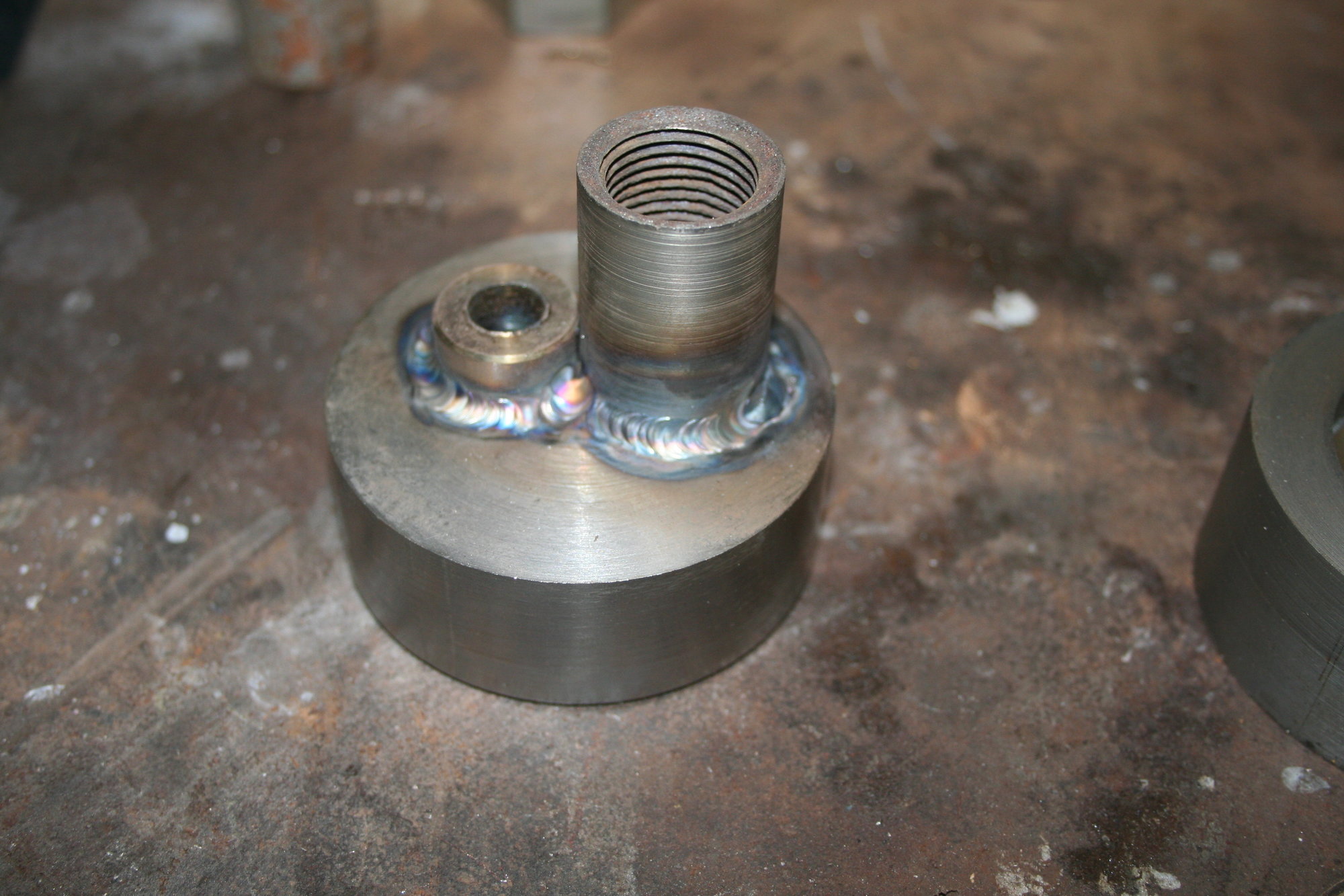

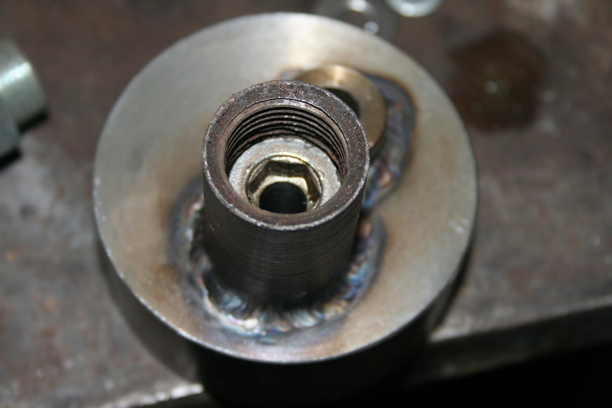

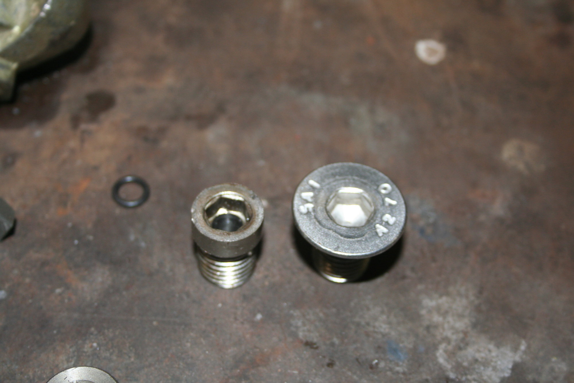

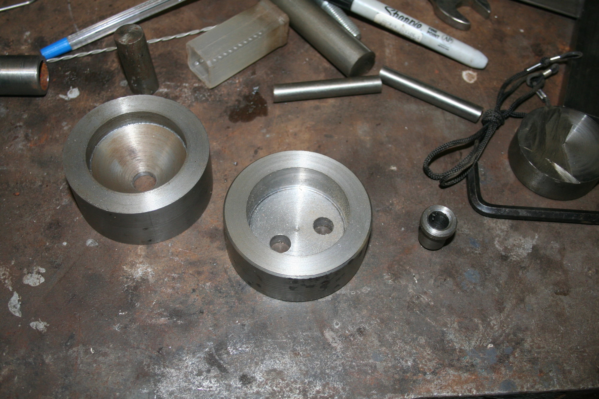

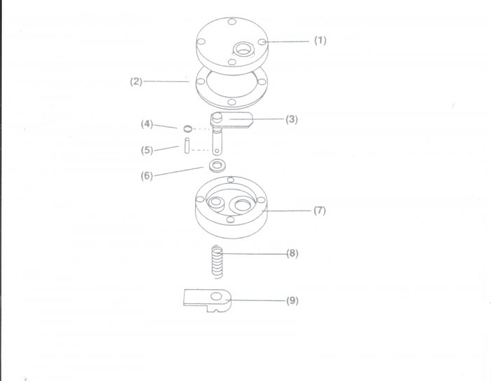

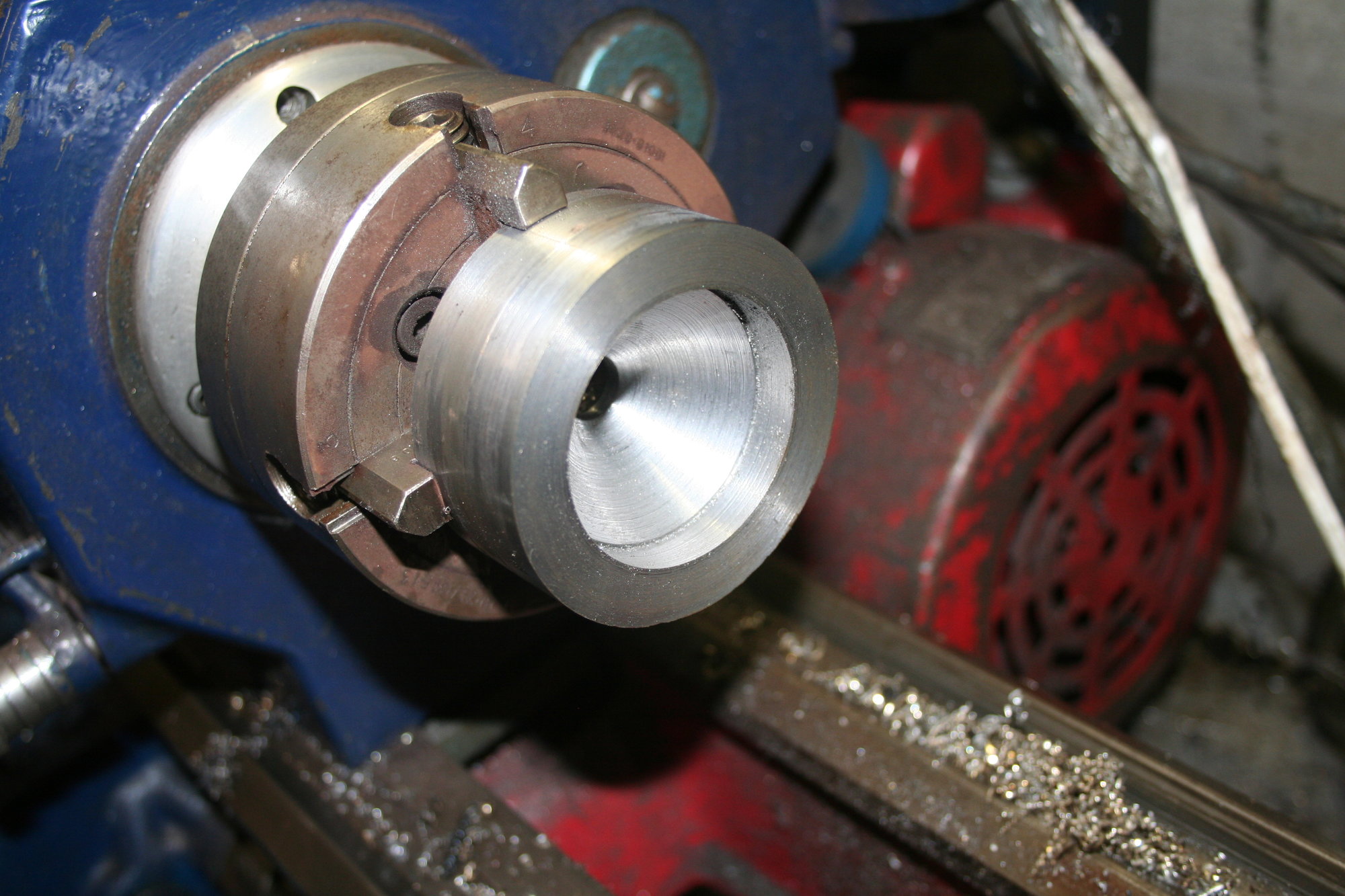

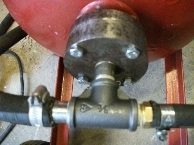

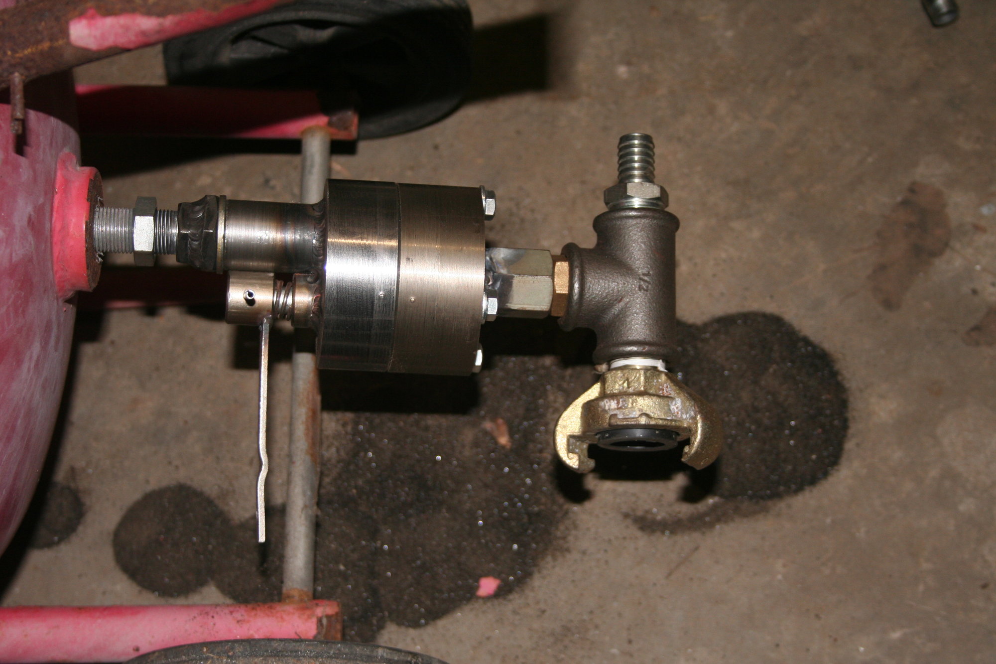

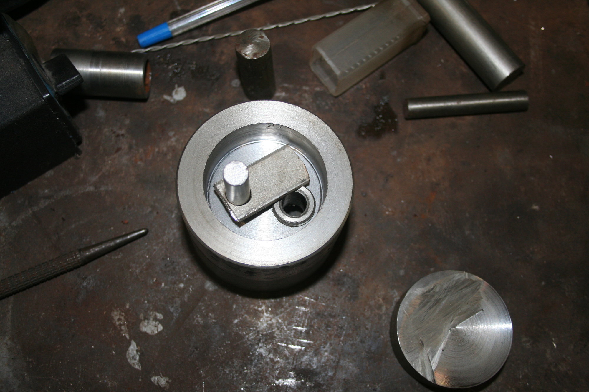

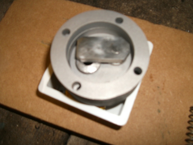

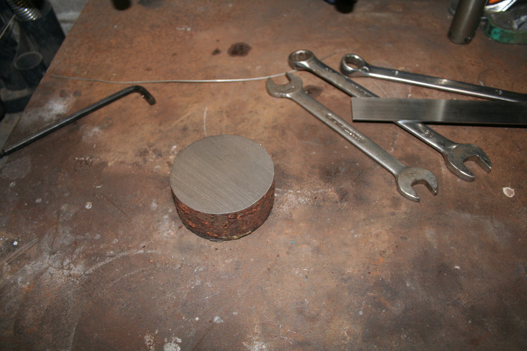

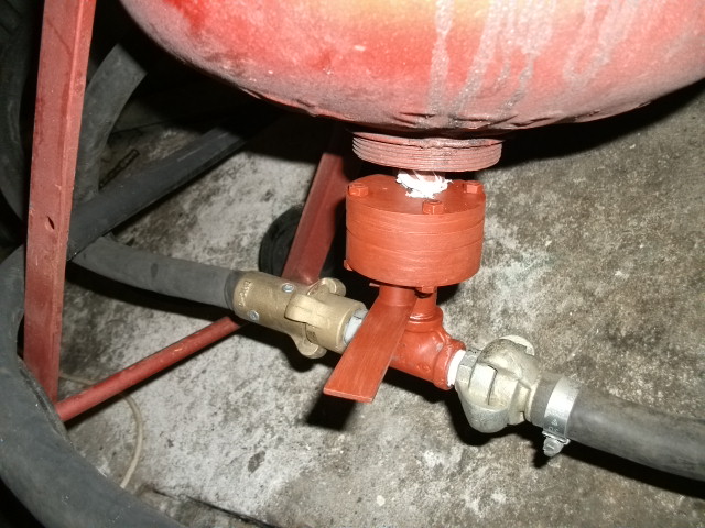

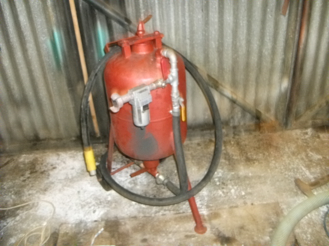

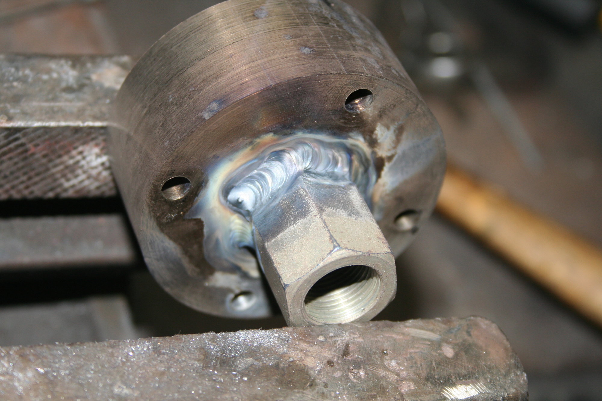

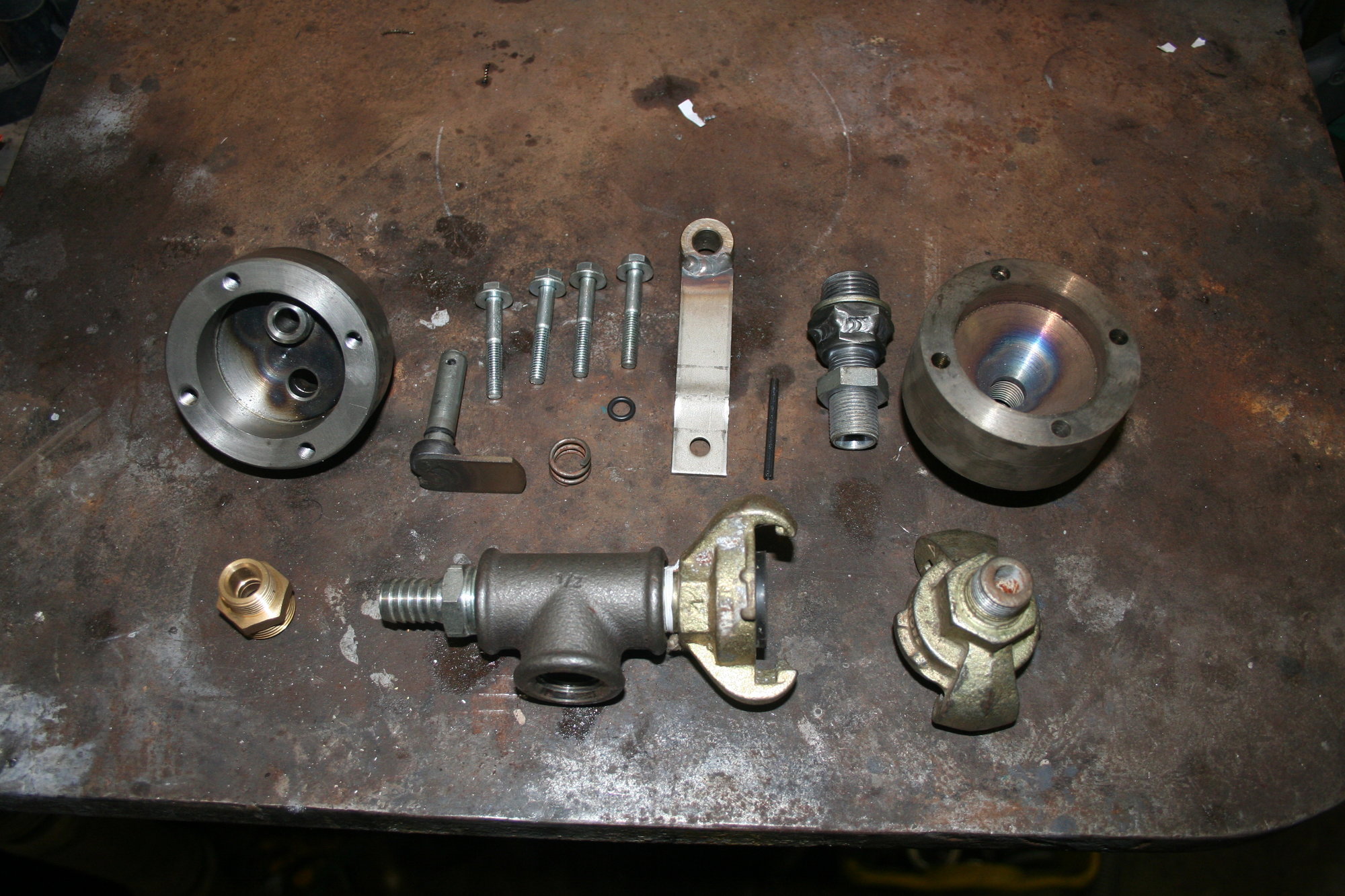

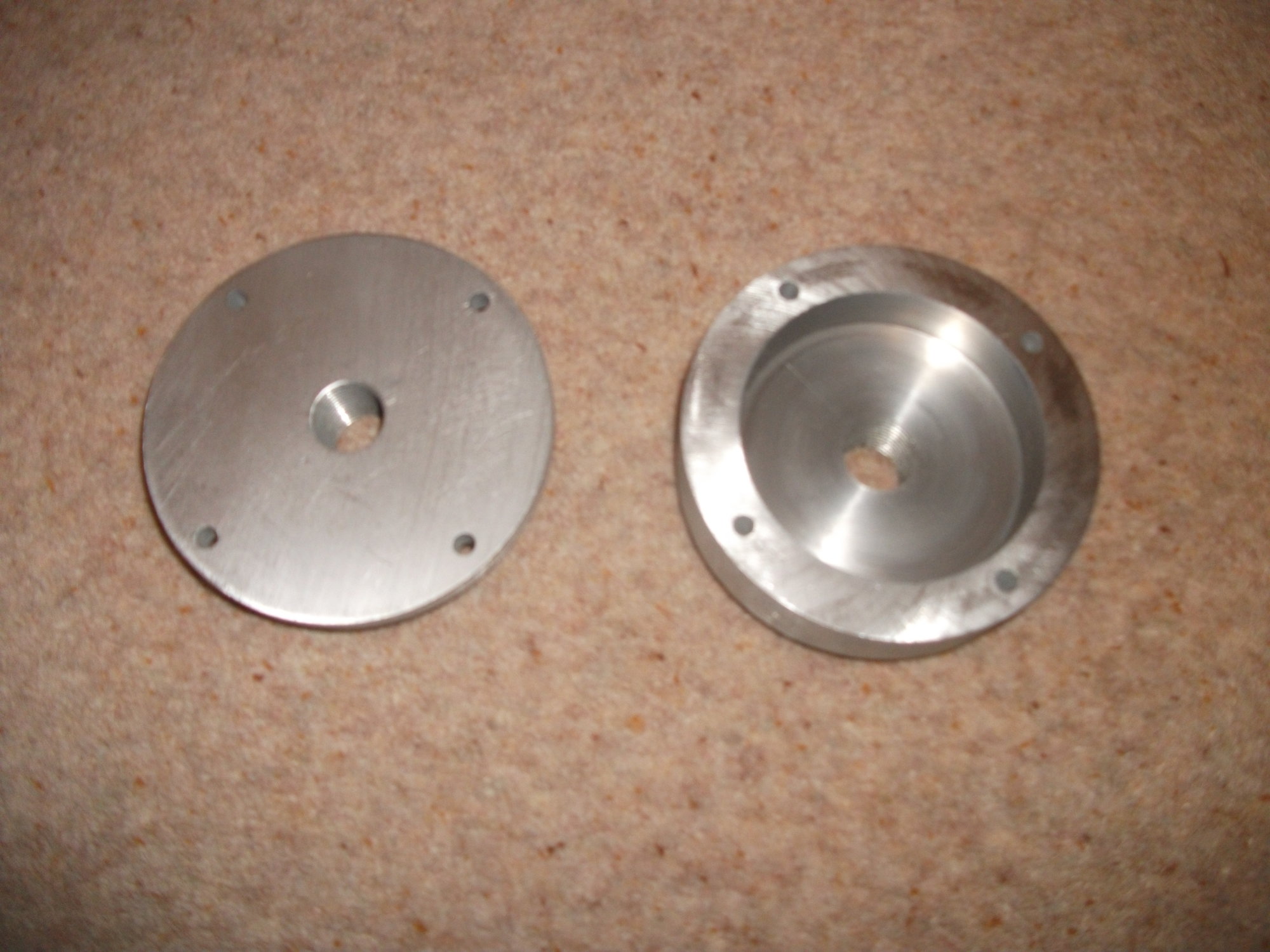

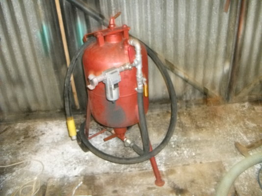

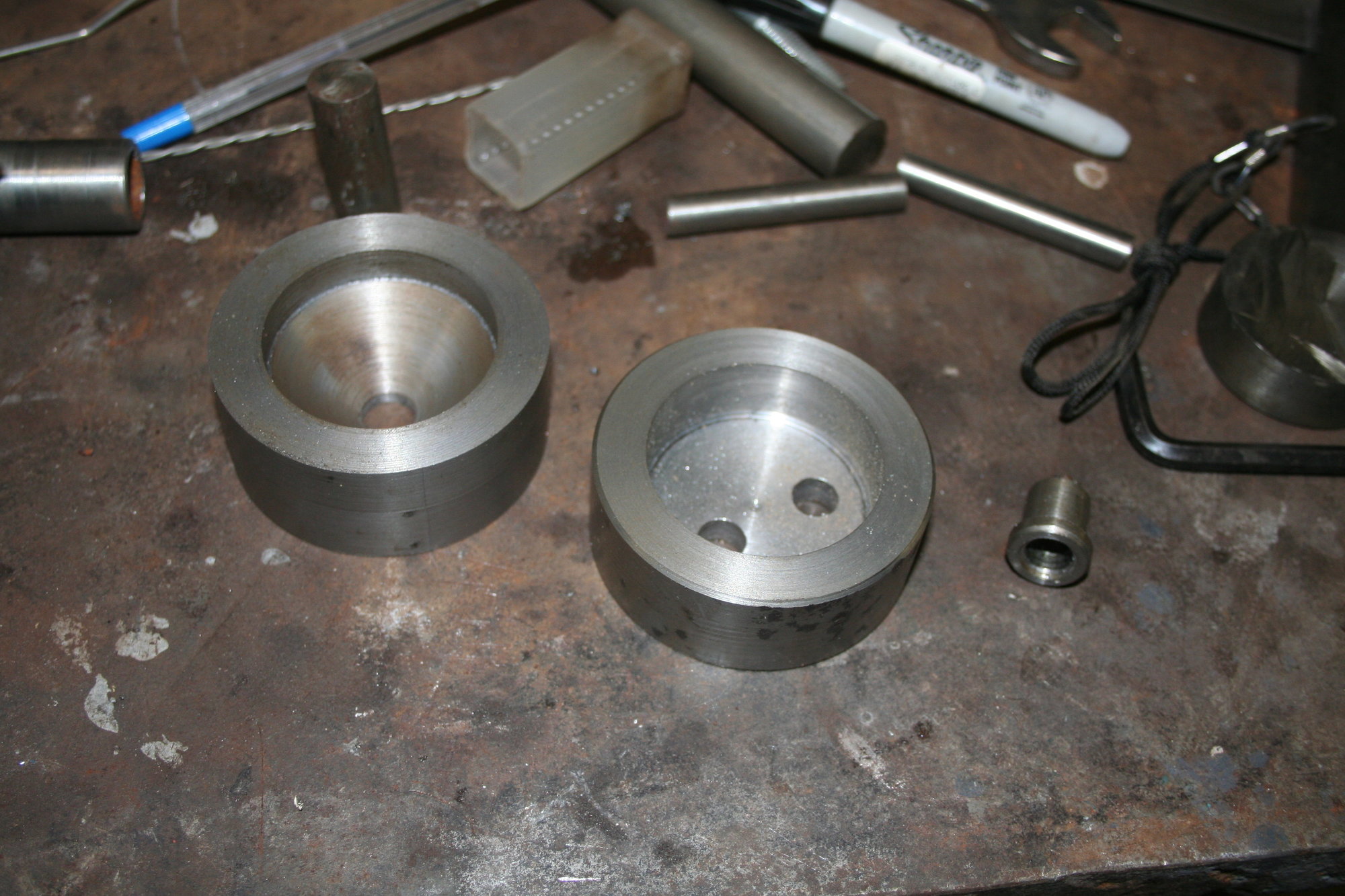

using ball valves to meter the grit is a bit hit and miss and prone to regular blockages namely because of its design and iregular grit size it only takes one larger particle to end up in the orifice and everything stops . even the slightest of moisture kills it off . making a flat sand valve cures the problem no end the grit falls through on to the metering valve which sits slightly higher than the outlet. the lever is turned untill the corect amount falls through.3/8 bsp fittings are used giving a good clearance for the grit to fall through without clogging up/. any iregular media falls to one side of the valve and just sits in the bottom cup and doesnt stop the flow . even with moist air it rarely blocks up and there well worth making heres mine .its fitted to the small pot the larger pot i have will be fitted with the same sort of valve another good help is a cooling cylinder next to the pot and i use c couplings in stead of the eurofittings that are still restricted
