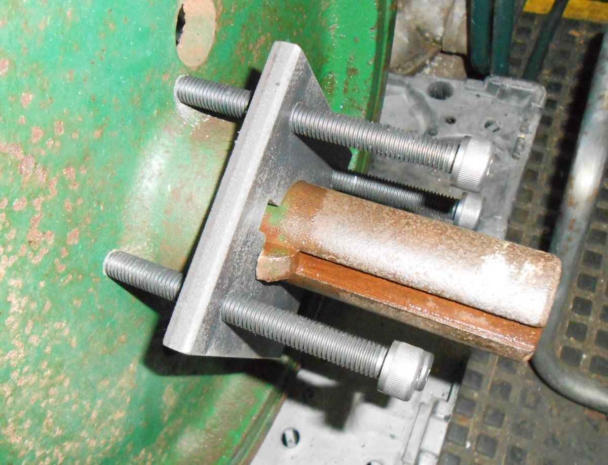

I needed to get the flywheel key out of my Petter A1 and after looking at commercial extractors (cost about £35) decided to have a bash at making my own.
A bit of 10mm plate and a holesaw followed by a lot of filing and 4 tapped holes later....
Well it fits!
Seems to be working
The end result, although why a previous owner attacked the key with an angry grinder I don't know
Next task is to figure out the best way to remove the flywheel.
