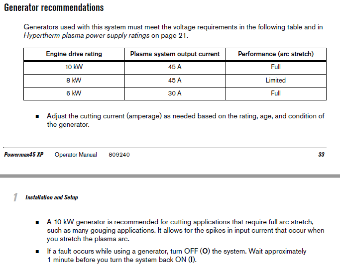

I Interdiction New Member Messages 25 Location Newcastle Upon Tyne Oct 28, 2019 #1 Would anyone know what size Genny set i would need to run the 32 amp plasma cutter ...
