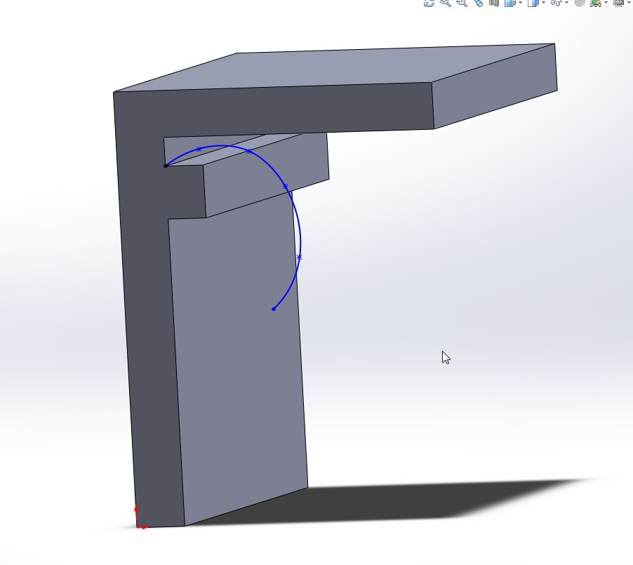

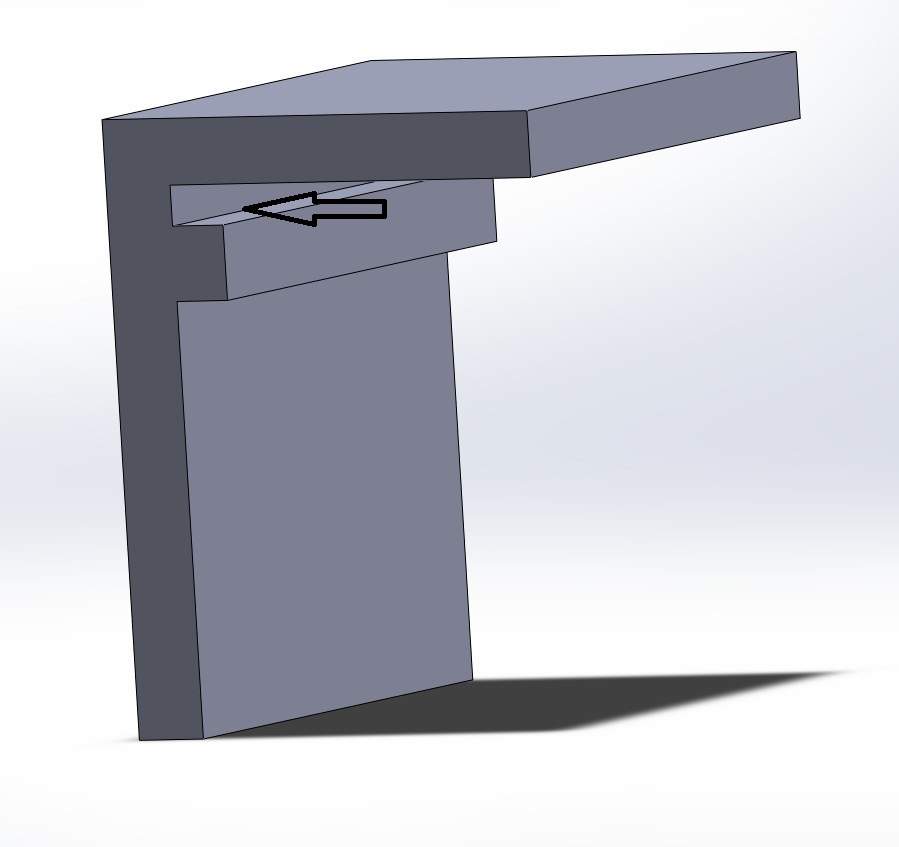

    Example, try getting a mig in to weld on the top of this bit.
    With a stick you just put a nice curve on it and as it is consumed you just roll your hand round to keep it at the right angle.
