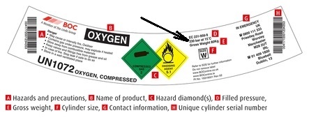

H hotrodder Member Messages 4,583 Feb 27, 2017 #6 It's written on the cylinders label/ID collar, in this example nicked from the internet 230bar @ 15°C

Hitch Moderator Staff member Messages 13,537 Location England Feb 27, 2017 #7 If its proper welding gas cylinders, female thread, are 230bar, and male thread, Nevoc cylinders are 300 bar. Check the cylinder label to be sure. There will be small fluctuations due to temperature etc, plus accuracy of your regulator.
