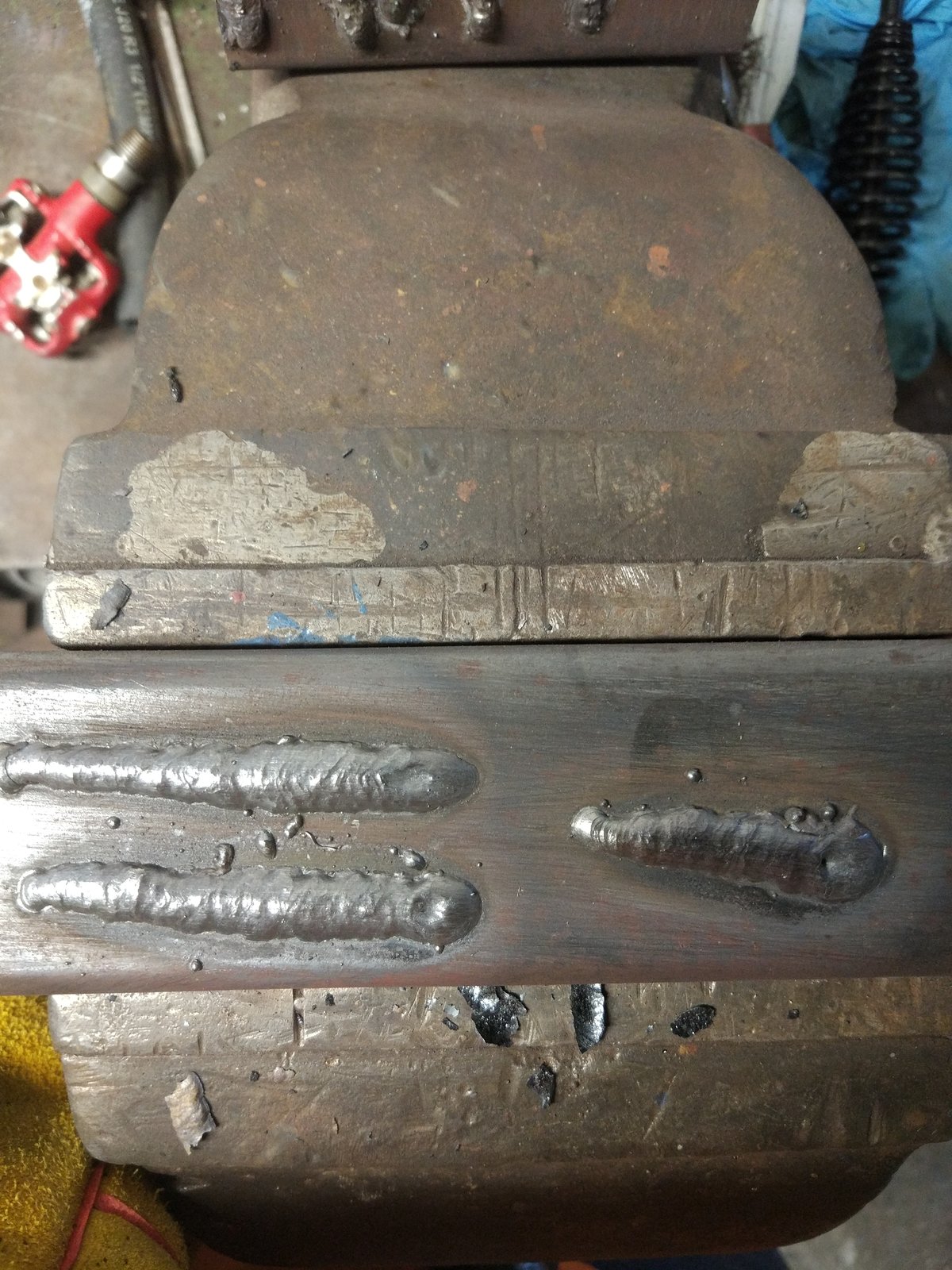

    Tried a few beads this evening.
    Pull, fairly steep torch angle, 20lpm.
    Got some pretty nice beads, slag just falls off with the slightest touch.
    With practice I think I could get it pretty good, was playing a bit with voltage, wirefeed and travel speed...

    24-26v with about 8.5m/min is a good starting point. A 1.2mm dual shield wire should go into spray around about 180A on 80/20

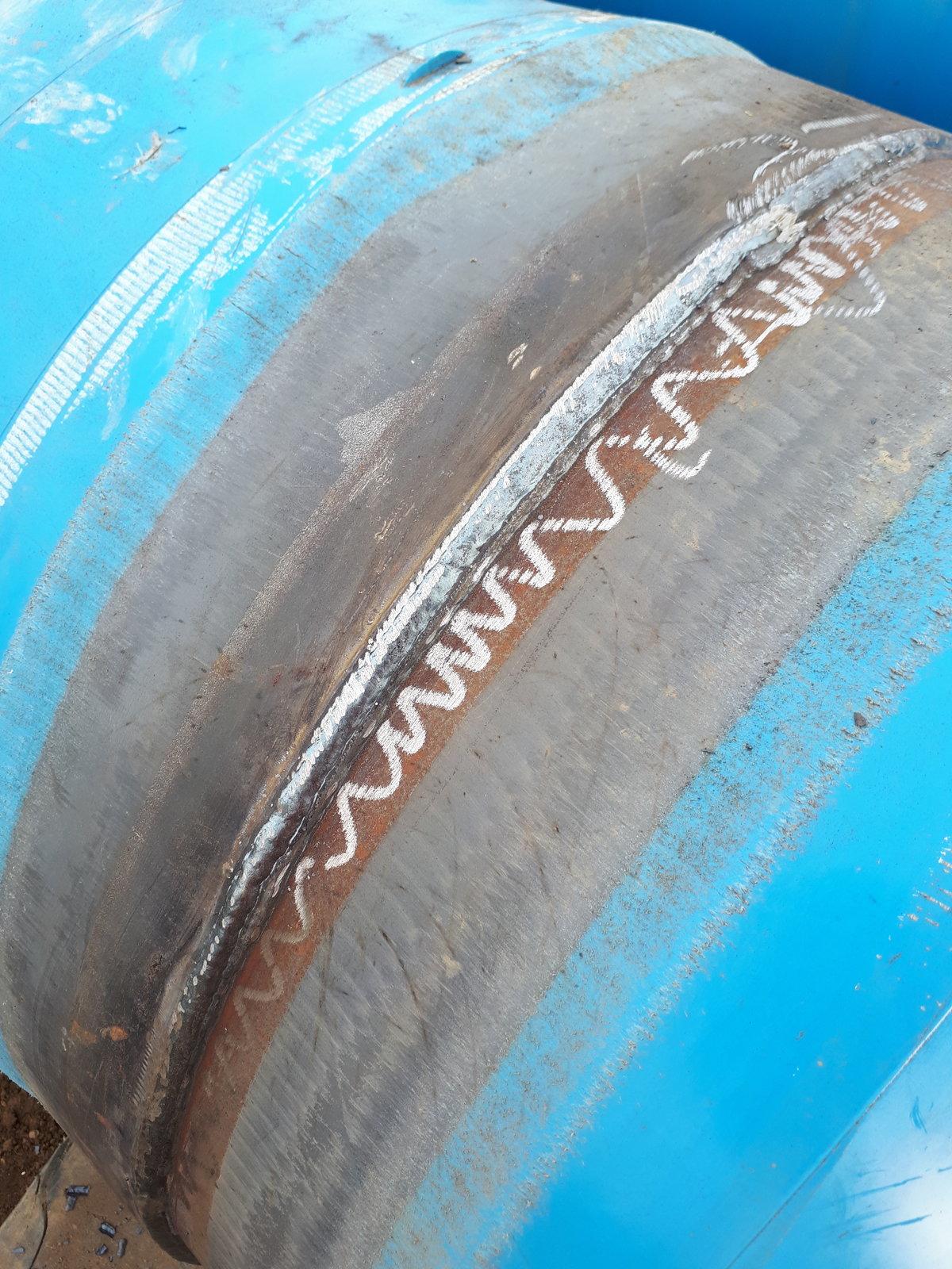

    You need more volts that is way too cold start at 24v dial wire in to get slight background crackle noise
    It welds well in any position drop the wire speed when capping uphill which is pushed of course
    To get more metal in deep v preps and large fillets you can drag and manipulate as you would an electrode but watch you dont lose the gas shield pushing good for capping as less metal with better tie in at toes

    3 runs uphill fluxcore and argoshield heavy around 23 v and 7.4 ms on the climb bit higher on ist pass 20170927_152217.jpg
