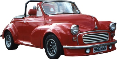

I see you widened the arches by adding material to the body side of the tube. The look I'm after is more like the mog below where the outside edge of the wings have been flared. I think this car was for sale not too long ago, should have brought it, shes a beauty

The wheelarches on the Minor in the photo aren't completely to my own taste (I'd prefer something more rounded) but they would be a lot easier to do than the Beetle wings.
It should be easy enough to buy rear wheelarch repair sections from a 1980s car (something like a Ford or Vauxhall would be cheap) and weld them on to create the flare. You'd probably need to do some cutting of the repair panel, maybe have to use two for each wing, but it would save having to make the complicated shape from scratch.
