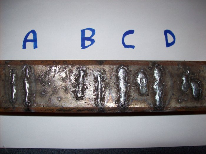

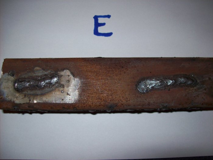

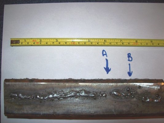

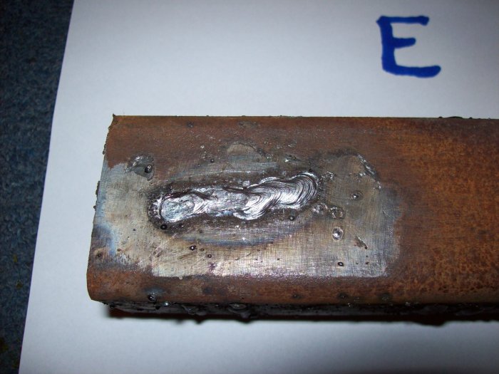

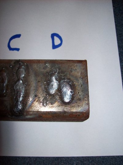

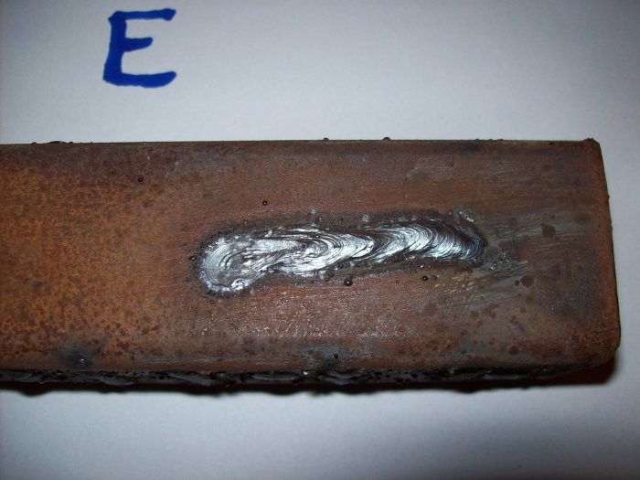

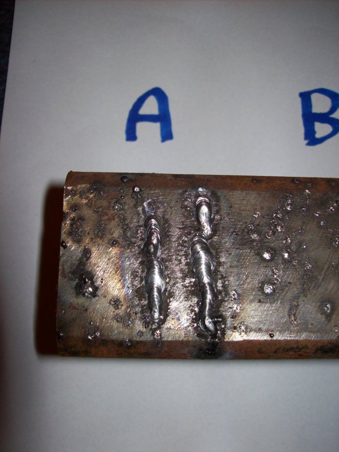

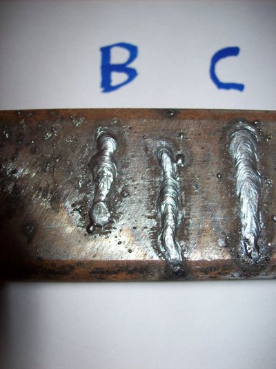

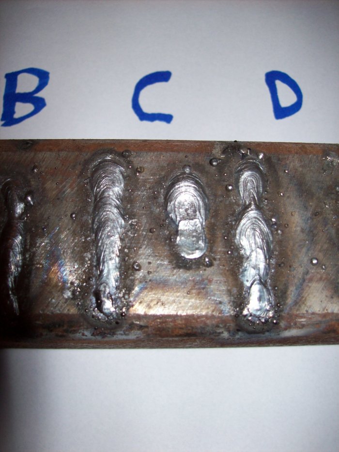

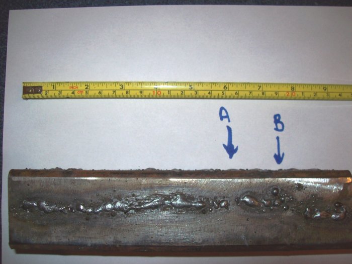

After reconsidering my outlook on the Aldi arc welder, I bought another one and gave it another try.
Here's the results on a piece of 50mm box section (3mm thick). Most of the welds were done with the OEM rods that came with the welder, the exception being Example D - 2.5mm SIPs. I bought some SIP welding rods (2.5mm) out of Halfords against my better judgement (the BOC ones were just too expensive this time of year). Because the SIP rods require a higher OCV of 55V for AC welding, they are a real bugger to strike and maintain a decent arc - sticking frequently.
A = 1.6mm rod @ 40 Amps (OEM)
B = 2.0mm rod @ 60 Amps (OEM)
C = 2.5mm rod @ 80 Amps (OEM)
D = 2.5mm rod @ 80 Amps (SIP)
E = 3.2mm rod @ 115 Amps (OEM)
