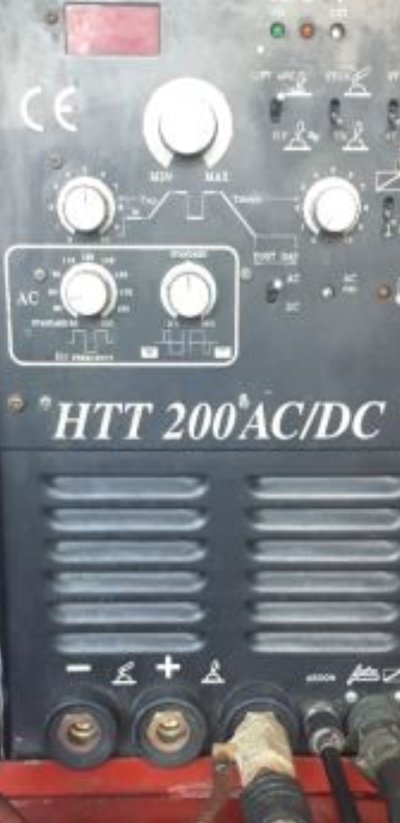

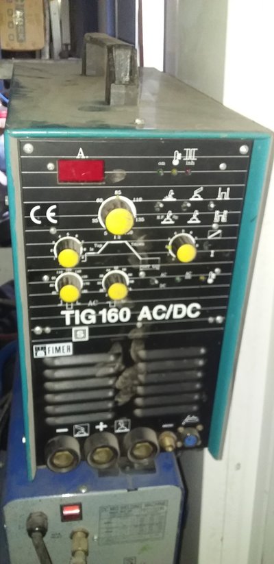

Hi just acquired a fimer machine and it doesn't come with a manual .Being a newbie to tig would love to get it up and running to weld aluminium.Can anyone remember how to set it up or point me in the direction of a manual.
Many thanks
Steve
So it's not a htt200, it's a tig160 instead? No matter.
A TIG torch is a TIG torch no matter what material, you'd probably be best with a WP26 torch. Any torch assembly will work.

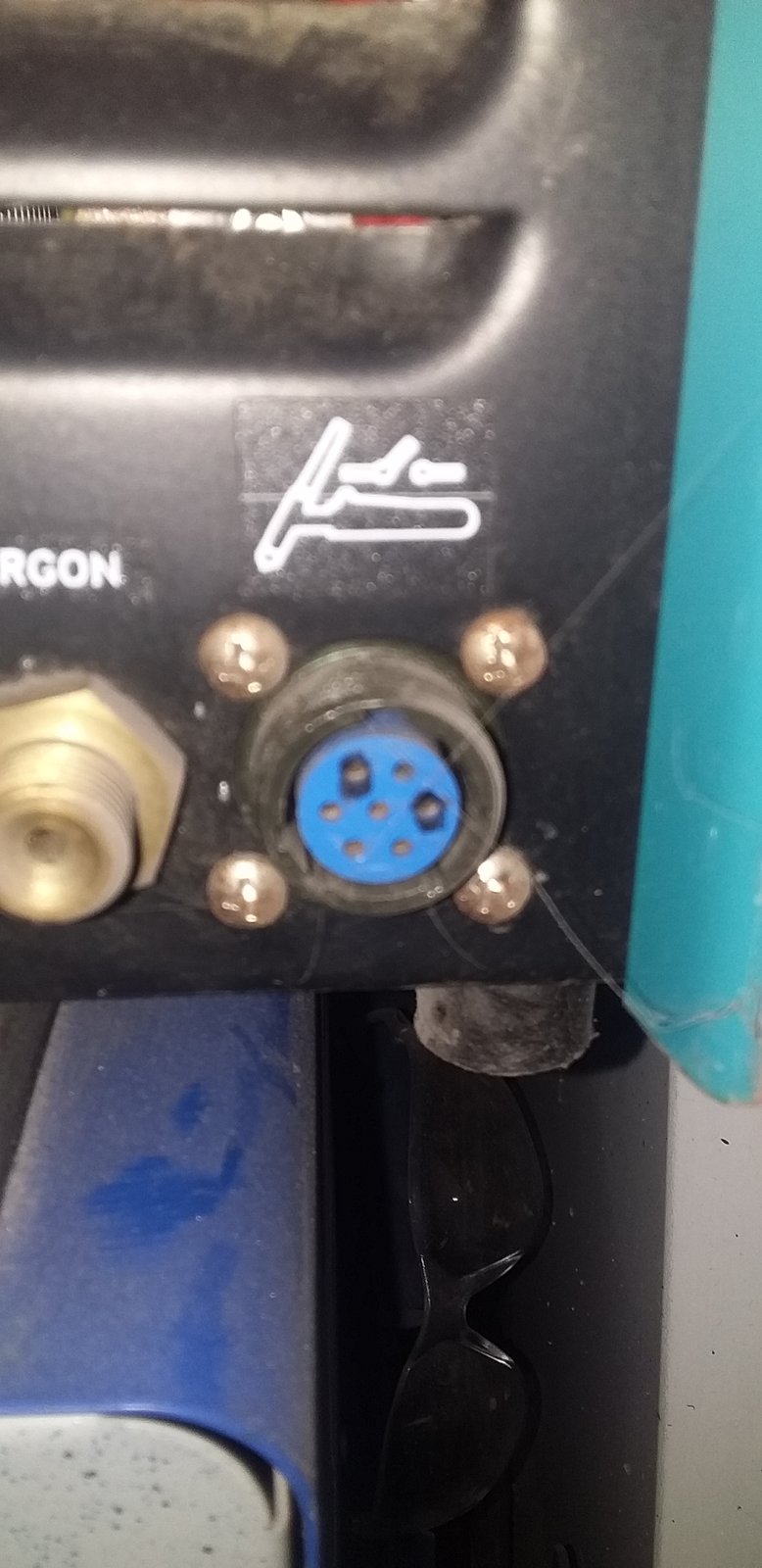

You will also need a correct torch switch plug - take a pic of the lower connections and we can tell you what type it is. Looks like an amphenol type of some size.
