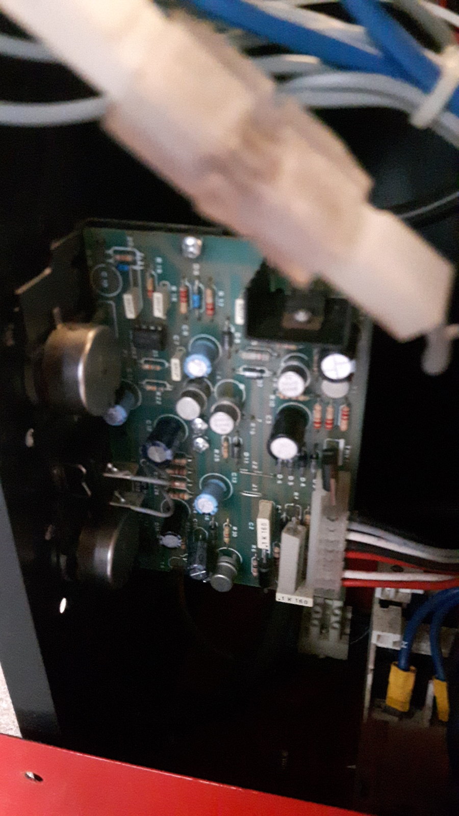

    Ok so ive had a look inside the unit no burns or anything on pcb etc.the main contactor is working
    When i pull the trigger.but theres no power to the wire or the feed motor when i pull the trigger.
  12. Derek c New Member
    Messages:
    19
    Location:
    great britain somerset

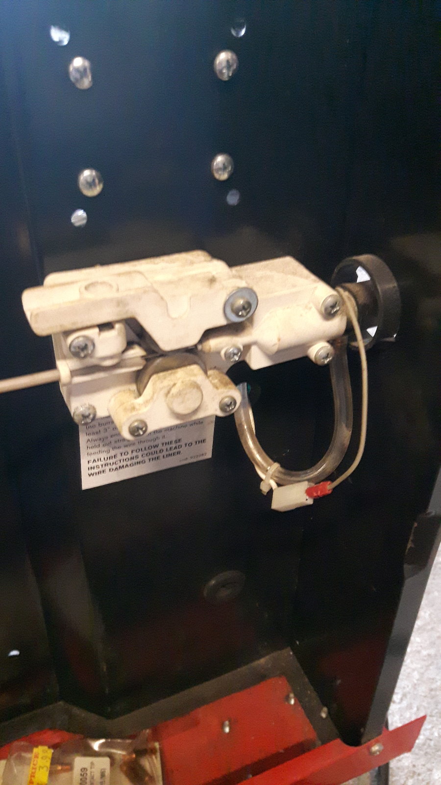

    1524248596257-562725585.jpg 1524248639497-194327030.jpg 1524248709382-1328066194.jpg 1524248596257-562725585.jpg 1524248639497-194327030.jpg

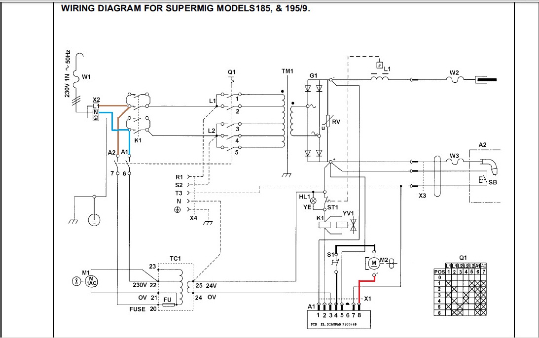

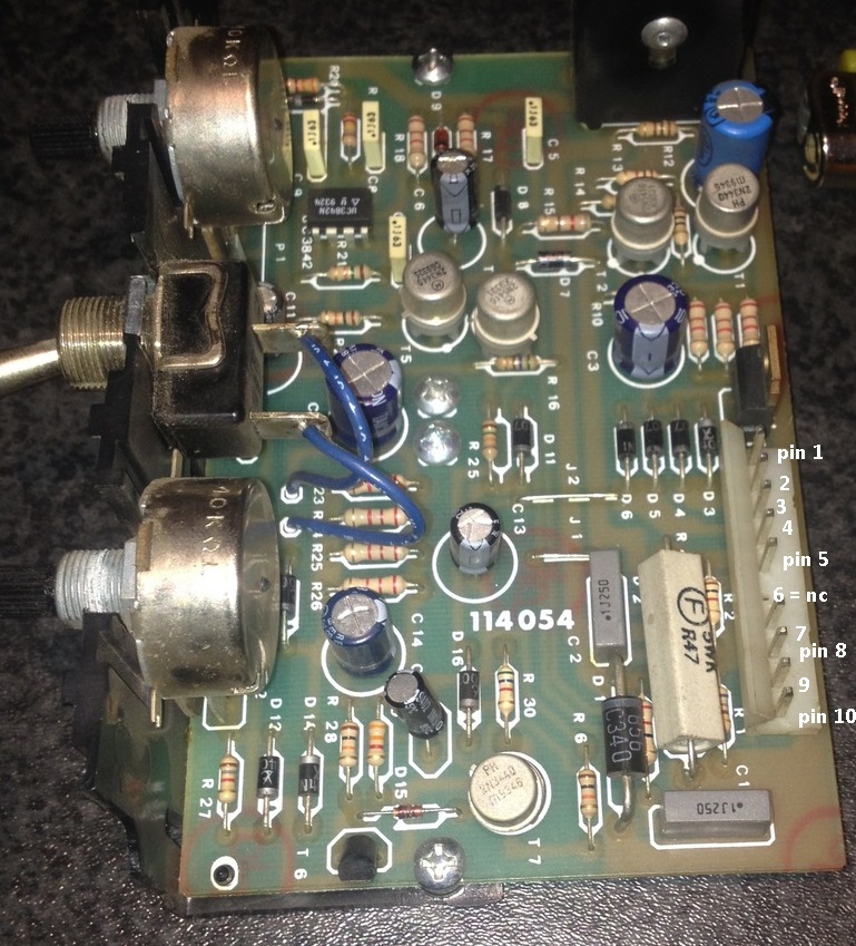

    If not then looking at the images you have posted the board look very much like the 185/195 see pic. Note this has a 10 pin connector plug though. Yours I belive has an 8 pin (one pin not used so 7 wires).
    If you look at the diagram you will see that the mains power comes in (top left) , through the ON/OFF switch "A1 A2" Then goes to a step down transformer. This has a fuse in/on/by (FU) it that will kill the power out of that transformer (it's the transformer to the left of your gas valve in your pic) Note also if the fuse has blown then the fan (M1 bottom left on diagram) will not run, is your fan running ??

    Can't see changing the liner (for what ever type) would cause this issue. Only thing that might have got disturbed when you changed the liner would have been the connector shown in your pic of the feeder. I think that is the feed back from the torch button (goes to pin 7 of the plug on pcb) Should be possible to meter (set on ohms) between pin 7 and 5 while pressing the trigger should show a complete circuit each time it's pressed.

    Is there a key for the circuit diagram ?
    Presuming the switch on the trigger is ok which i think it is because gas comes through when i pressed it .but no arc or wire feed. Where should i be looking now for the fault .?
  17. mike 109444
    mike 109444 Member
    Messages:
    3,934
    uk Bristol
    Items on diagram should be from top left:
    W1 mains supply cable
    X2 connector block
    K1 the switching contacts of the contactor (this is operated by K1 coil, else where on diagram)
    L1 & L2 the primary side (mains in) part of weld transformer
    Q1 ?? maybe the OFF position of the power selector switch
    TM1 the very big transformer, produces the lower AC voltage out for welding (after rectifying by G1
    G1 takes the lower AC voltage from TM1 and rectifies it in to DC
    RV soakes up any spikes on the output of the DC voltage.
    L1 the thing that looks like a transformer but only has one wire in and one out (to the work ground lead) It helps with the weld arc stability
    W2 the work clamp lead
    A2 A1 the Mains ON/OFF switch
    R1 S2 T3 N and X4 these I think are the connections on the contactor K1 (X4 being a connector block)
    HL1 YE and ST1 are the over temperature switch (the metal disc about 1 inch in dia) mounted to the transformer windings plus the over temp lamp
    K1 is the coil part of the contactor that pulls in the switching part of K1
    YV1 is the gas valve coil
    W3 welding torch lead
    SB Torch trigger
    M1 fan motor
    TC1 small transformer that supplies low AC voltage to the pcb
    S1 not sure what this is. It maybe part of the thermal cutout switch ST1 to stop the feed motor if welder goes over temp ??
    M2 this is the wire feed motor
    Q1 is the switching positions and what combinations they Make and Break
    X1 is the header plug that plugs int the pcb
    A1 is the pcb (no circuit diagram available for pcb

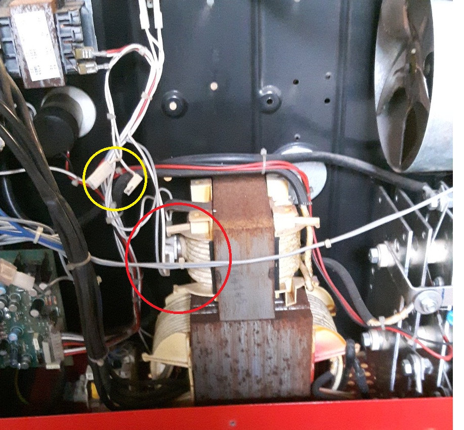

    Looking back through the post I see you say that the "power light" is ON but if you are referring to the amber light on the front then I think you will find that is an over temp light HL1 on the diagram! If that is the light (and obviously you are not running it to go over temp) then it could be the over temp sensor ST1 that has stuck open circuit. See pic below of item in red circle. To check, pull the two spade connectors that are going into it and make up a link cable to join them together and see if that allows machine to operate.
    Note can you also trace where the two unconnected wires go to as in the yellow circle.
