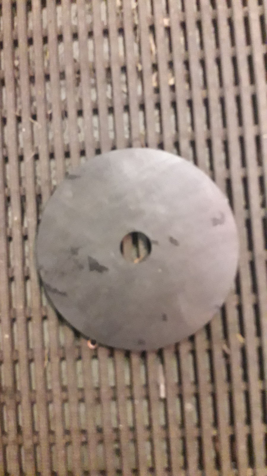

    Hi. I have to bore out the centre of a disc after I put the wrong size on a drawing for lazer cutting.
    I can centre easily enough but anyone got any examples of how to clamp?

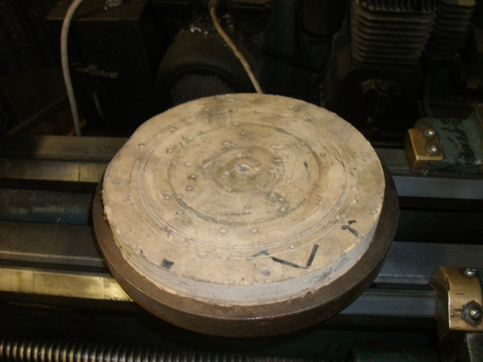

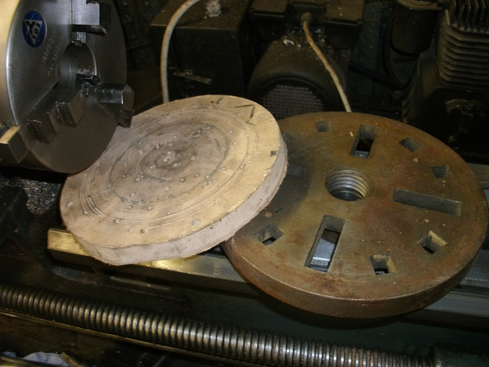

    make a wooden plywood disk about half inch or 3/4 thick and screw to faceplate from behind using washers and woodscrews put the disk on and clamp with some penny washers screwed on round the edges or a bit of flat bar then bore it out. keep it because its handy for fastening other projects to when needed either clamped or screwed to it :)I bought a lathe and got one supplied with it . saved me making one

    Double sided tape. Don't use too much or it'll be a cowson to remove.

    Hot air gun;)

    If you can get away with it For the application , tack a piece of pipe to the back somewhere near the middle that’s bigger than the hole you need and put it in the 4jaw.
    Make sure you face off the pipe first so you’ve more of a chance of running it true
