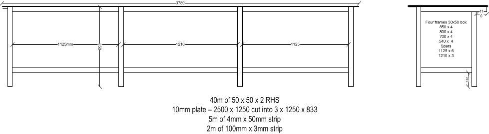

Now I've got the hacksaw working, I thought I would get started on a proper bench.
This is the design, the bench will be welded to some plates and these bolted to the floor. Also there is some heavy channel section behind the bench that is already welded to the barn columns so it will be bolted to that two.

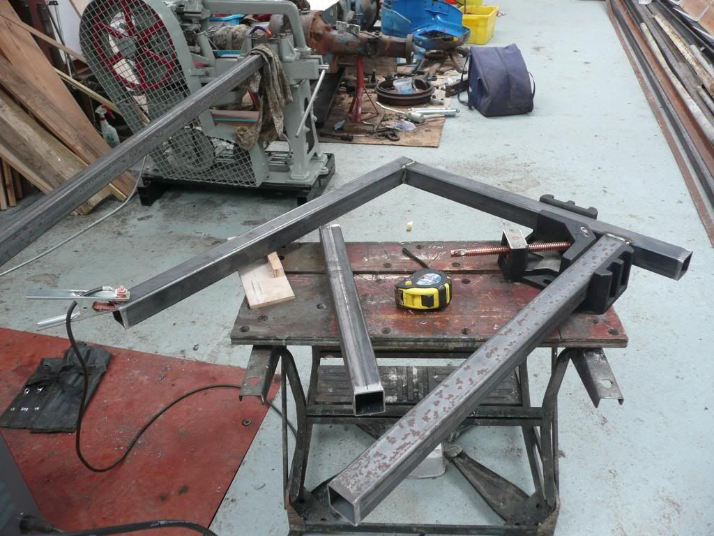

I've just finished one of the four frames, here it is in progress.
My welding is getting better, not perfect by any means but I don't jump for the angle grinder quite so fast now after finishing a weld
