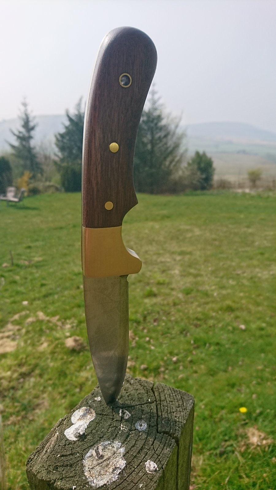

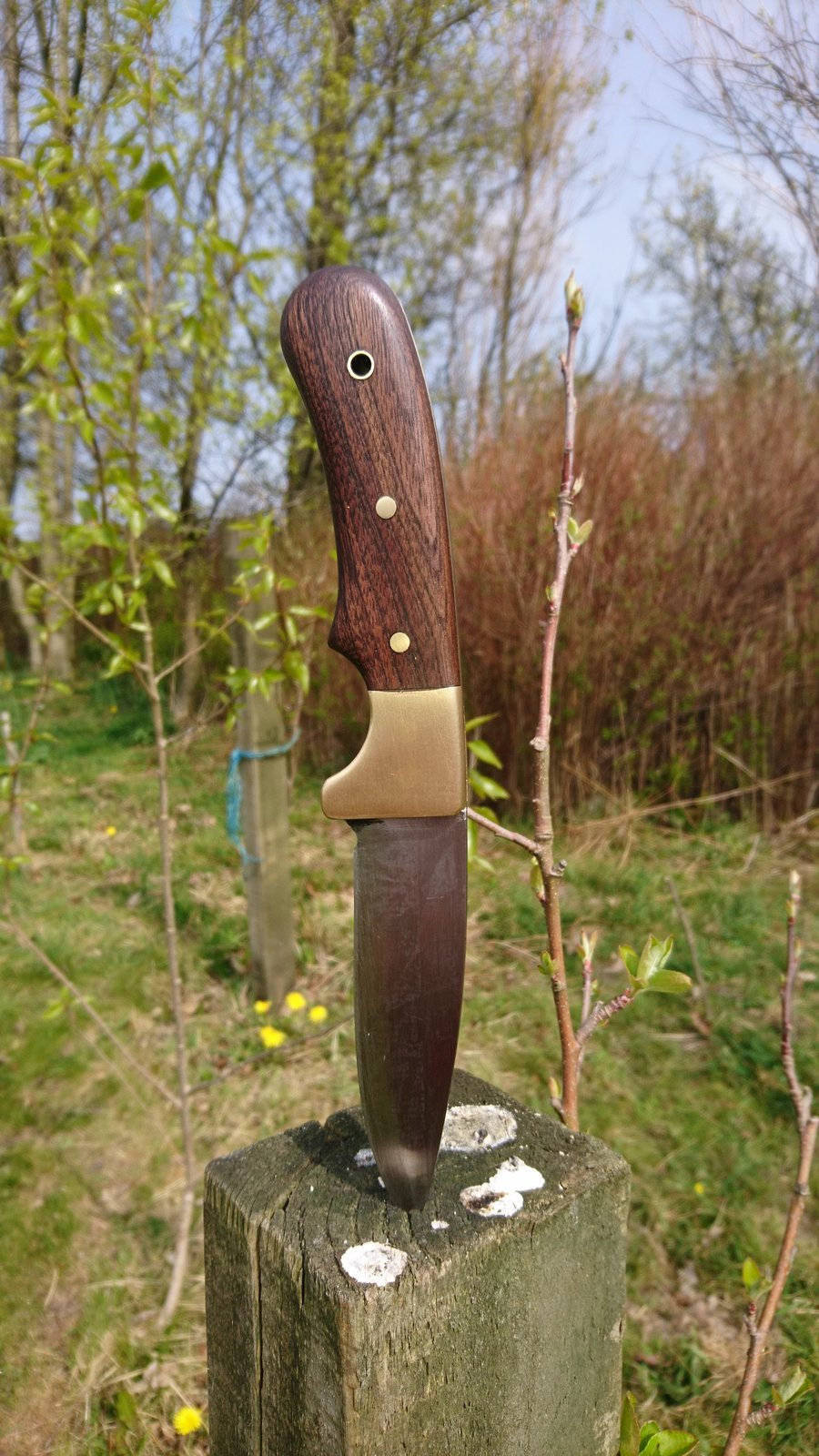

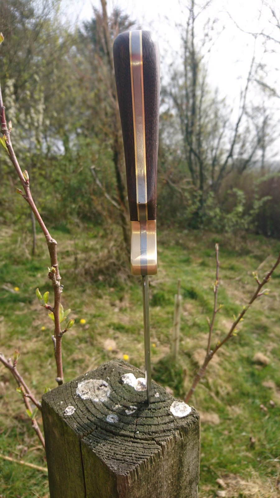

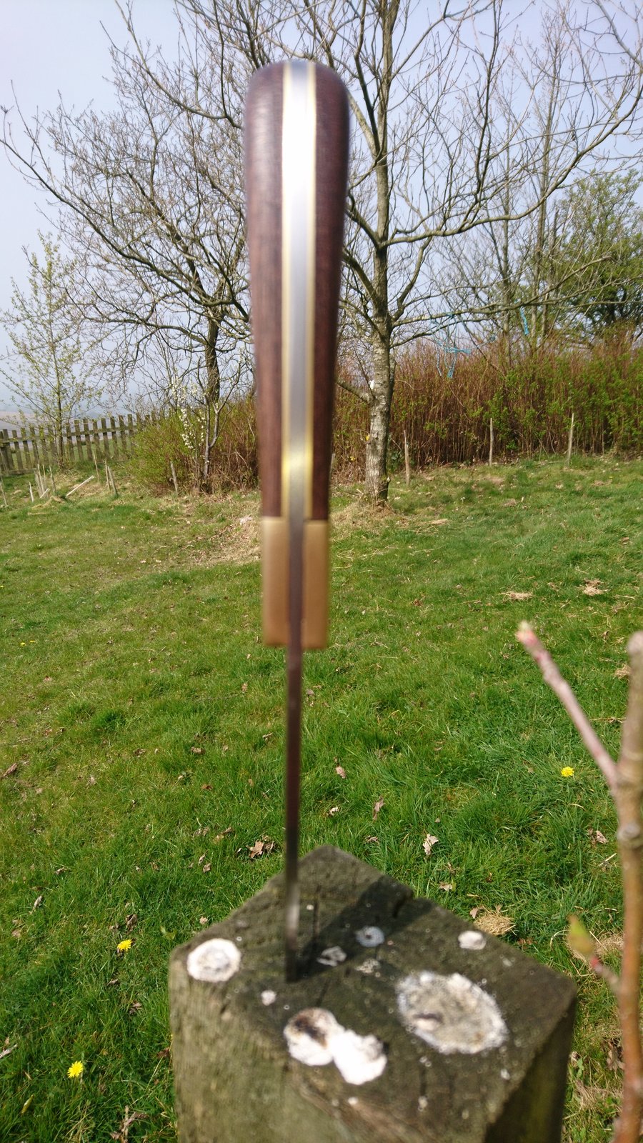

Been building this type of knife a while now.. This its latest version with brass liners a peened on guard. Brass pins and lanyard tube
Walnut scales with a London gun oil finish and 4mm 01 tool steel with a Scandinavian grind and differential temper
