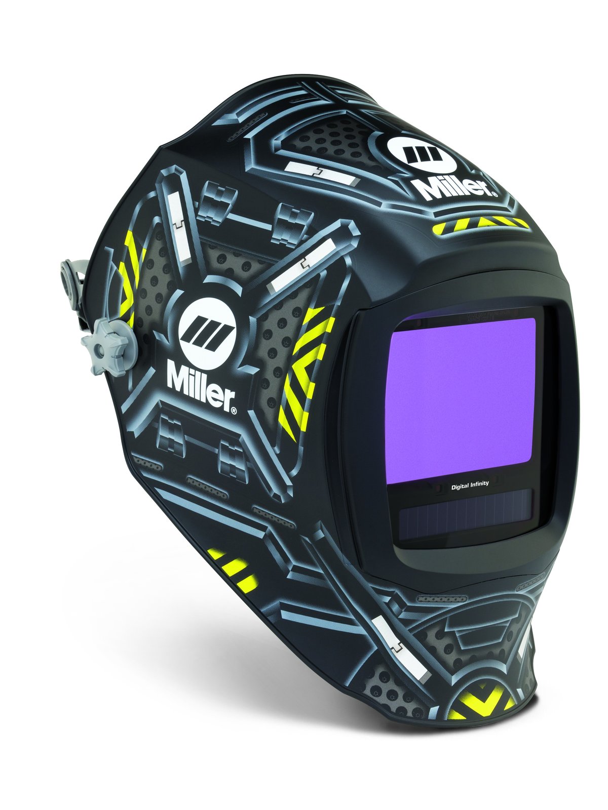

  11. powderblast Member
    Messages:
    464
    Location:
    hull
    Hi i sent the space view back they are really poor helmets, so i spoke to tom at welding supplies and i bought the miller digital infinity black ops helmet because of the x mode i think thats a really good feature one that the esab a50 did not have the a50 is the one i wanted but i think the miller is a better helmet.
  12. Richard.
    Richard. Member
    Messages:
    15,919
    Location:
    Cambridgeshire
    The miller is good I wouldn’t say it’s better than the a50. They both have there own things going on.
    The miller has a huge adf with xmode the sentinel has clearer optics and a lighter off state. The miller can be adjusted with a glove but the a50 is way better balanced and lighter on your head. I’d struggle to pick a favourite. If I was doing 8 hours a day welding it would be sentinel hands down as it’s a lot more comfortable and balanced.
