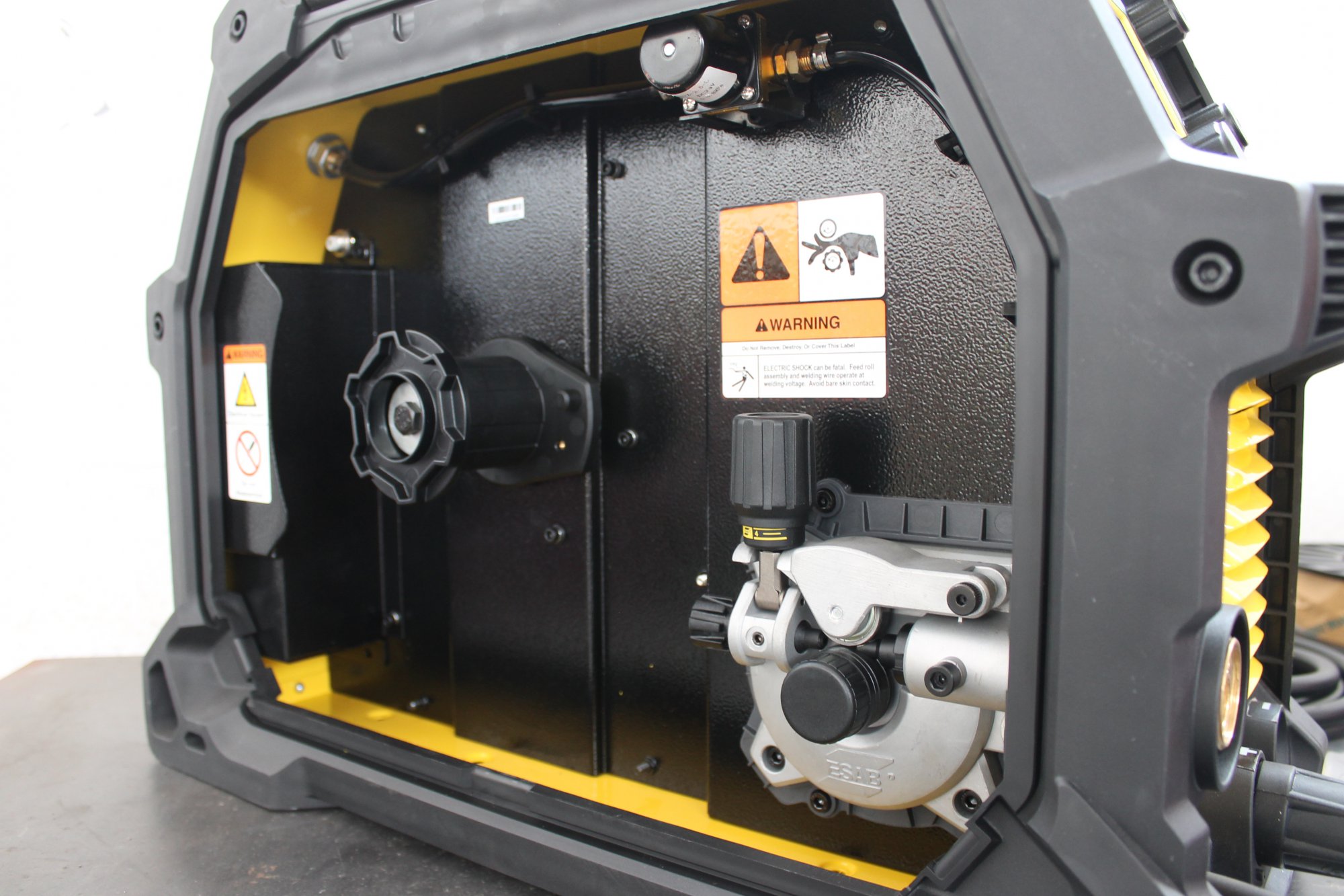

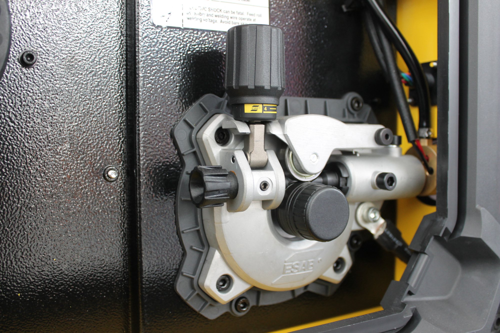

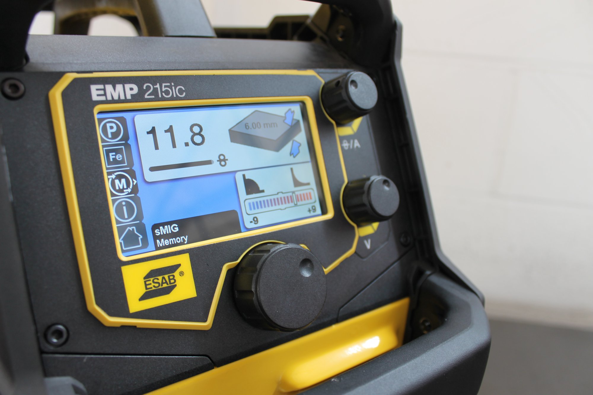

Firstly, I was pleasantly surprised by the whole set. Build quality felt very good, with the protective outer "wrapping" on pretty much the entire machine. The panel has a very simple set up, one knob for most controls and a couple of fine tube knobs to the side of the massive display.

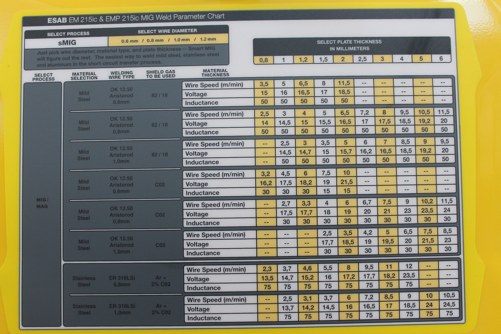

I fired her up, and wanted to give the MIG side of things a blast before all else. I'd heard good things from the sMIG feature from a few, so went straight into that. The machine prompted me for my wire diameter which was 0.8MM, I then used the larger control knob to flick through to the material type (mild steel), you then have the option to adjust inductance %, burn back time, spot on/off etc..

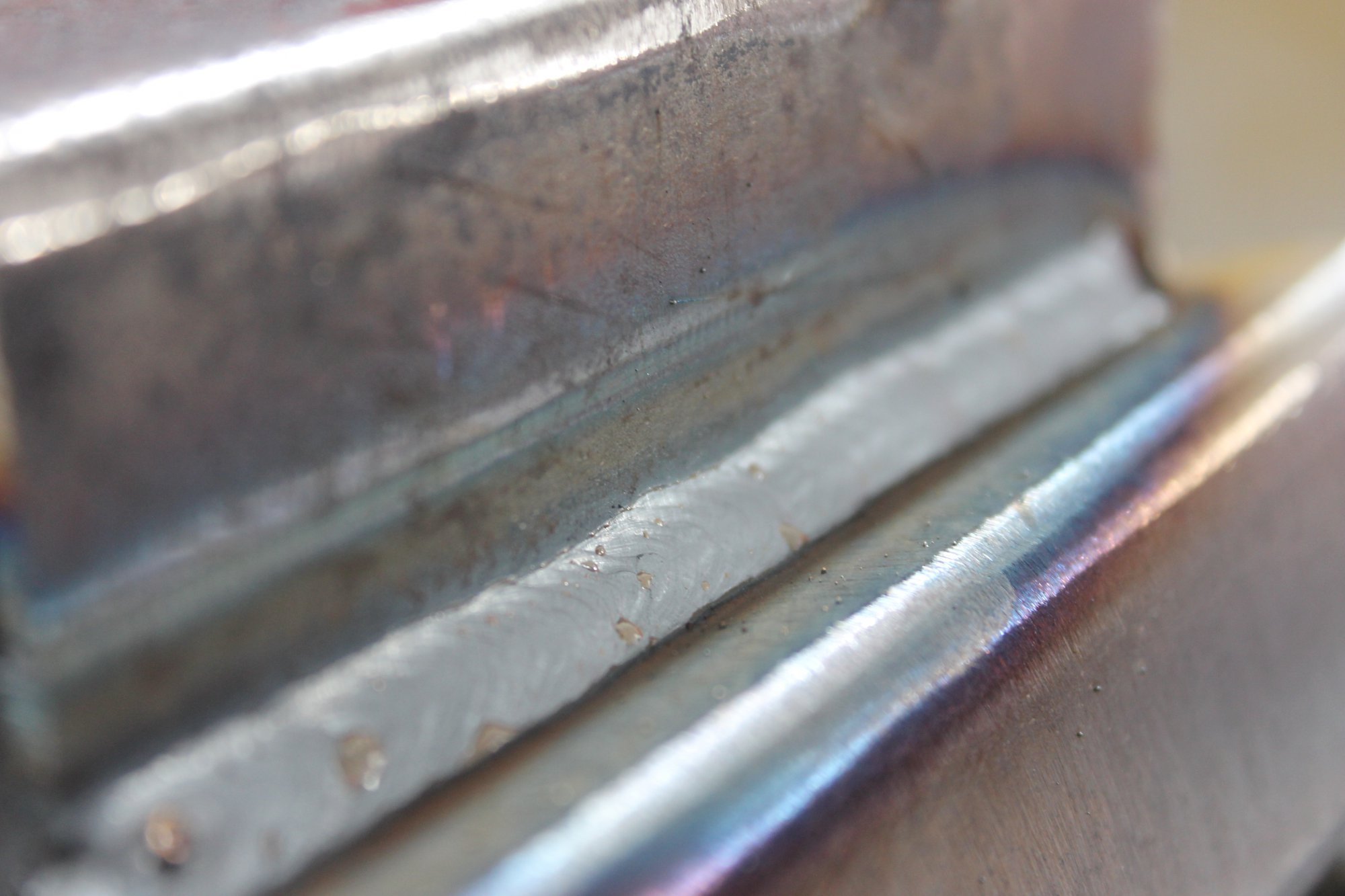

I was welding some 3MM, flat position, fillet. After getting the appropriate settings in place, I set the metal thickness by using the top right knob, I then had the luxury of using the trim (bottom right knob) to decide whether I wanted my weld to look more convex or concave. I opted more with the convex side of things and went with setting 6 (iirc) on the trim.
I laid my first weld, very nice, except I was getting a little more stick out at the end of the weld than I wanted. I played around with the burn back, setting it to 0.2s. This instantly fixed the problem and I was laying some of the best welds I've ever done. The sMIG feature seemed to have dialled in the settings to a tee (bar the slight burn back adjustment). It was such a treat to weld with.

I'll pop some pictures up below this for reference / so you can see what various parts of the machine are like.
