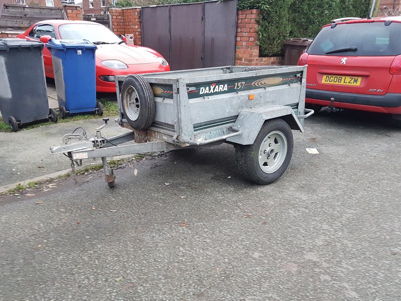

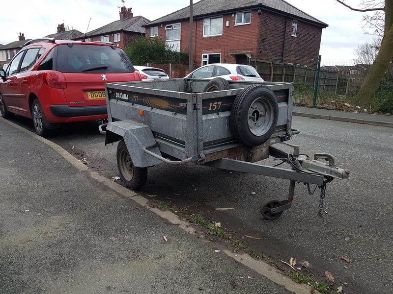

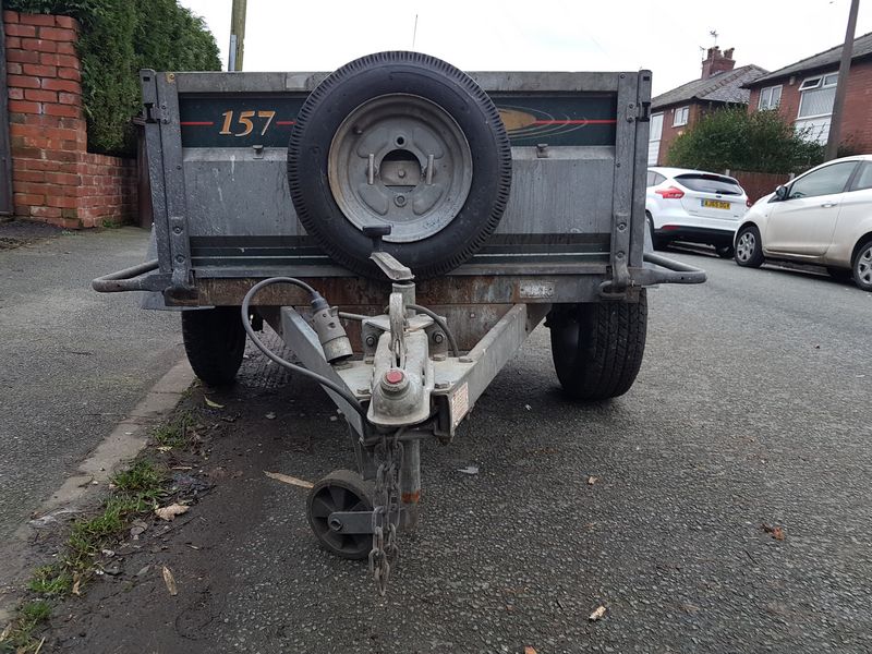

Well a reat faff about sorting new bearings out but this has been this weekends project. Not exactly finished as i need a set of spigot spacers making for the outer bearings as the ones on these trailer are different sizes due to the stepped axle.
I had these Ford Alloys for ages sitting there and couldnt sell them so as always never throw anything out .
All that was needed for this was a set of hubs at 4 x 108 for a 1 inch axle a new set of outer bearings as the hubs come with 25.4 bearings inner and outer.
The off set on these wheels need a set of wheel spacers or 25mm as well though.
Also the hubs needed to be drill out for the M12x1.5 studs i had lying around, they come with wheel bolts. they needed to be drilled out to 13mm, maybe 12.5 would of been better though as the knurl did slip on a few.
So as said i am waiting for a chap to get back tp me about making some SS spigot bearings to take the outer bearings.
Hope it can sort it for me soon.
Look sweet now, trailer bling dont like the 8 inch wheels it had.
