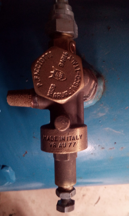

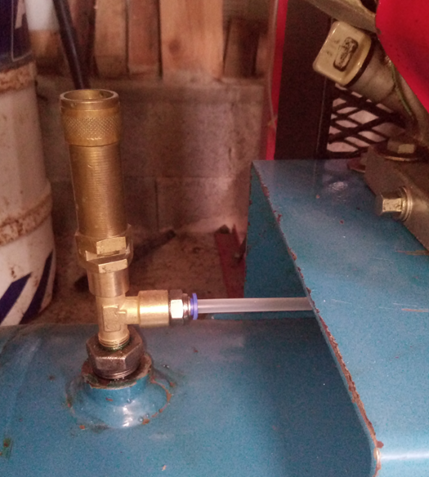

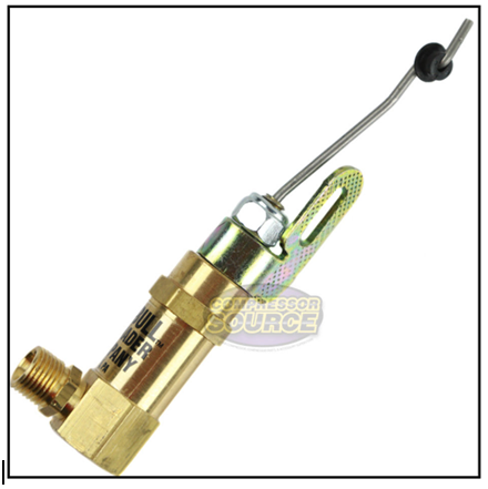

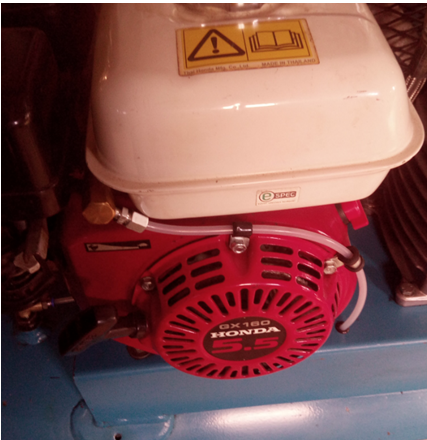

    Yep, the compressor head on mine is the equivalent of a 3hp electric in terms of air delivery but uses the 5.5hp petrol honda...
    For mechanical pressure control, as above you'll need some form of unloader, but all that does is dump the air pressure at the set point, the engine will continue to run at whatever speed it's set to. To reduce (control) the engine speed you need throttle control as well. My petrol engined compressor was a lash up of bits to kind of make it work when I got it. To make it usable, I stripped and cleaned the unloader valve which was blocked totally and not dumping at all. That done, it worked, but the engine was still running at higher revs all the time, so I bought a pneumatic throttle control valve off ebay. Think it was around thirty quid including delivery from across the pond. Piped it up to suit, now the pressure ramps up to 8 bar, and the unloader dumps the surplus air, and the pneumatic actuor pushes the throttle arm down to low idle speed, and conversly ramps up on demand when the air pressure drops. Works fine.
    Only problem I had was initially I connected the throttle actuator to the unloader port directly, but when it started dumping the volume of air the pressure at the point of connection dropped slightly. Dropped enough to "fool" the actuator into thinking it was calling for more air, so it ramped the engine up to full speed again, basically defeating the purpose of the actuator, obviously that was no good.... I plugged the unloader port off and put a tee under the PSV at the other end of the tank. There the pressure was stable whether or not the unloader dumped so the engine reduced speed accordingly.
    Agreed, connecting under the PSV isn't the pefect solution, but everything connected to it is rated over the PSV rating so if I ever get to the point where the PSV lifts, all the connected bits are still over rated to be on the safe side...
