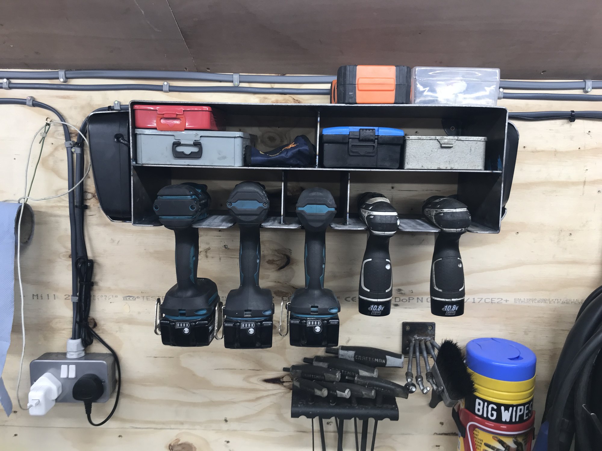

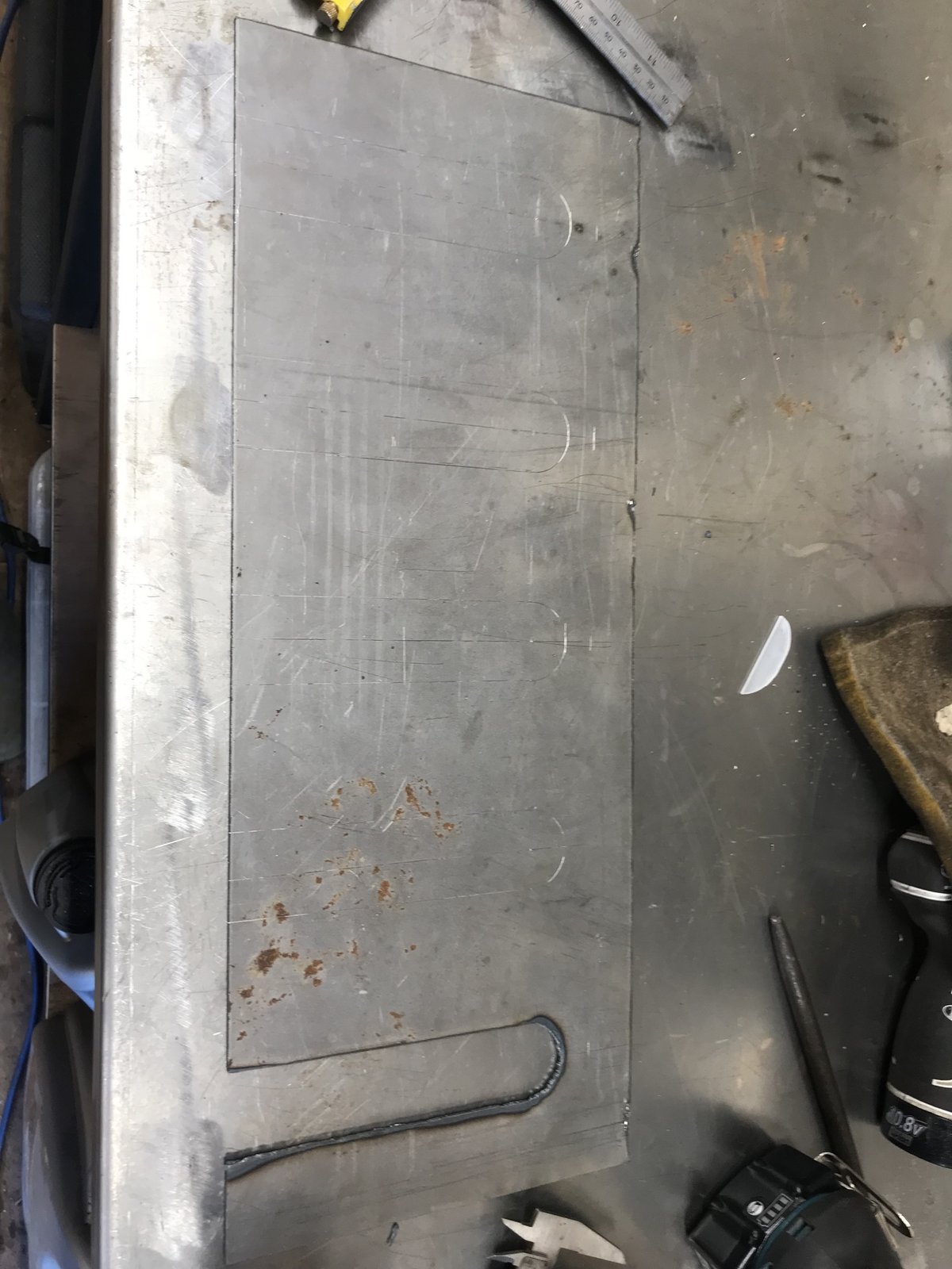

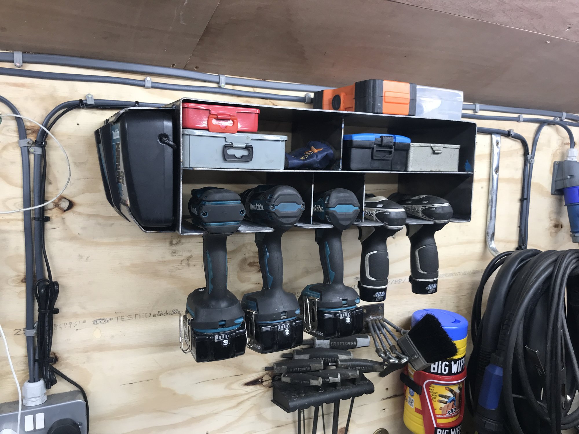

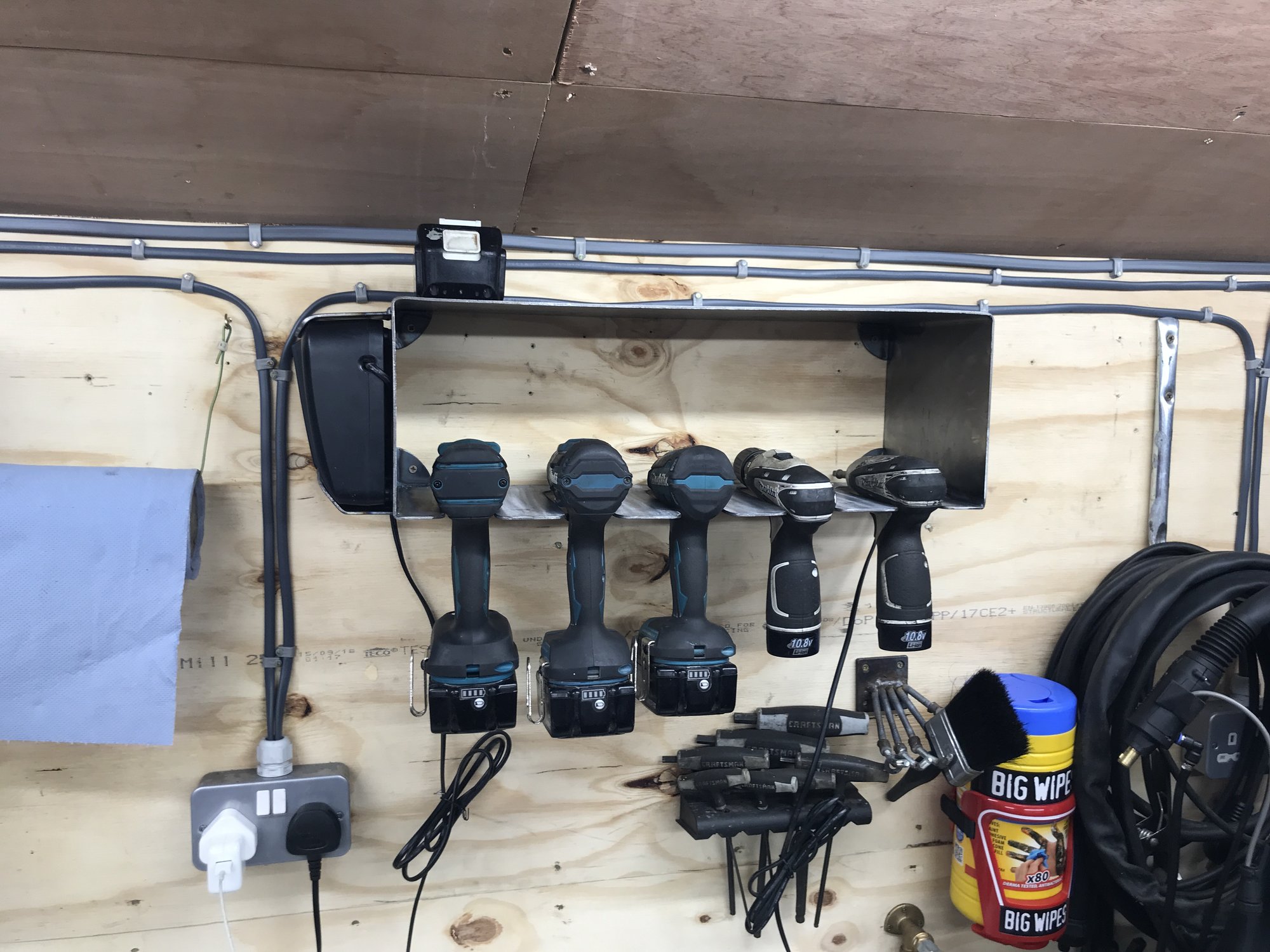

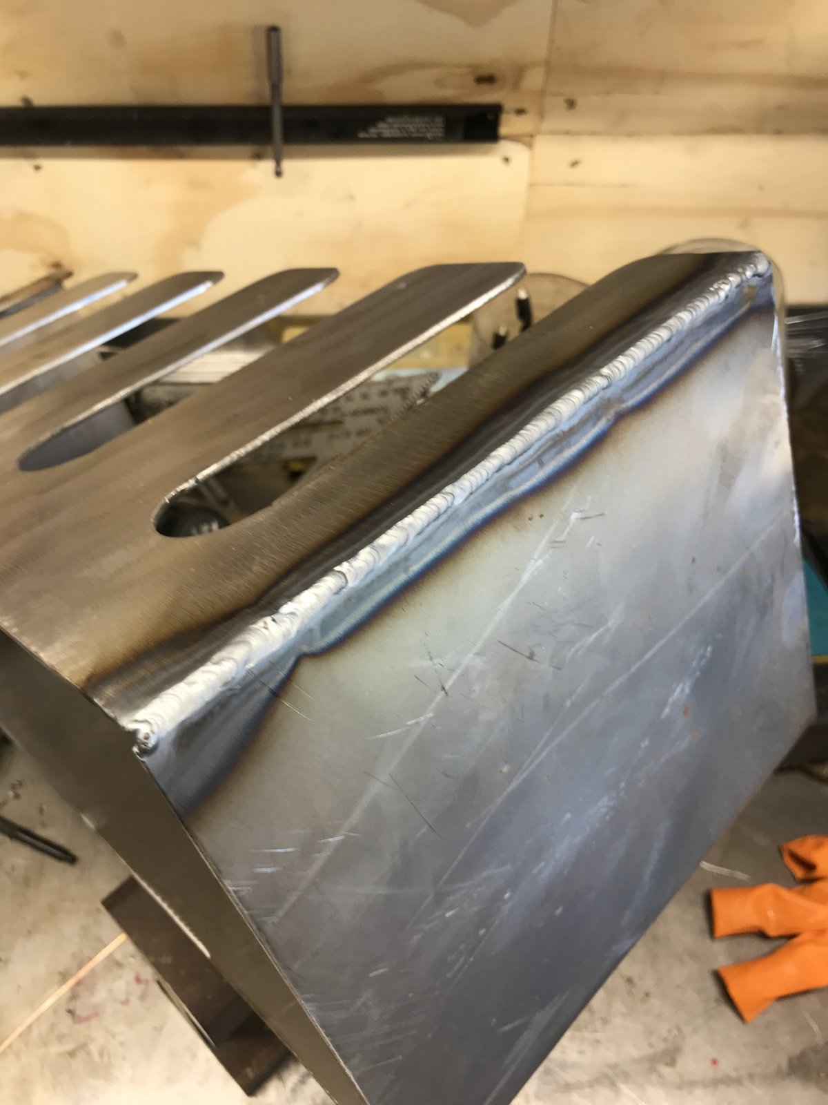

Some of you may have seen similar things, I normally see them made out of wood. I was going to do that but I burnt the left overs I had for some reason. Anyway, I decided to make it out of steel that I had. 3mm steel left over from my bench

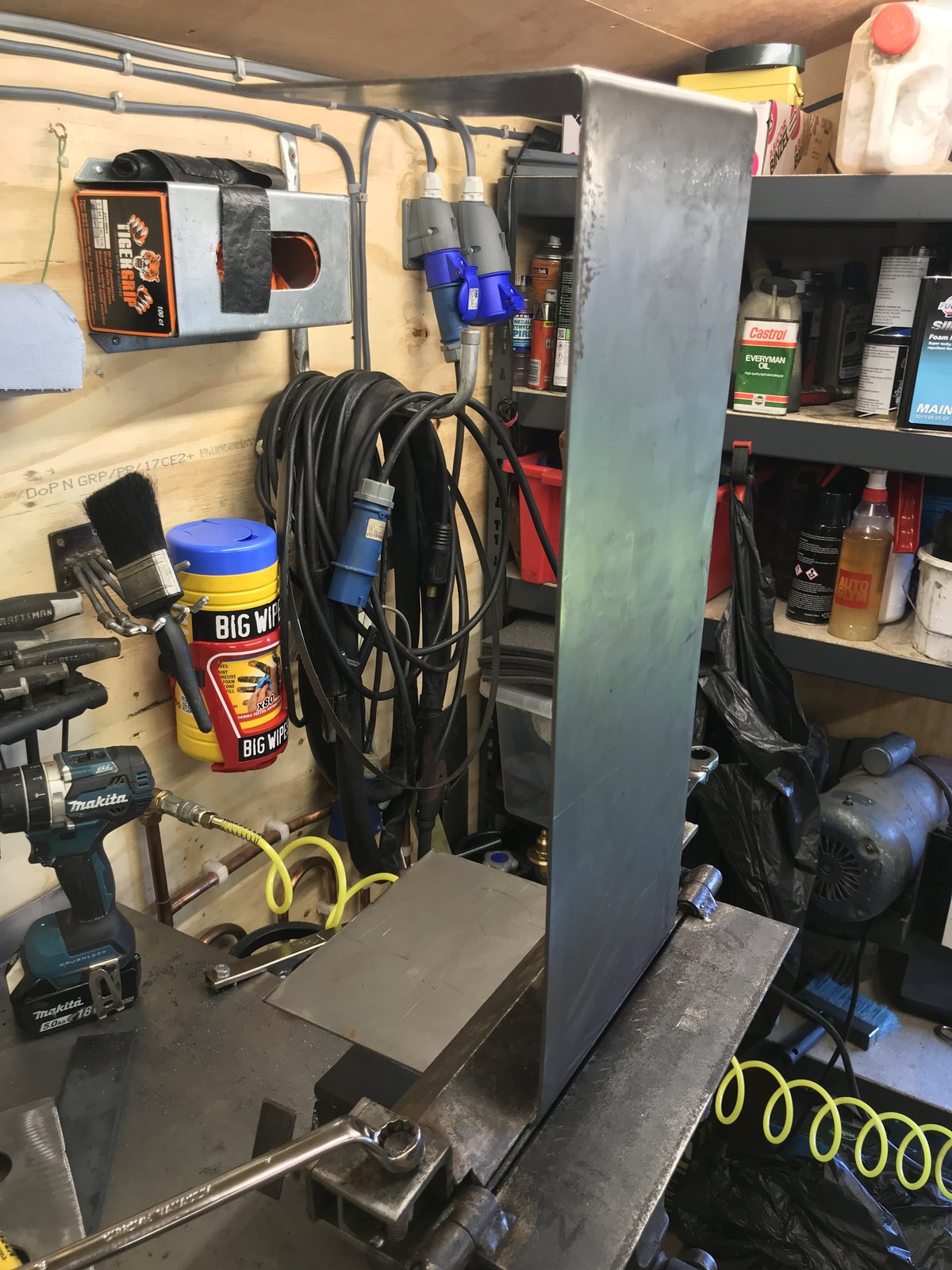

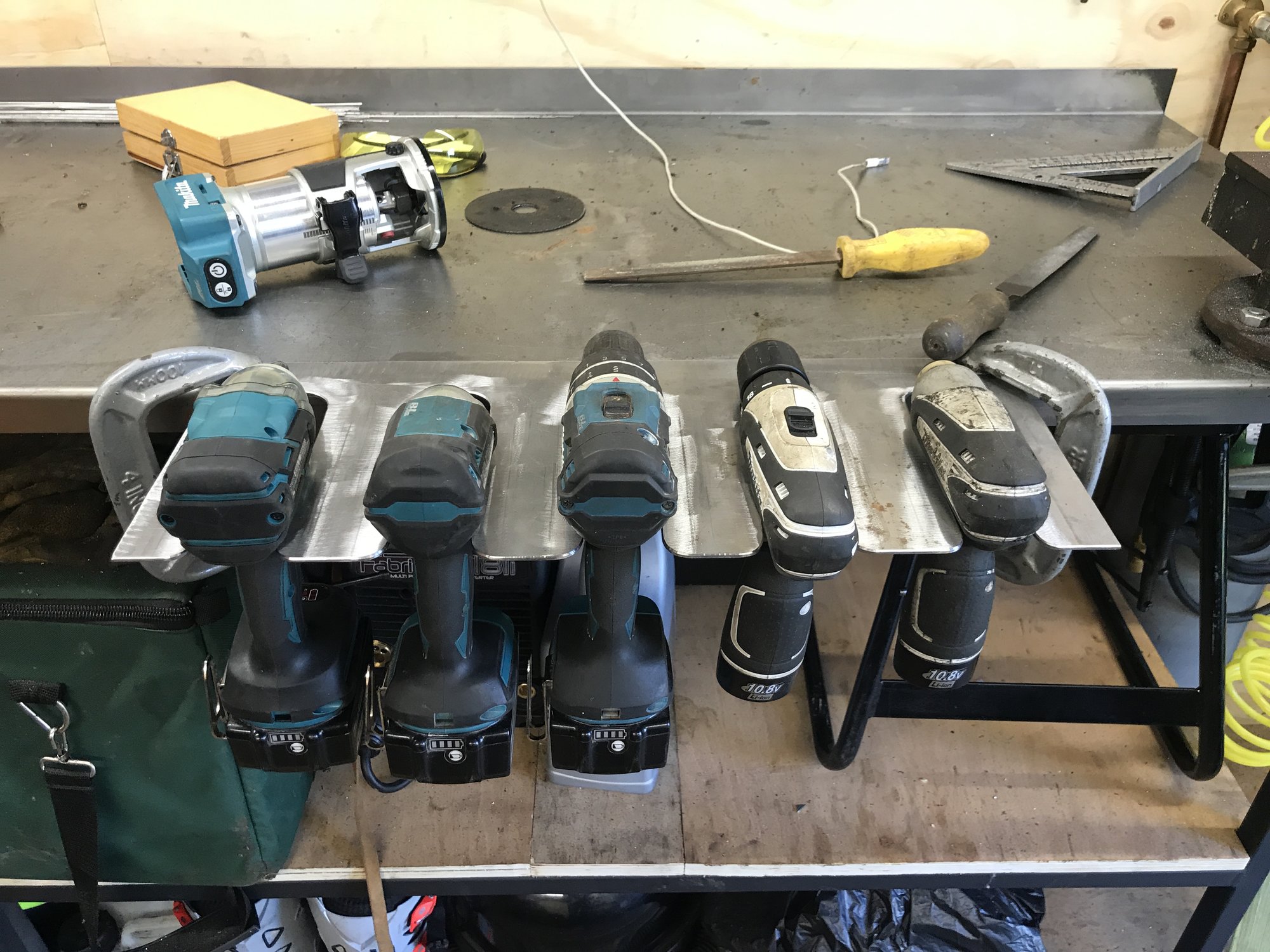

started by working out a rough size that would fit all my drill. Then plasma cut it out. Filed and ground it to size.

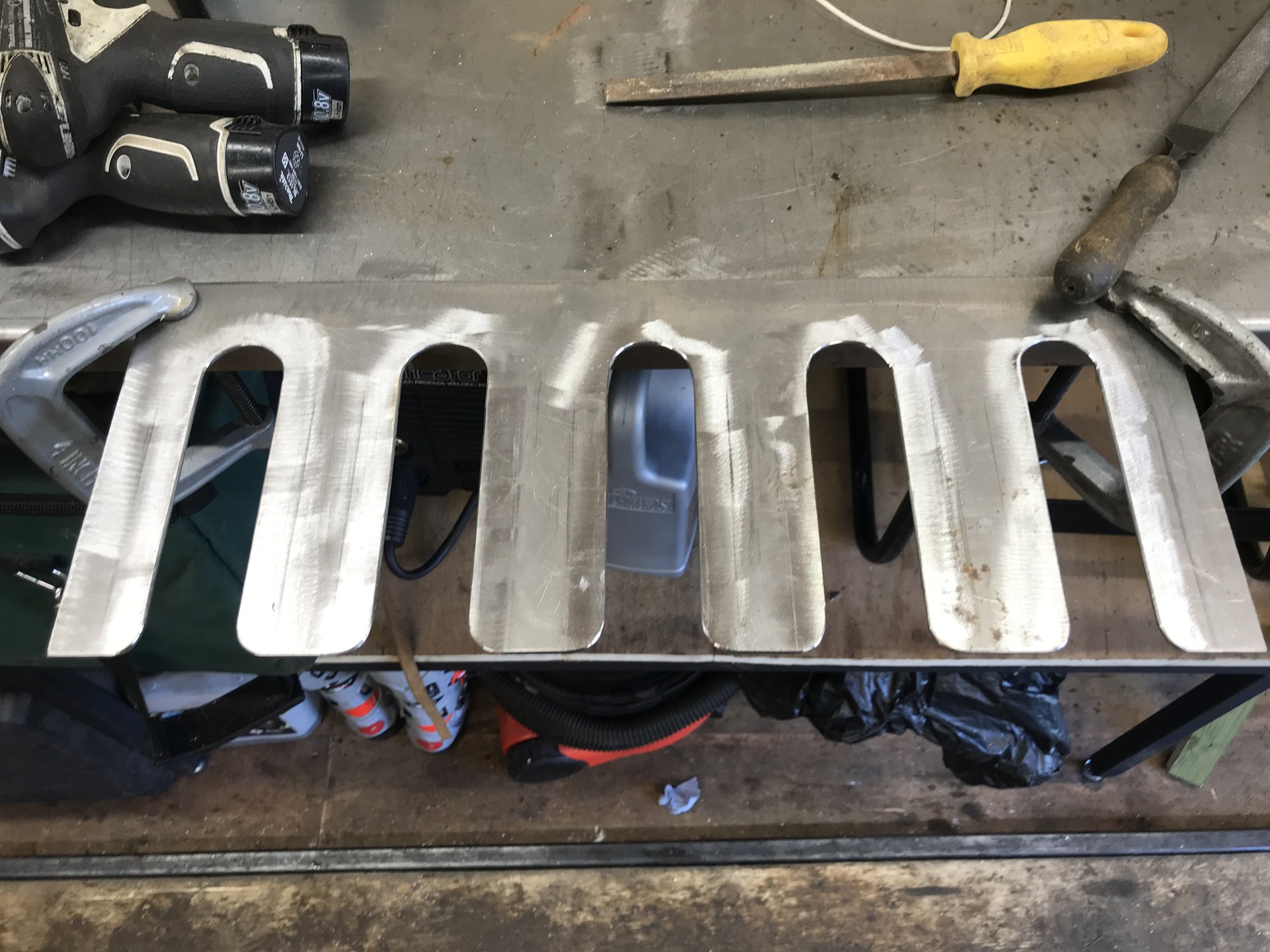

Then cut out the top part. I made sure to keep cut the sizes so they can accommodate the chargers. As can be seen further on.

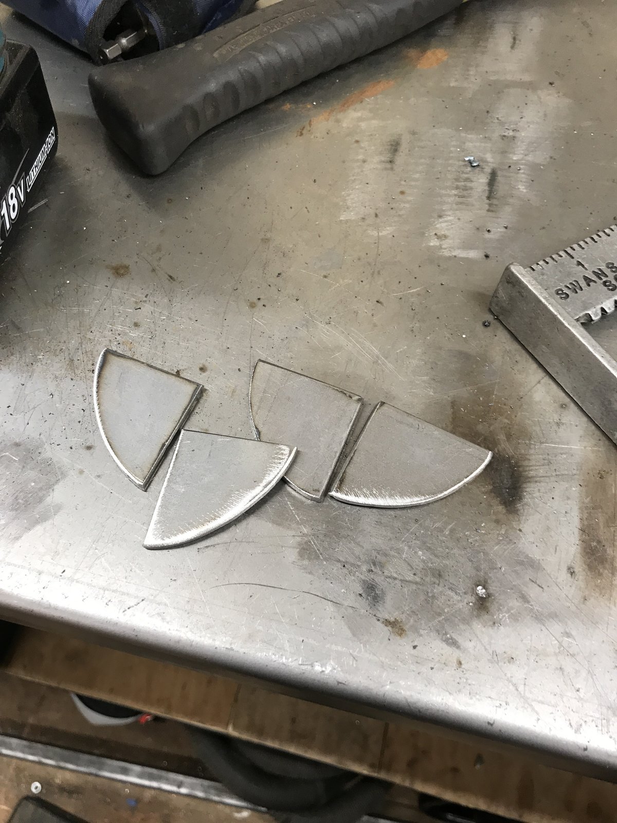

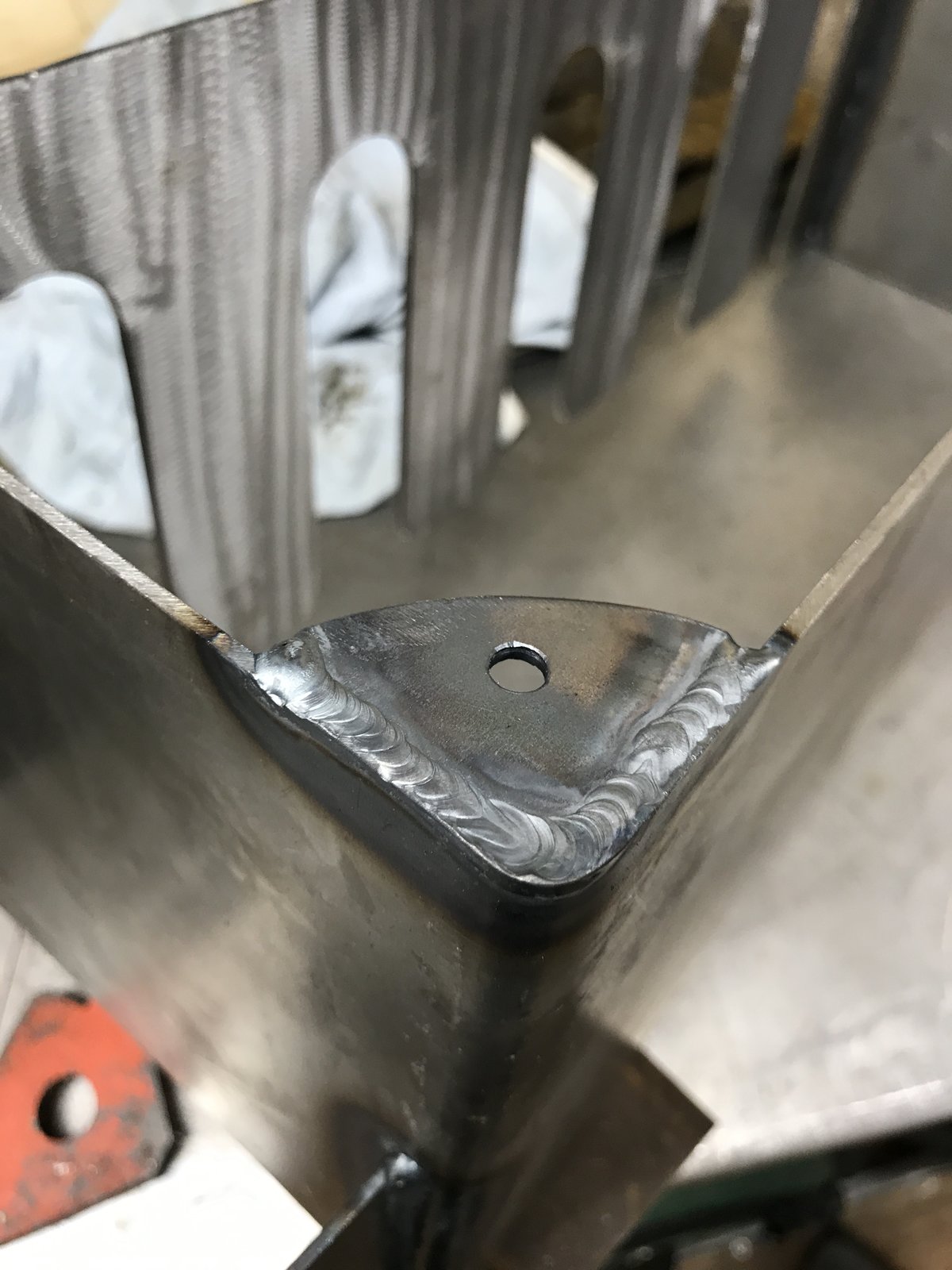

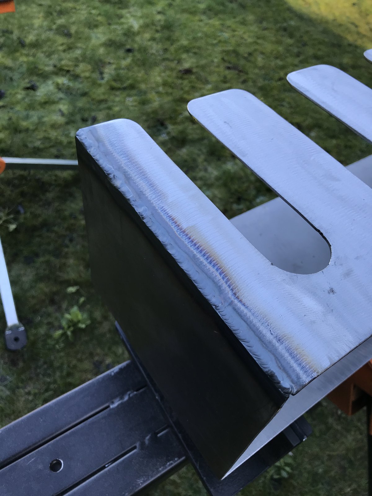

My tig welding is going a bit backwards but it’s super hard with no seat.

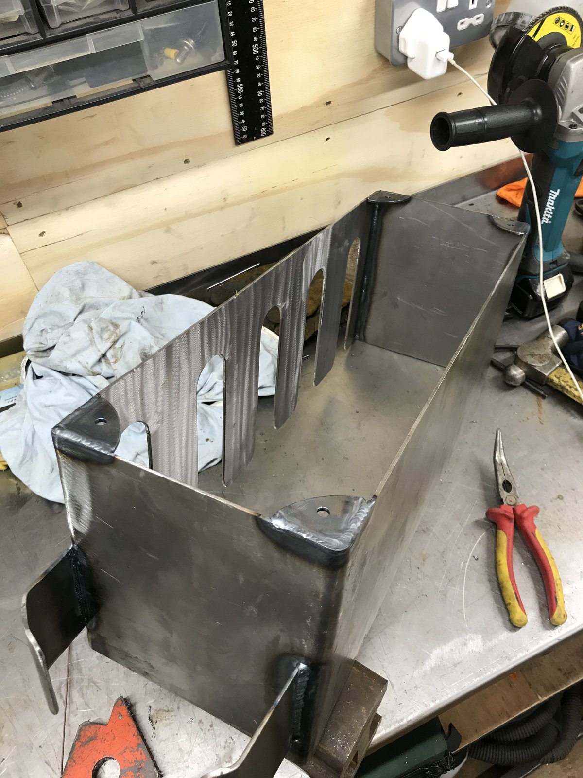

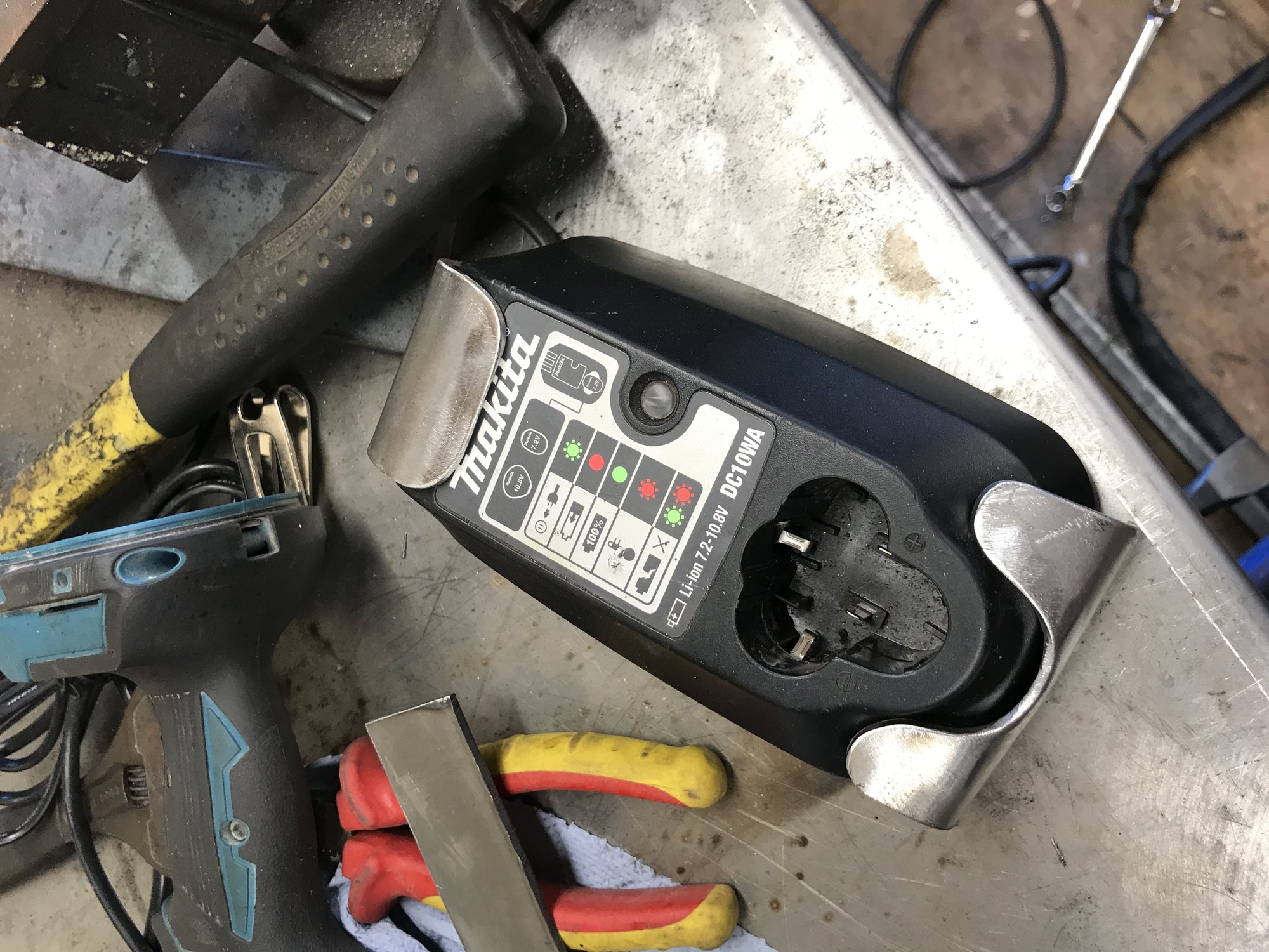

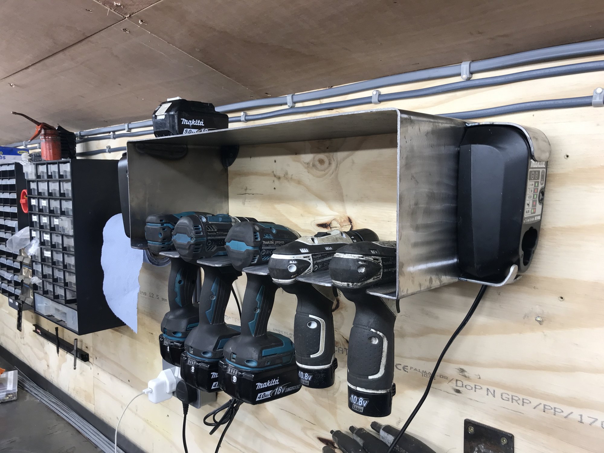

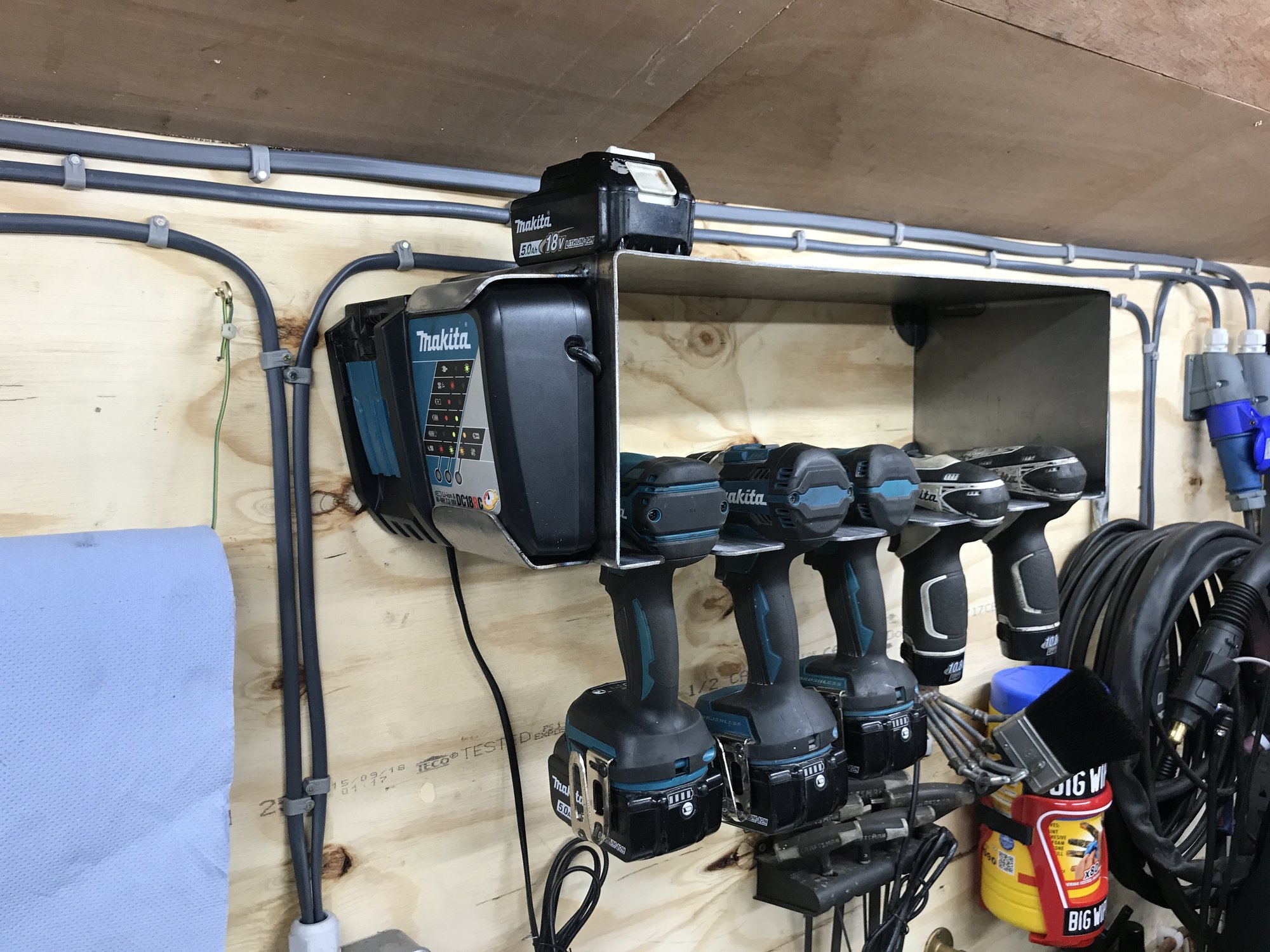

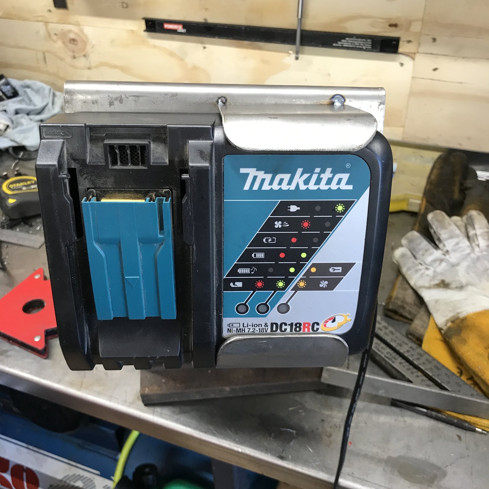

First of the chargers. I wanted to make them so the wall retains them in place. I didn’t want to start fixing things permantly.

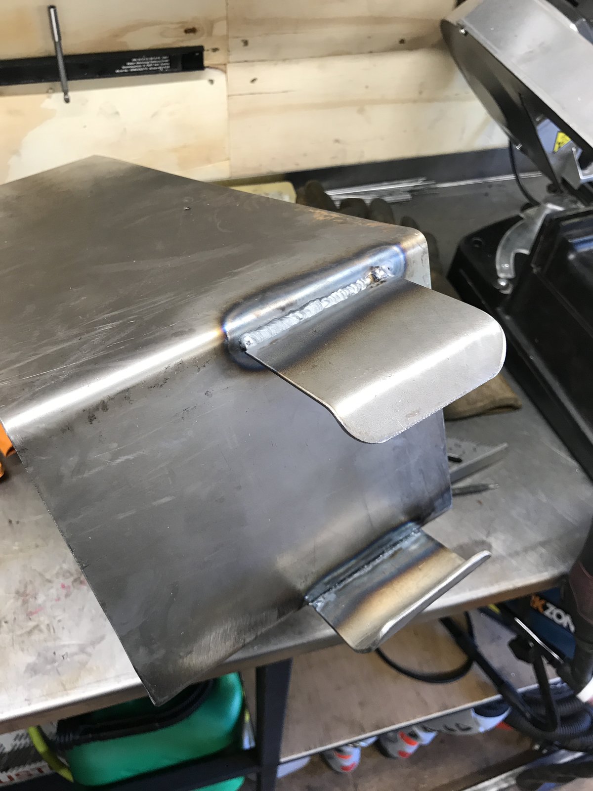

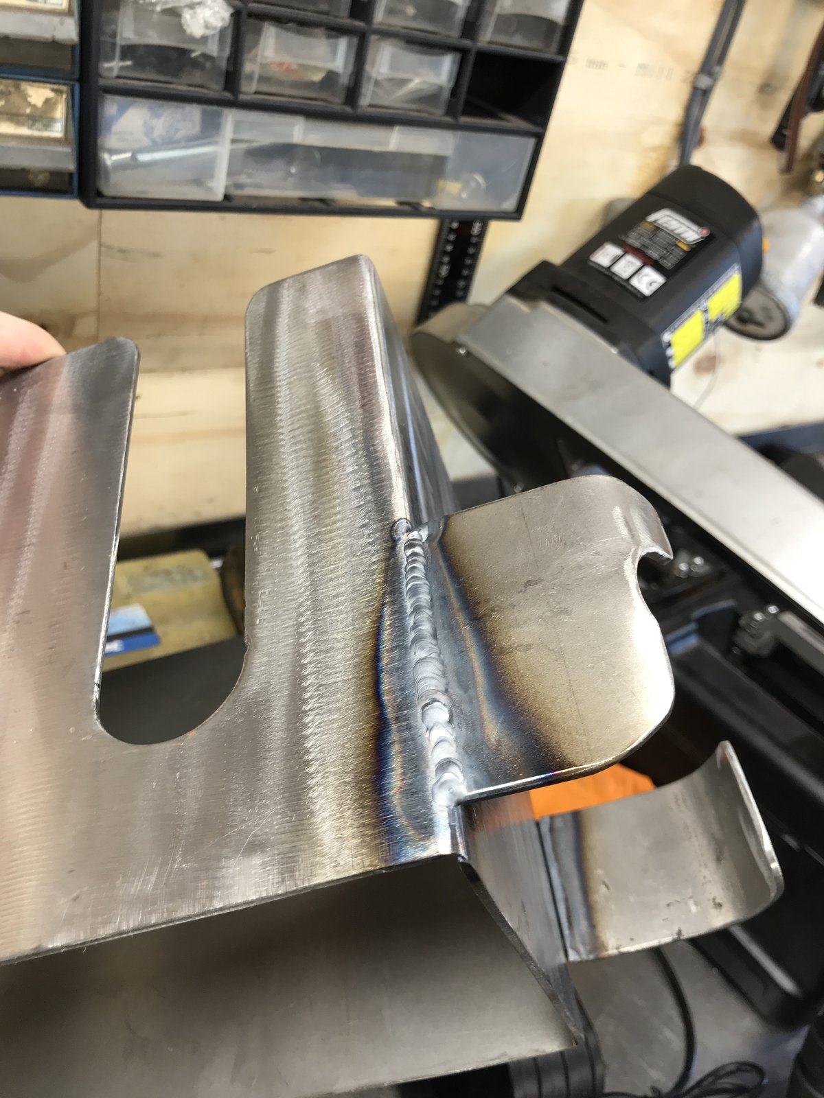

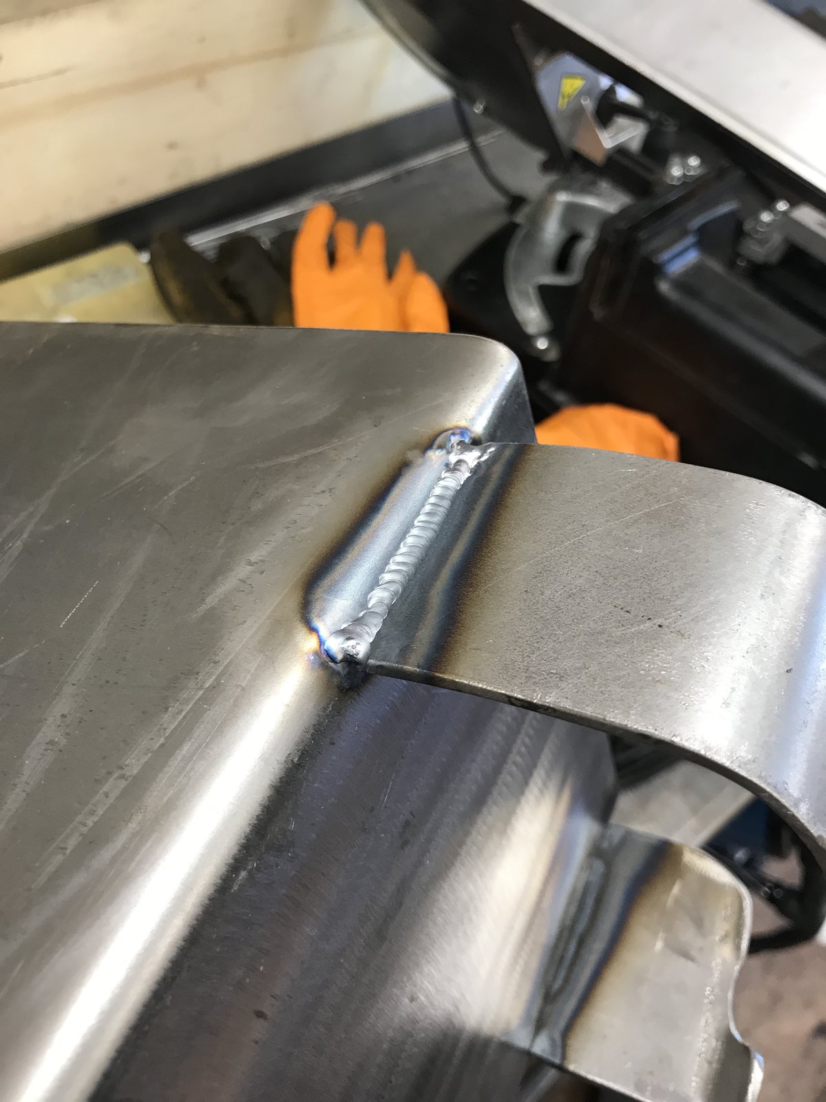

Start of the second charger. At this point I realised the two little tabs (on the bottom of the charger retaining plate) couldn’t both stays it was impossible to get the charger in the gab. I Cut one off and welded it on
