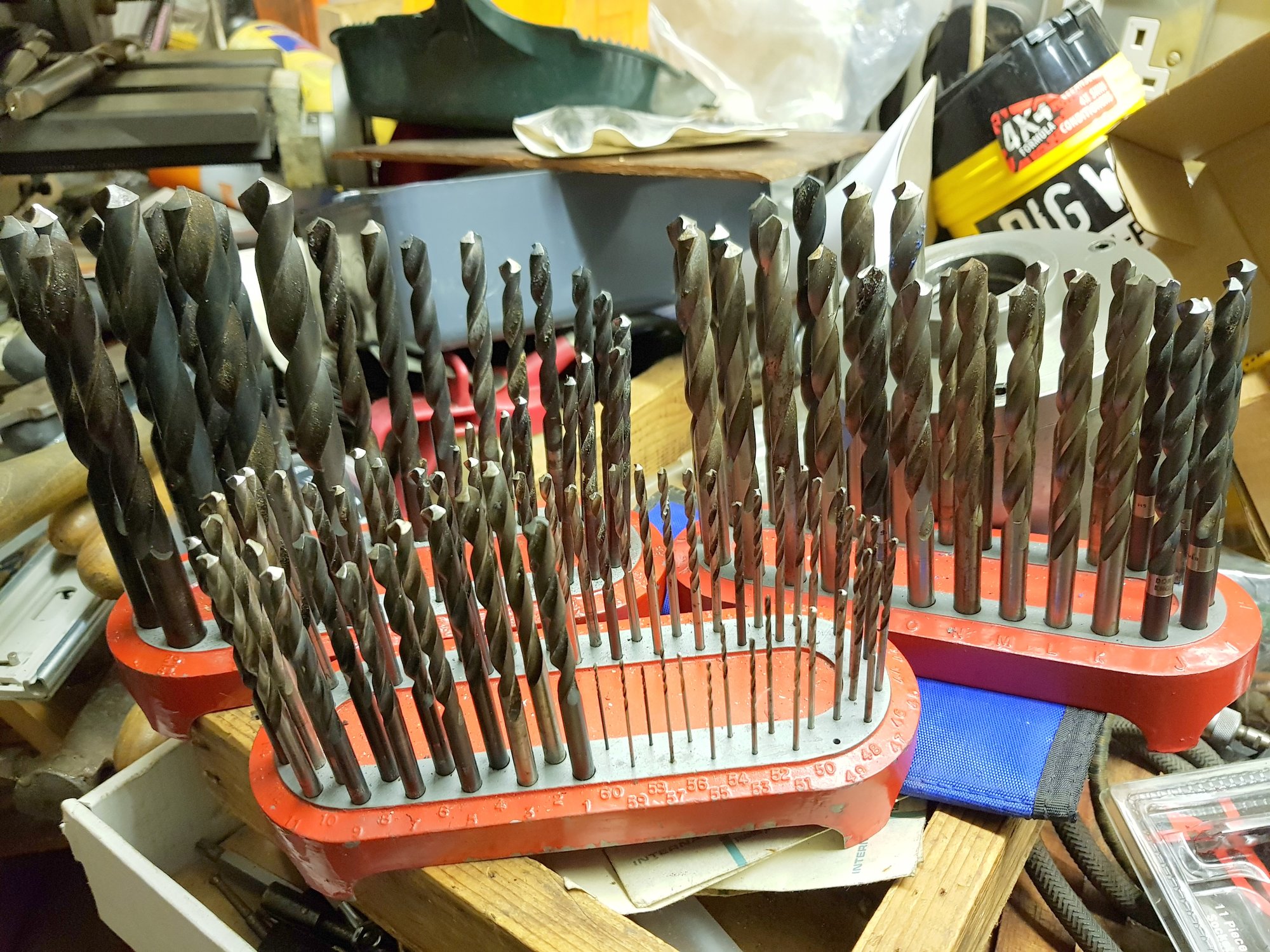

I got hold of a set of both number and letter drills by asking the bloke who had bought them in a lot at auction, if he had bought the lot for them or the books,he didn't even know they were there and he accepted my offer of a fiver
