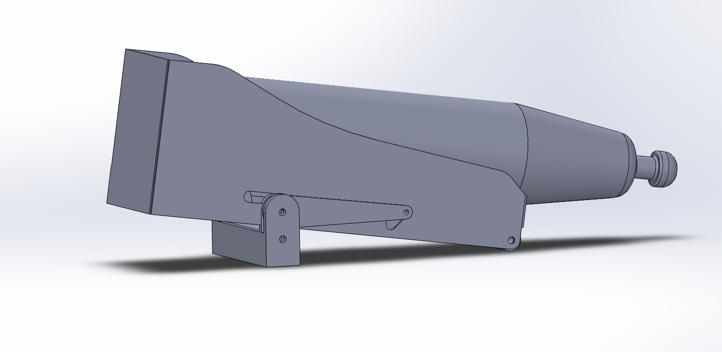

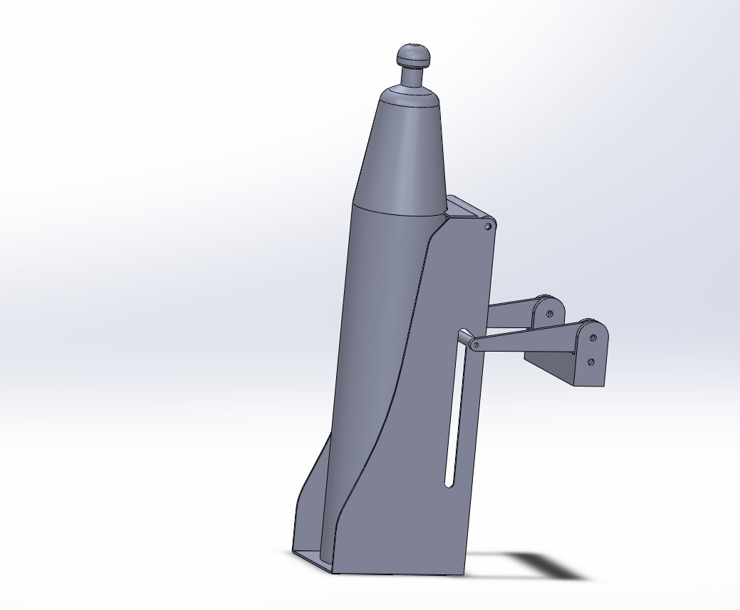

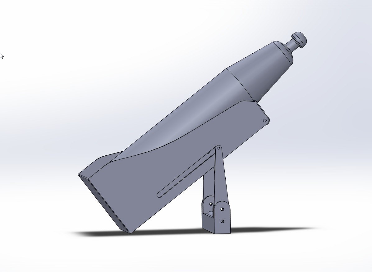

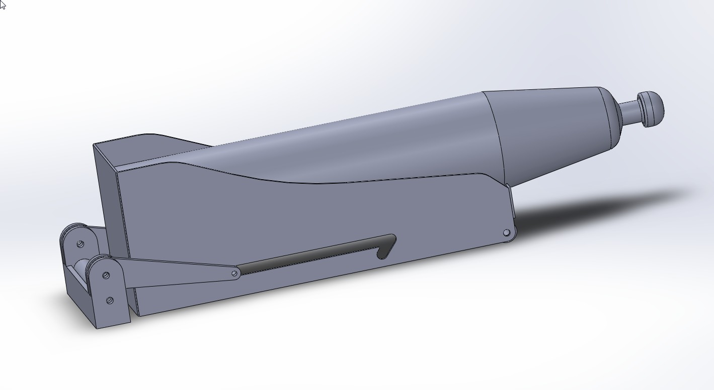

I was up getting another cylinder of Argon yesterday and I struggled a bit to get it in the car. They are around 60Kg so not massively heavy and most times it is not too bad but the cylinder was damp yesterday and as the bottom is rounded it was not the easiest to grip. Add to that that I am not getting any younger and my knees are not getting any better so I thought I would see if I could come up with something to help me.
Here is what I have so far. There is a roller in the middle of the hinge bracket, one on the end of the cylinder holder and there is a roller on the end of the hinges that goes through the slot in the cylinder holder.
There will be securing straps and probably a better design of the cylinder holder to make it more secure but I will have to measure the cylinder first before I can properly design that. There will be a handle of some sort on the lower end of the cylinder holder as well.
When the hinge arms are going from horizontal to the vertical position the cylinder holder will be resting on the bumper of the car (suitable cover plate clipped in place) so I should be able to control things as it rotates more.
Does it look like it will work? My only concern is as the arms go past vertical will it want to slam down or will I manage to hold it? I think I should manage as the centre of gravity should be rearward but..
