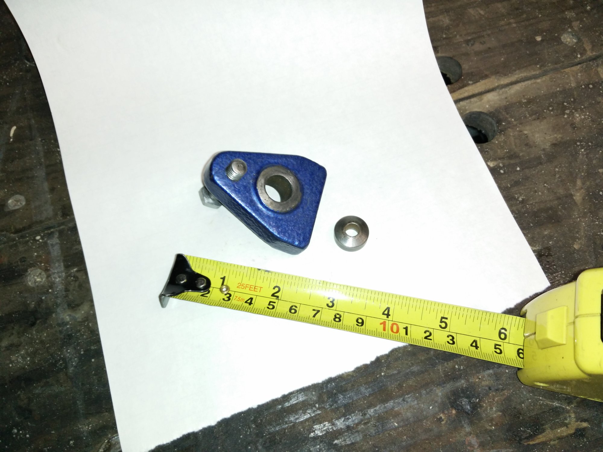

    @Noods Nice one(s) :thumbup: The 'adjust-ability' is [very loosely] similar in principle to the original tool holder on a Myford. I sold one on eBay recently.

    My that’s a bit special, and nice... x

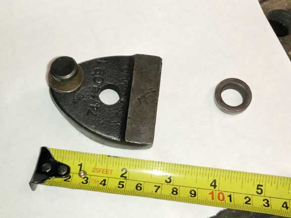

    That's a Google pic just to show the design, here's the one I sold
    I still have one which came with my first lathe, (an R & A) but it didn't find a buyer. The word 'Myford' seems to almost guarantee a sale on bits.

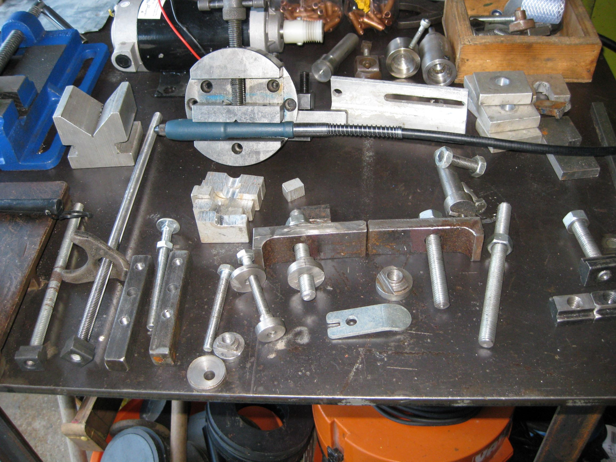

    I thought you'd like a look at some of my homemade bits & bob I've needed to do " stuff" on my lathe and on my workbench this last four years .
    The diesel injector clamp is on the long stainless steel threaded rod to the right of the 4" vice set in the bench top .
    That vice is circa 1964 & made in Japan . It's bolted to a Roman shaped capital T platform that drops into a precision slit I cut in the 10 mm cold rolled steel bench top .
    The lower end of the T is clamped to the bench leg with a 15 mm through bolt that runs into a captive thread welded on the back of the bench leg. That means I can take it off the bench in a few seconds and attach it to the platform of my circa 1960 Black & Decker workmate for when I want a vice away from my man cupboard .( ambiguous or what ? :laughing: ) .
    Another useful device is the 4 " dia vice that I have mounted on a length 16 mm key steel bar after I saw a YouTube clip on here showing how to do it ..I modified the idea slightly. So it can sit well below the chuck center line using the height adjusters on the tool holder , done so I can use the vice in a tool holder as a vertical milling clamp with a vertical travel of 3/4 " or so in total and forward & backwards movement of the cross slide to allow a little milling of things . It did a nice 5 mm key way on a 20 mild steel bar using a surplus 1/4 " shafted 6 mm parallel wood working TCT cutter.
    There is also the cartridge release lever from a wrecked caulking gun .. it made a great low profile plate clamp for when I was trepanning a 75 mm hole in some 1.5 mm alu using my drill press.
    Close to that are two square bars . these are fantastic for using to clamp things on the lathe face plate To the right of these are two strange off centre disc's and some special cut round nuts that run in the face plate slots . Again these are for holding things to the face plate , being off centre it's not often I can't make a quick secure clamp up .
    That Dremel in the round vice on the tool holder . it's not much use save for indexed small drillings into round bar in the lathe chuck . I tried to get a precision finish on a bar end but the Dremel is neither man or fast enough. The 90 volt dc motor of an old surplus exercise machine is for a project that should take over from the Dremel as it can get some sensible RPM and have a lot of torque . Again I hope to make the drive using a flexi drive (Old truck speedo perhaps if they are still available ) of some sorts rather than a direct or belted drive as it will allow the motor to be fixed to the tailstock end of the lathe out the way .

    Feast your eyes on it lads , it's a rare event ….me getting a piccy on the threads ..
