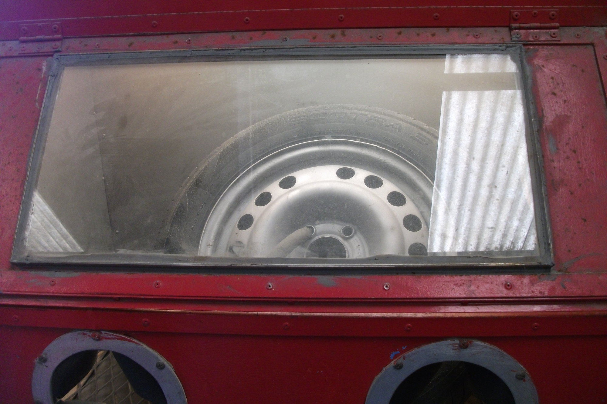

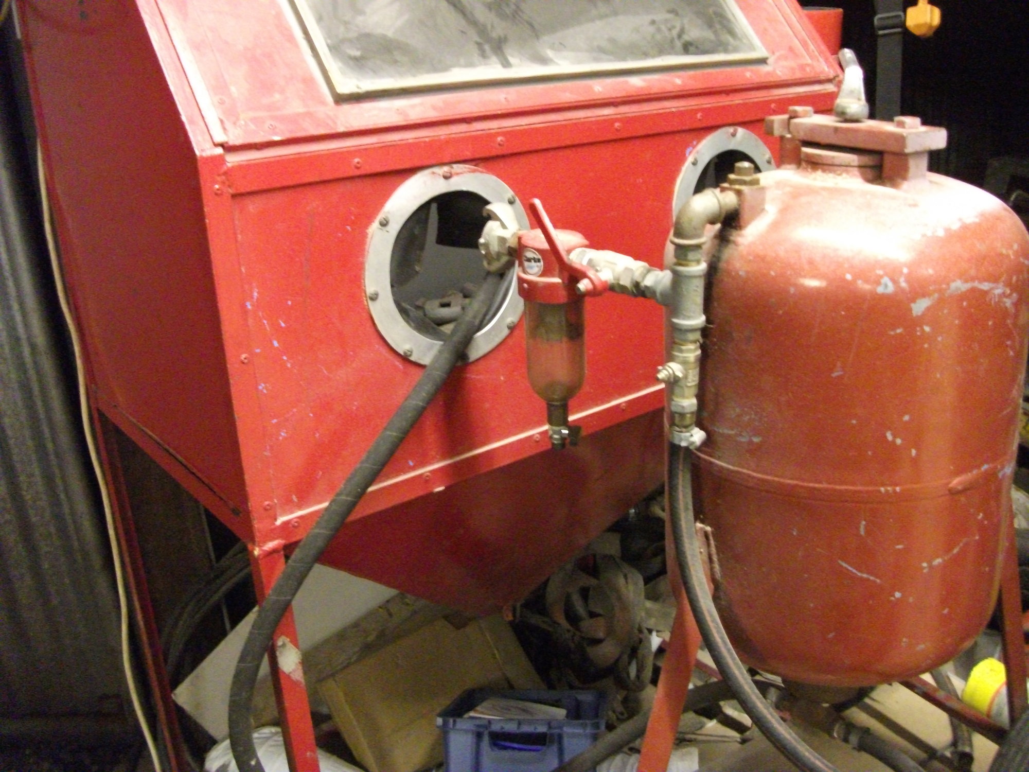

    build a cabinet big enough to take a car wheel get a decent extracta for it . I use a 4inch woodchip unit on mine ithas a suction gun inside and I also use the pressure pot with blast hose poked through the glove hole. il take some picture later and post

    Agree with @brightspark post.
    Your compressor is small for blasting but if you have the time to wait or are only doing small parts it will be fine.
    The pressure pot will be a huge improvement on a suction feed so even if you buy a cabinet it is well worth converting to a pressure pot. However the pressure pot will need a few mods before it will work really well (although still far better than a suction set up)
    I made a DIY cabinet out of an old galv water tank and while it worked it was more work than it was worth.
    Second hand cabinets come up for not a lot of money (been a few in the for sale section recently) and it might be a better way to go unless you need a particularly big one or just want to go DIY for the hell of it.
