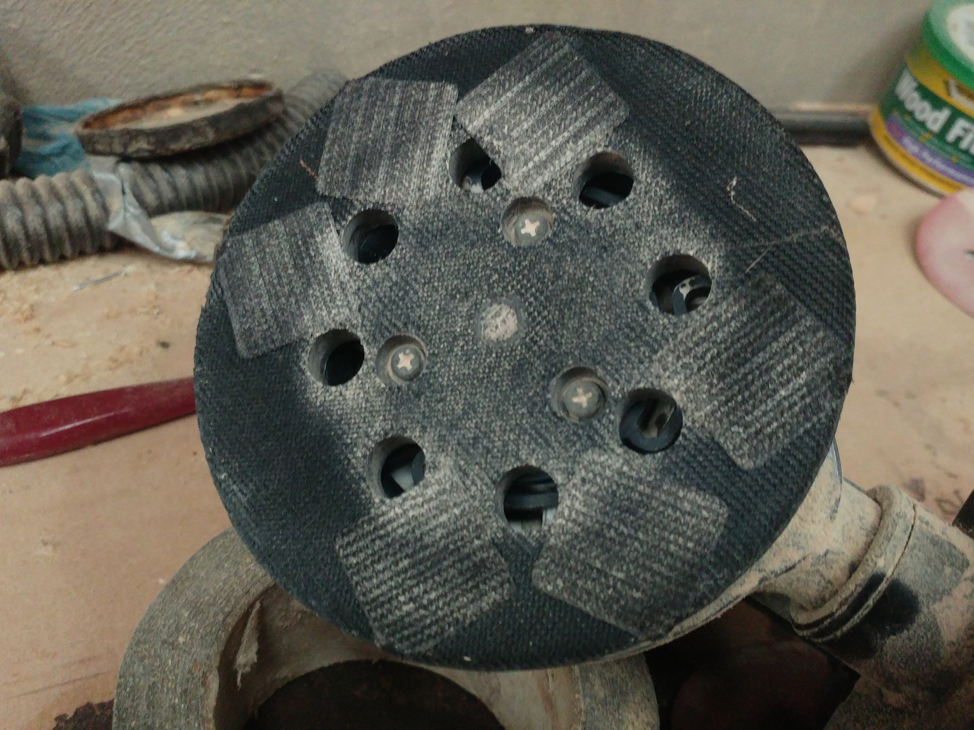

    Ive got a lovely Makita Sander but its going through Velcro Backing Pads at an annoying rate and replacements are about £25 a time.....anyone got any tips on rejuvenating the velcro

    Use a belt sander for heavy sanding.use the orbital for finishing.
    Applying too much pressure to aid removal of material kills them quicker than anything.
    What model btw.
    All seem to be foam rather than rubber between the metal disk and the Velcro surface.

    I bought some self adhesive small round velcro tabs from the local sewing shop.
    Work perfectly

    What about these? https://www.axminster.co.uk/mirka-disc-pad-savers-ax851925 I use them on my Makita sander and have not had to replace the backing pad only the saver. I think modern velcro used on tools does not stand up to the heat build up from sanding. This comes from my experience using my multitool. Put on of these on that and the backing pads last much longer.

    This has worked a treat for about a year of abuse. Saved thirty quid.

    My thought is you want Flat surface for the disc to sit on, not one with bumps on
