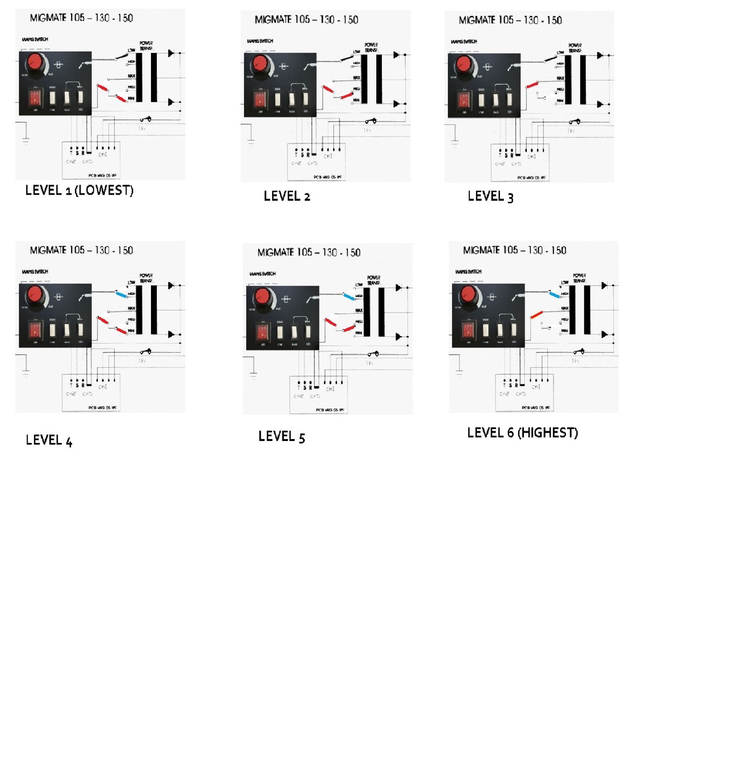

Migmate 130 has got three separated switches, so te current depends on their combinations.
According to the circuit diagram and my quesses, this is 8 levels of power?
From the lef side:
1 level - LOWEST current= LOW+MED+MIN
2 level = LOW+MED+MED
3 level = LOW+MAX+MIN
4 level = LOW+MAX+MED
5 level = HIGH+MED+MIN
6 level = HIGH+MED+MED
7 level = HIGH+MAX+MIN
8 level - HIGHEST current = HIGH+MAX+MED
are my guesses correct? am I right?
