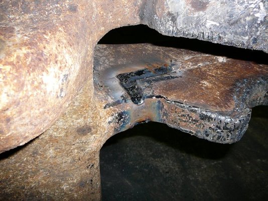

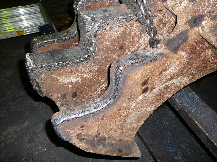

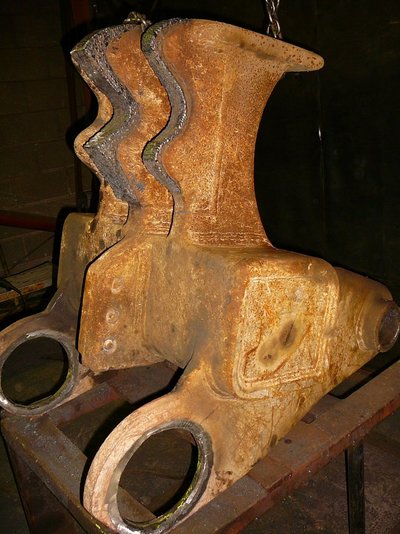

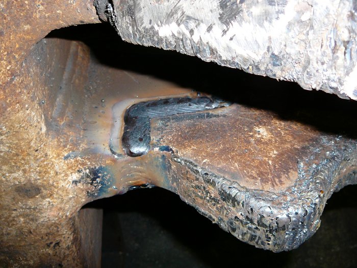

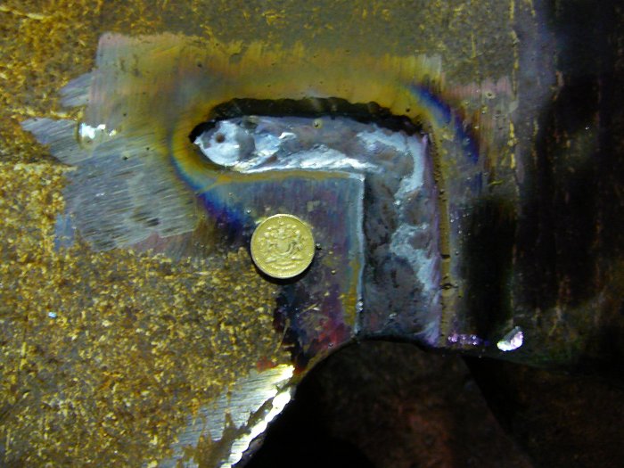

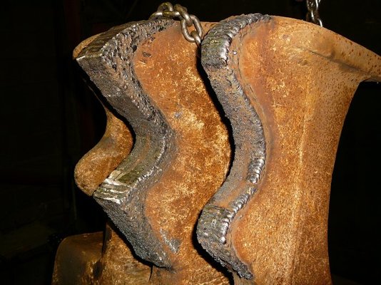

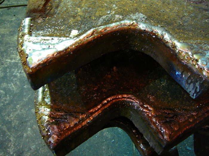

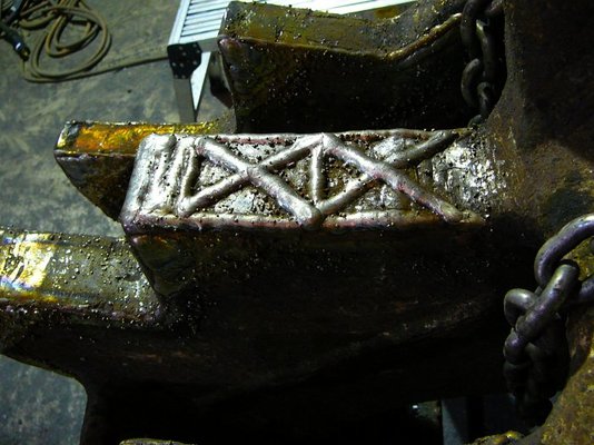

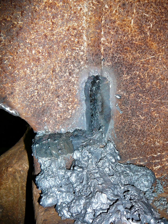

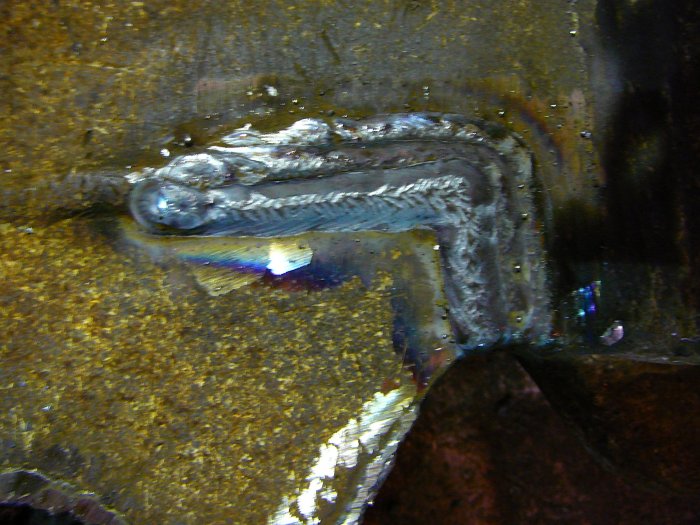

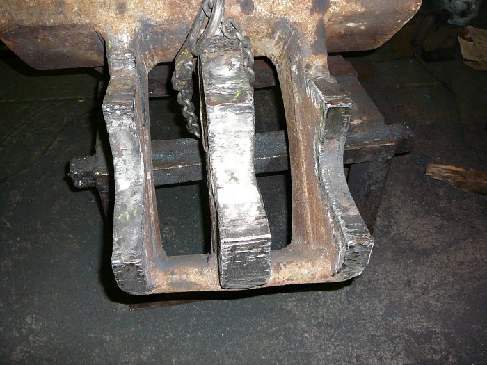

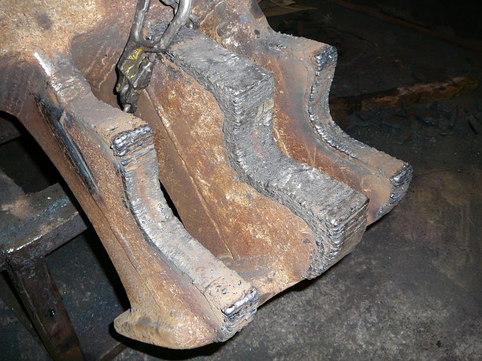

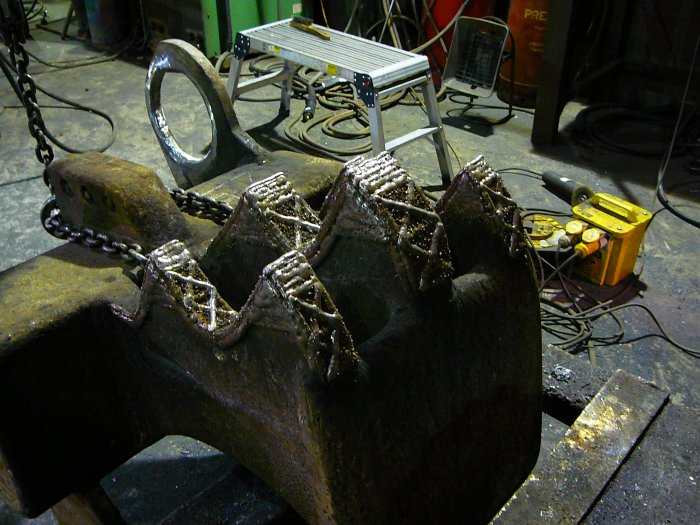

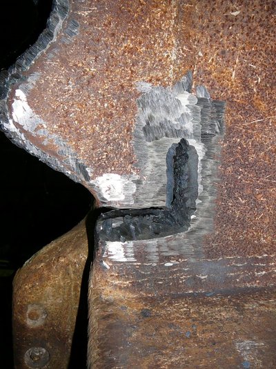

Hi, I'm new to this posting on a forum thing, so if I do this all wrong, let me know. This is a look at my first day back at work, a bit of re-furb work on a crusher (it should look like the one in my photo album when it's done) The teeth need building up and hard facing ,I started this and then found a crack, so I burned that out and welded it ,then back to the teeth. Built up with mild steel, not a favourite job of mine but it looks OK once it's ground up and hard faced (see next post)
