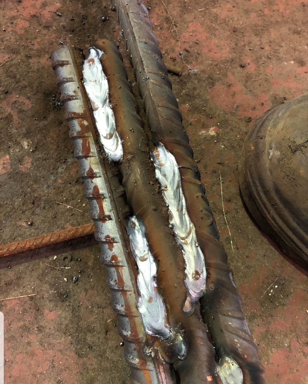

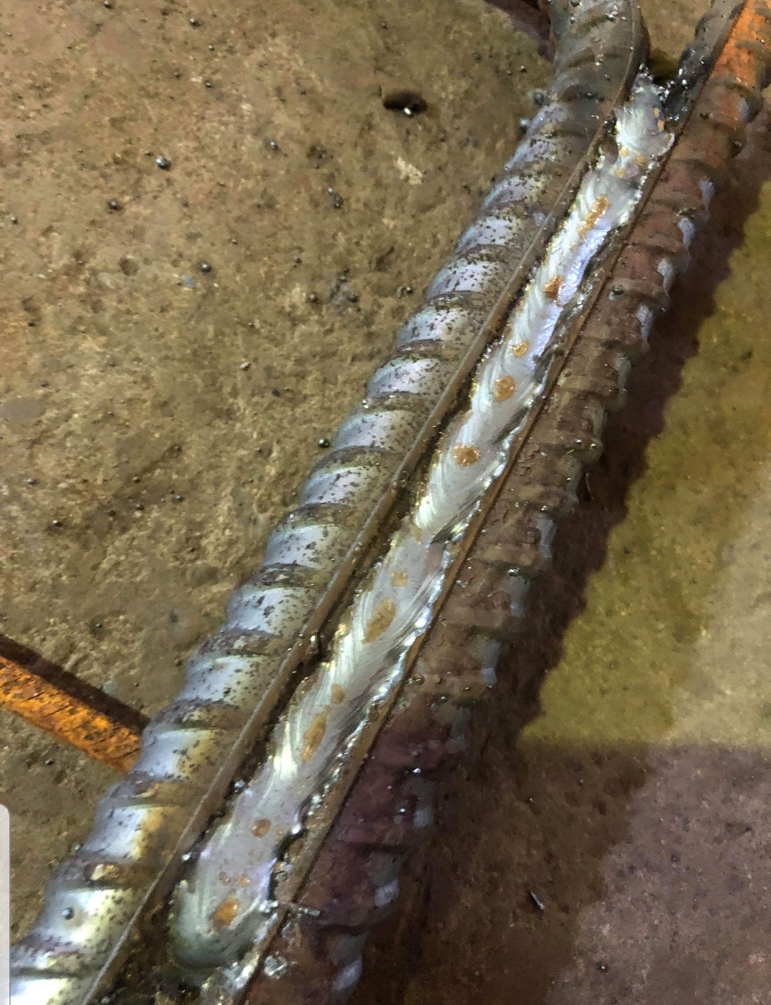

Brad93 Member Messages 17,564 Location Essex, United Kingdom Apr 8, 2019 #2 Needs to be hotter with a slower travel speed.
U ukracer Forum Supporter Messages 16,247 Apr 8, 2019 #4 They are not mine lads so not sure. But i would doubt they were cleaned.
Brad93 Member Messages 17,564 Location Essex, United Kingdom Apr 8, 2019 #5 I’ve got some rebar somewhere I’ll get some parameters for you. What diameter wire was used?
U ukracer Forum Supporter Messages 16,247 Apr 8, 2019 #6 Brad93 said: I’ve got some rebar somewhere I’ll get some parameters for you. What diameter wire was used? Click to expand... He used 1.0mm wire mate.
