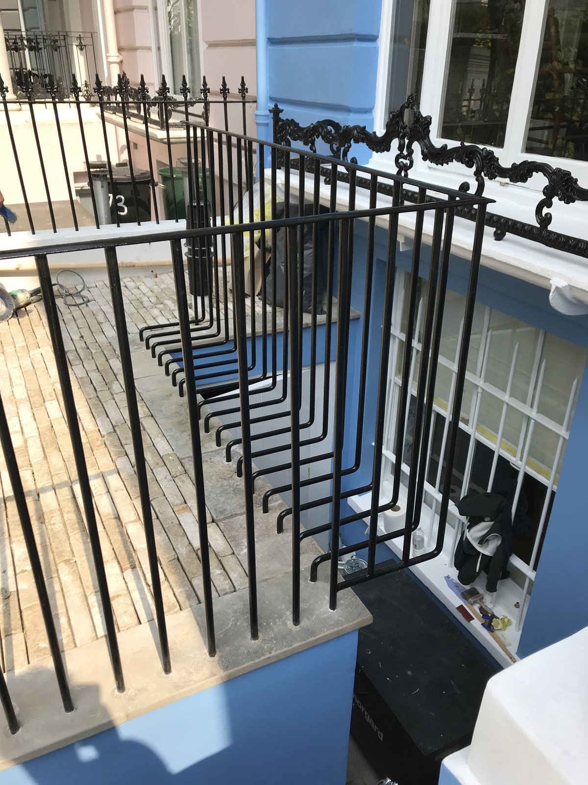

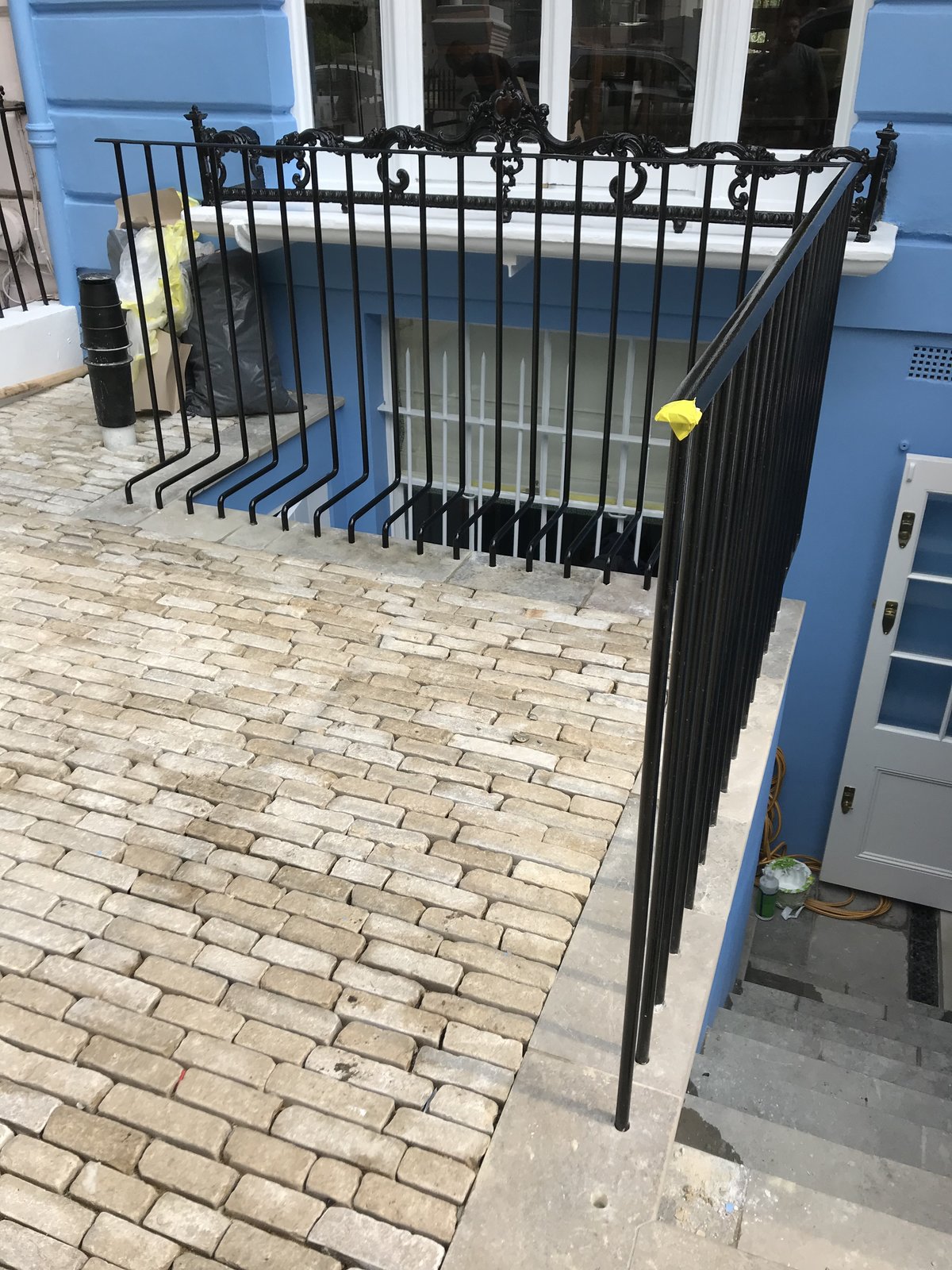

Our clients Tesla was a little to big for his current driveway (first world problems) so we designed and installed the following cranked railings to over hang his lightwell giving an extra 400mm. Will add more pictures when finished. 20mm round bar resin bound 60mm, top rail is 38mm feather edge.

Very nice indeed, at first I thought the lower left hand side of the railings in the first picture was some kind of Escher design until I looked at the second picture that showed it was just because of the camera angle.
