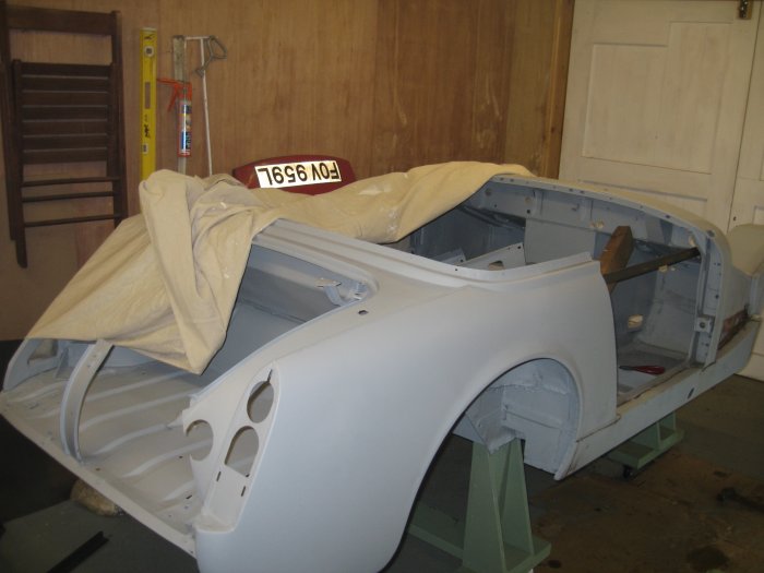

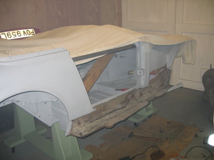

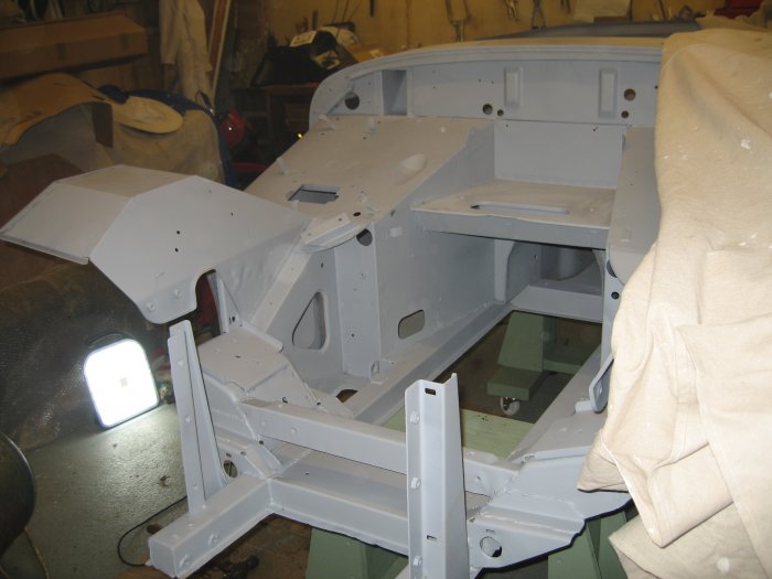

My Midget was delivered back from the blasters yesterday. Just thought I'd paste up a couple of shots. As ever its uncovered more work, including the other sill, luckily only the outer. The company was excellent and did exactly what they said including giving me a call between blaster and zinc primer so I could go over and take a look. All in all I'm very pleased and its great to work on a nice clean tub AND he gave me a 150 ltr Clark compressor tank complete with blow off valve and shut off valve.
