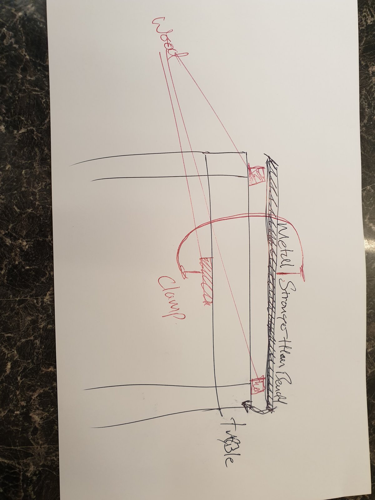

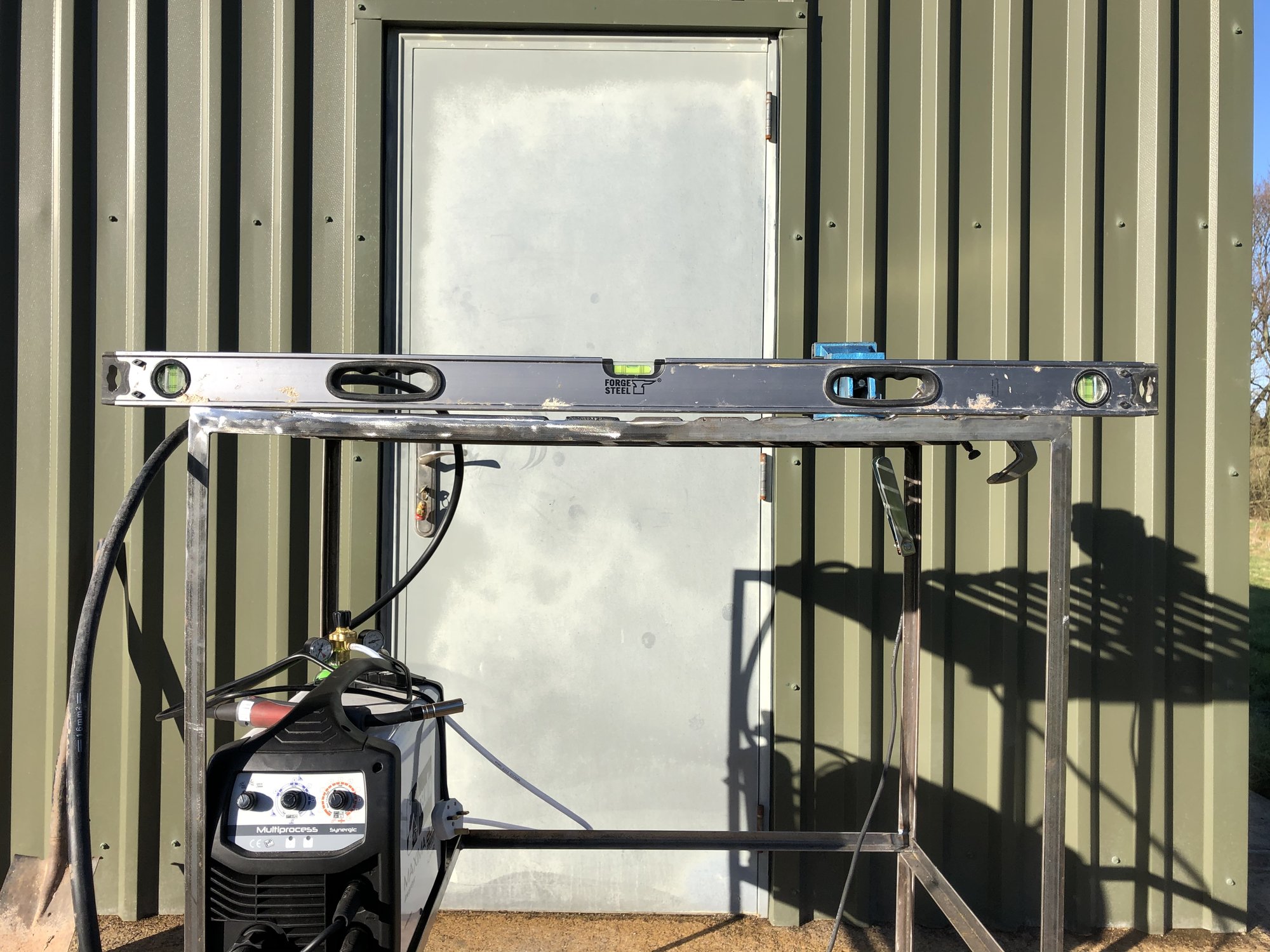

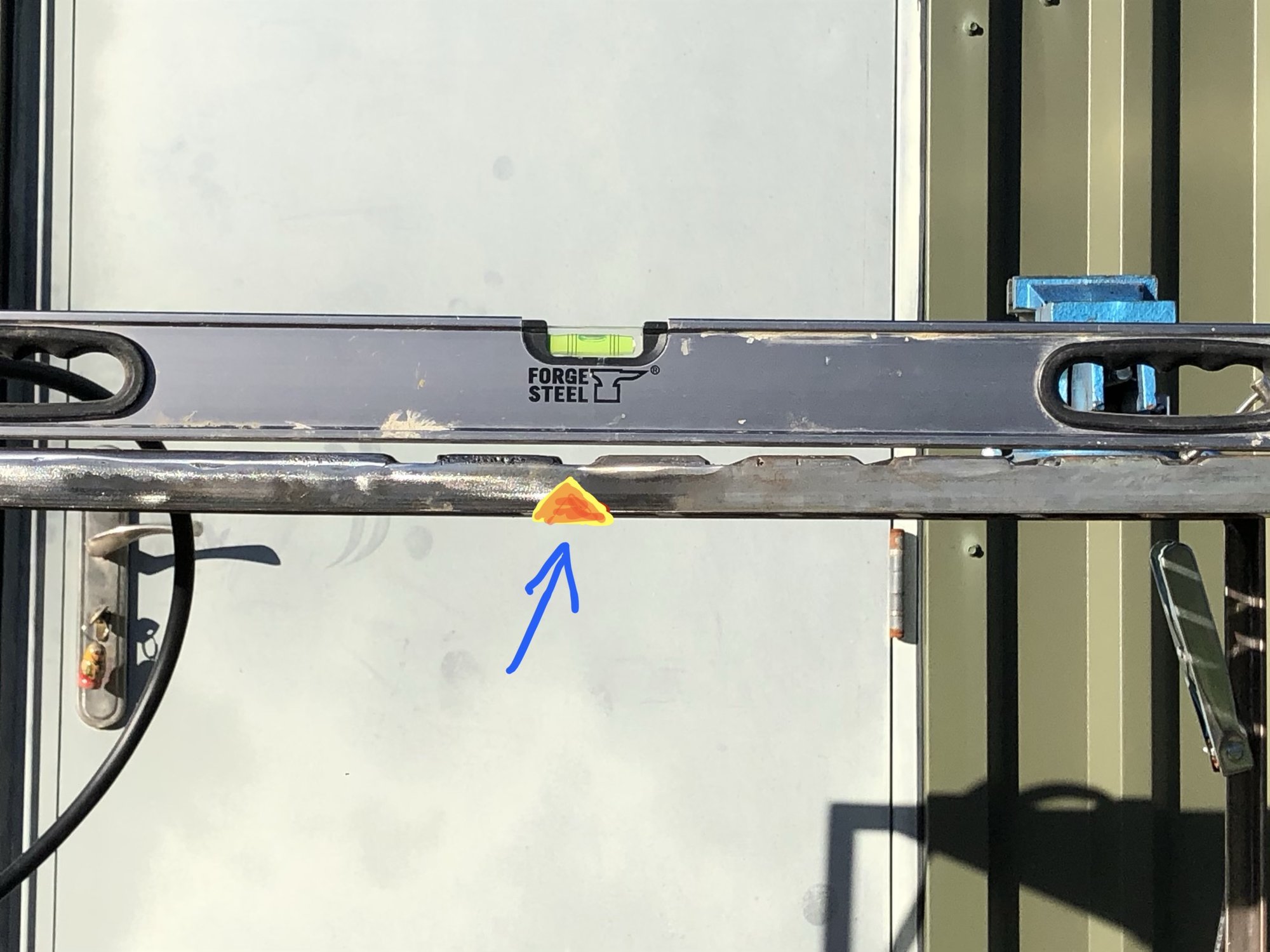

Hello all,
so I’ve finished the main build of the welding bench, just need to add some hooks and hangers.
I noticed the top has concaved fairly evenly with peak deflection of 8mm. There are three supports, one each side and one through the middle, these are 25x25x5 angle
I was planning on doing a wedge weld (as indicated) and then using some 40mm box and g-clamps to encourage correction and limit any over correction. If the first in the middle doesn’t fix it, I’ll do one either side and so on.
Two questions
• is that the right idea ?
• should I do all three supports one at a time or all together? I’d need to buy more clamps to do them all together.
