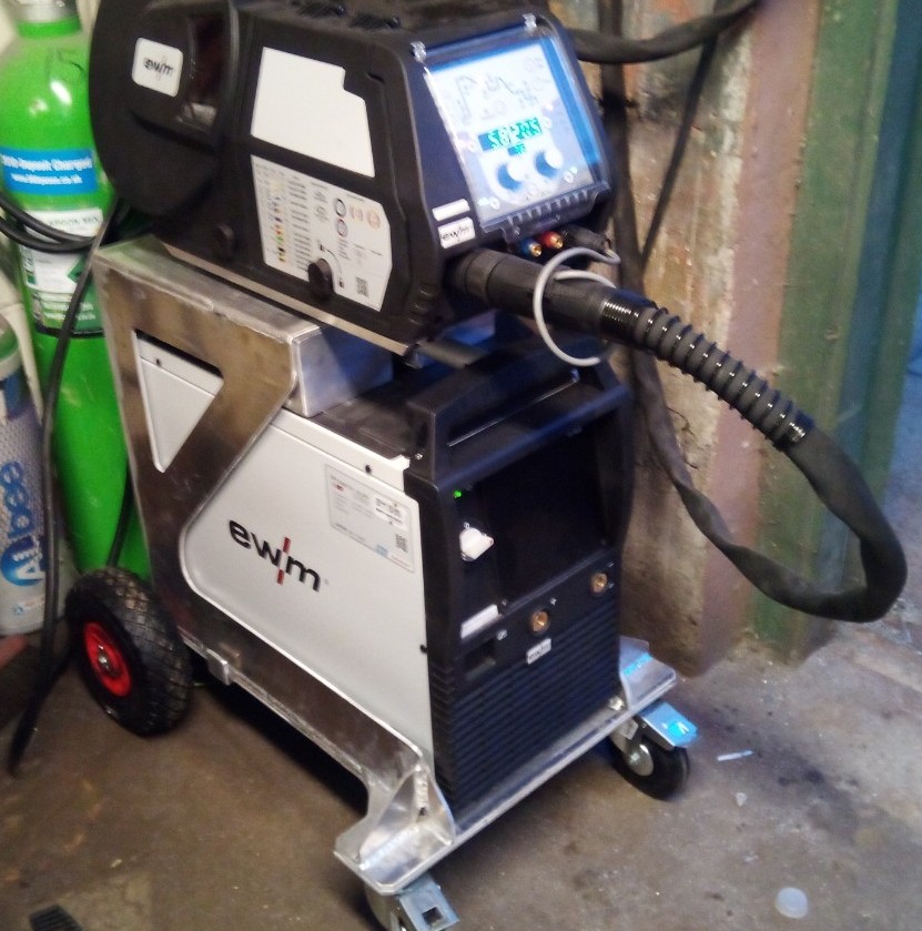

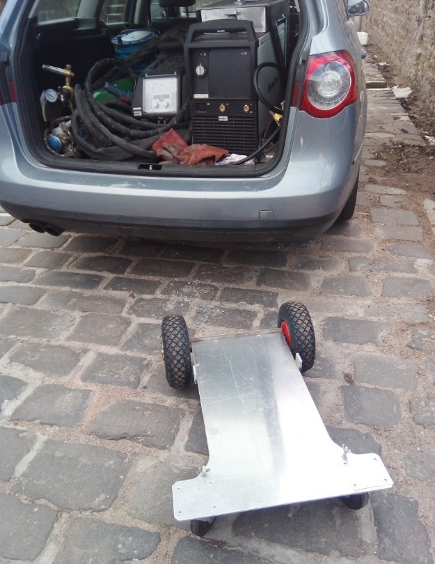

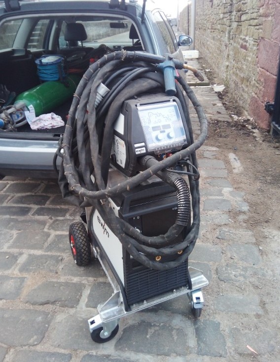

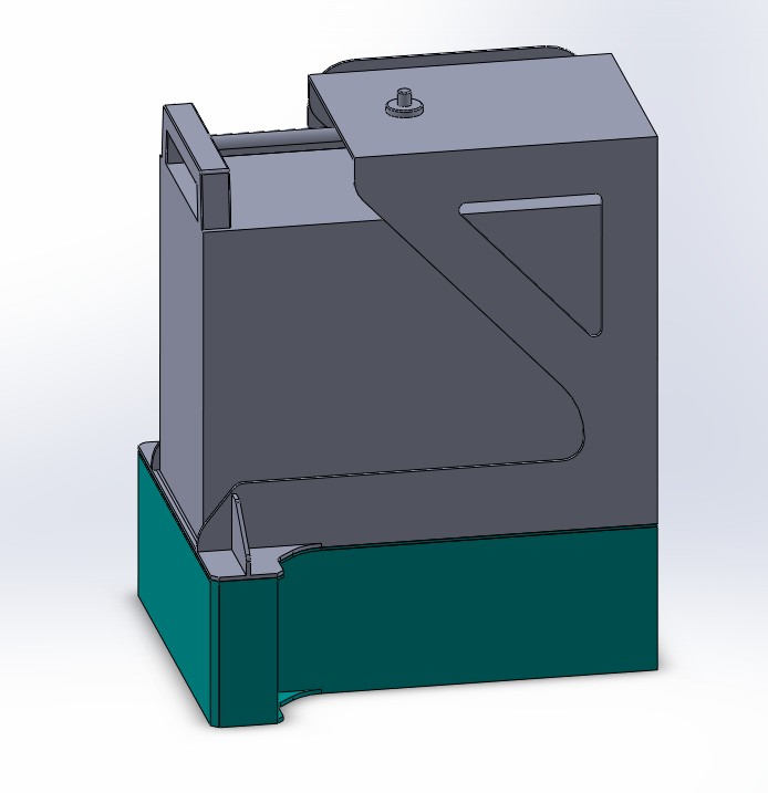

That’s smart.As I mentioned above it will be made to fit my trolley, first mock up of the cooler is below along with a pic of my actual trolley. It will part into three sections, top part with base unit, next part with cooler and lastly the trolley base. That way I can easily put it in the car as per the pictures.
View attachment 194137 View attachment 194136 View attachment 194135
It isn't that big Brad, not that much space in them, I think you would be struggling to fit a motor/tank/rad etc in there. Approx dimensions of the power unit is 600mm long, 300mm wide and 450mm high.That’s smart.
The power source on those is quite big. Surprised they couldn’t fit a cooler in there?
