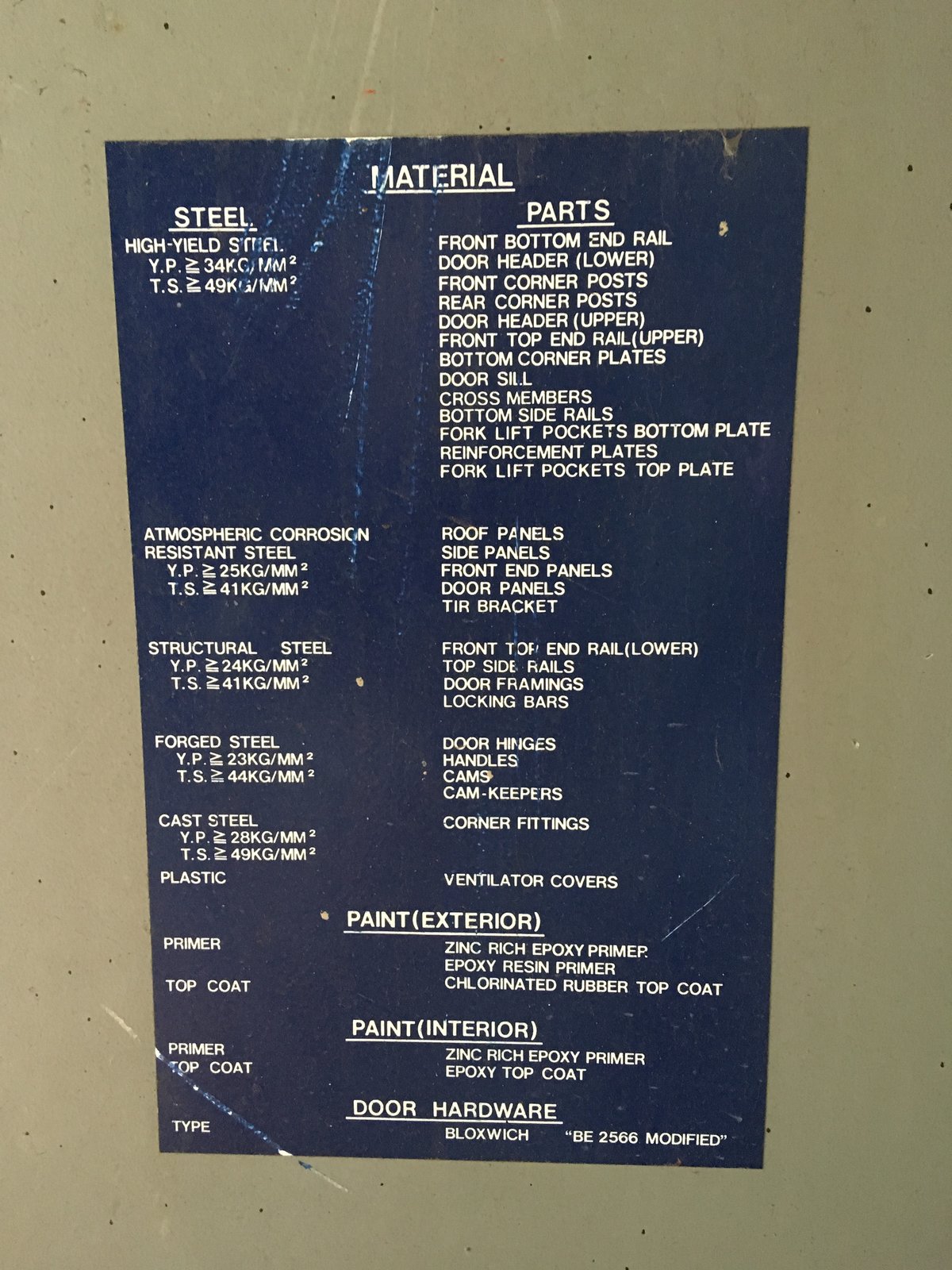

Not much use for the thicknesses but might be of some use for future ref. This is what’s stuck inside mine, it’s a Genstar 1994 so there is just rust missing from the materials list
