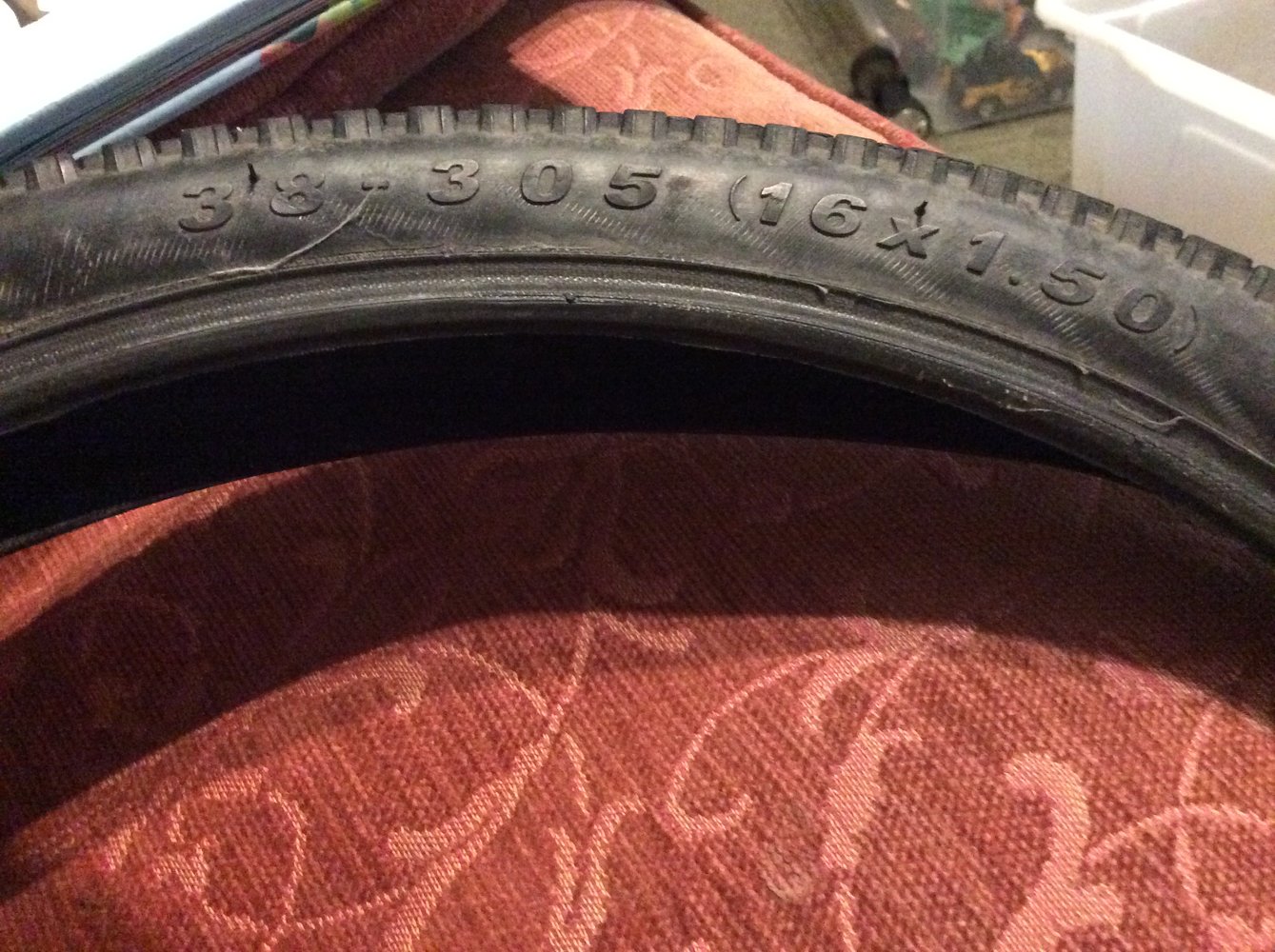

Or take the tyre with you. 16 x 1.5 is not the same as 16 x 11/2. A friend made that mistake and asked me to fit it. The new one was nearly 2 inches smaller in diameter.
Just go by the ETRTO size (305) that's the bead seat diameter in mm. 38 is the width also in mm, but you have leeway on that size depending on the width of the rim and fork/mudguard/brake clearance.
