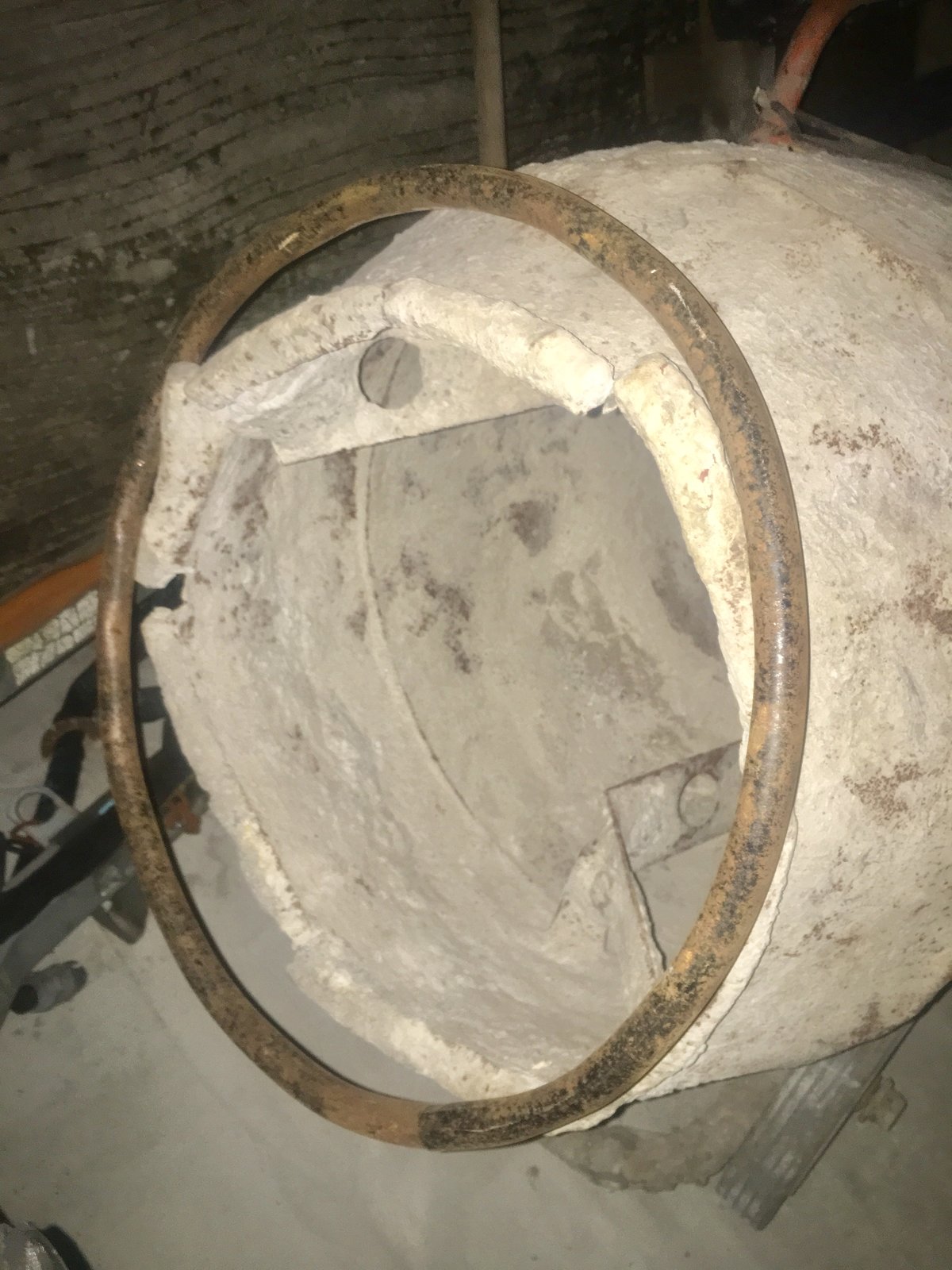

I thought about rebar but making a loop from 16mm rebar was not gonna be easy. I then remembered I had some 20mm black jap mild steel conduit and an old Hilmar bender, so a plan was formulating.

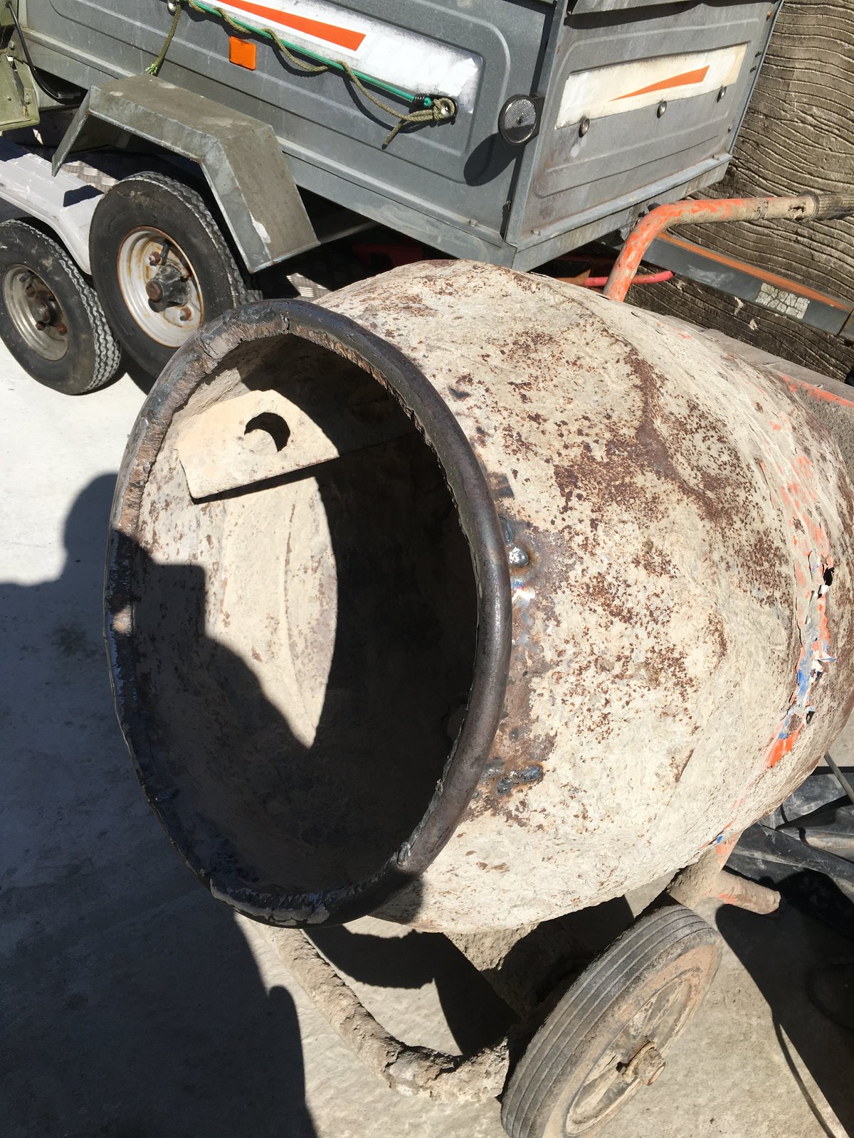

This was the result. You can see how far gone the drum was.
So I basically cut off the return with a slitting disc, welded the ring to the edge then started belting lumps out of the lip until it was formed around the conduit and welded as I went.
This was the result. Not pretty but practical.

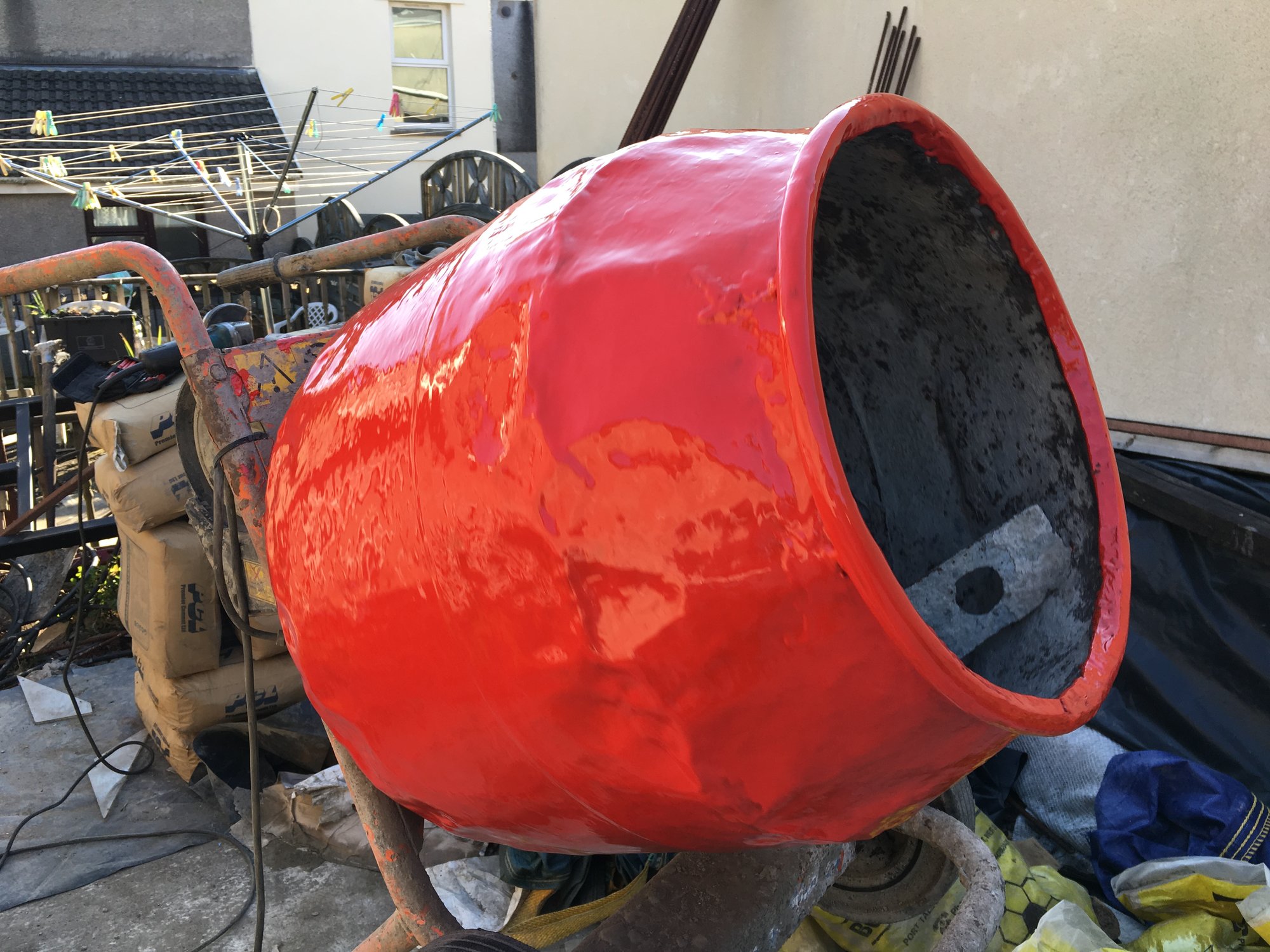

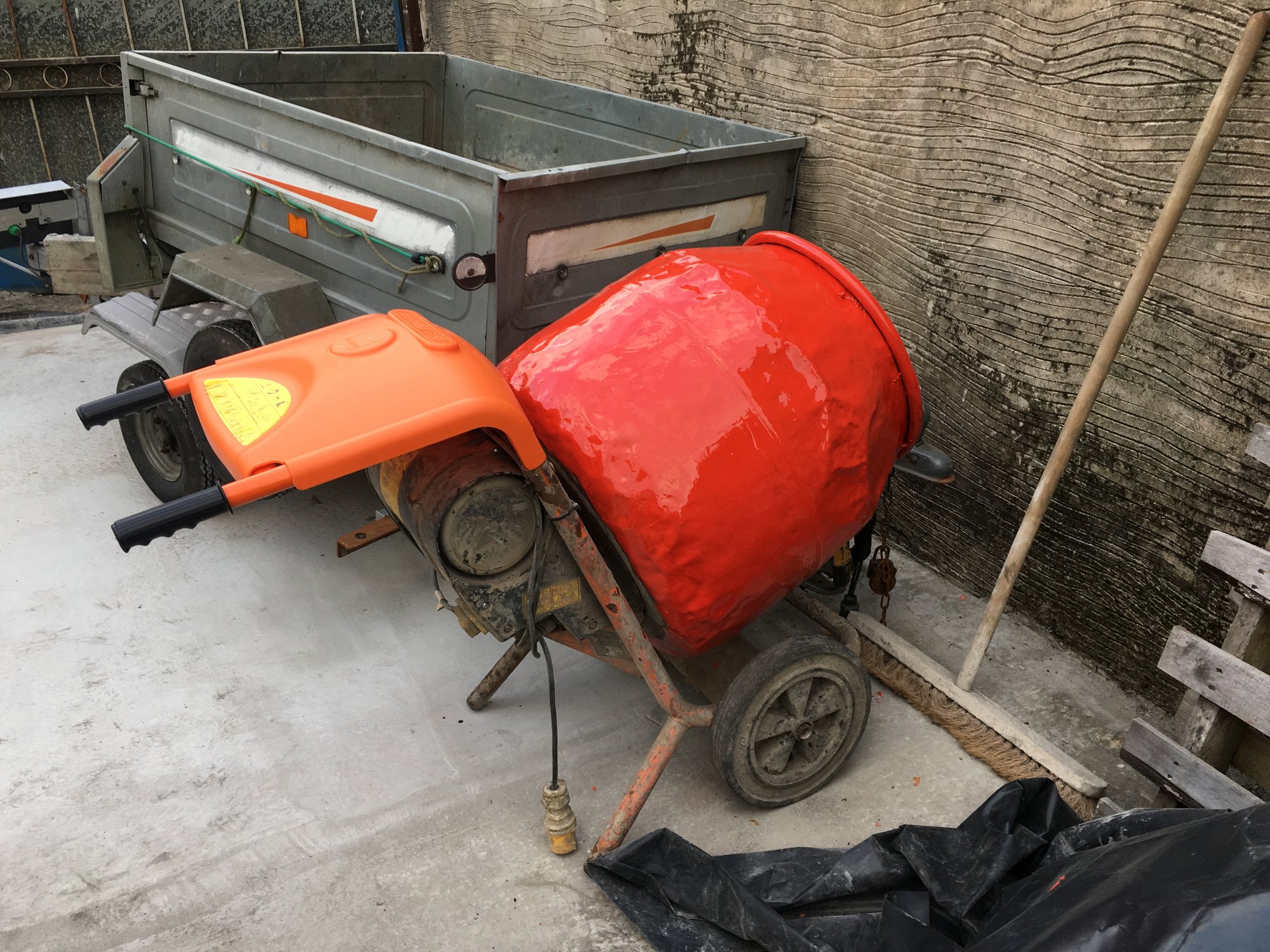

I then scuffed up the outside with a couple of flap discs on my trusty 115mm grinder and slapped a coat of red Rustoleum on the resultant mess. I should of course have waited until I’d ordered the correct Ral2004 colour but I have no patience.
I also ordered a new top cover complete with hinges and handles for £34 so all in all a very cheap mixer.
