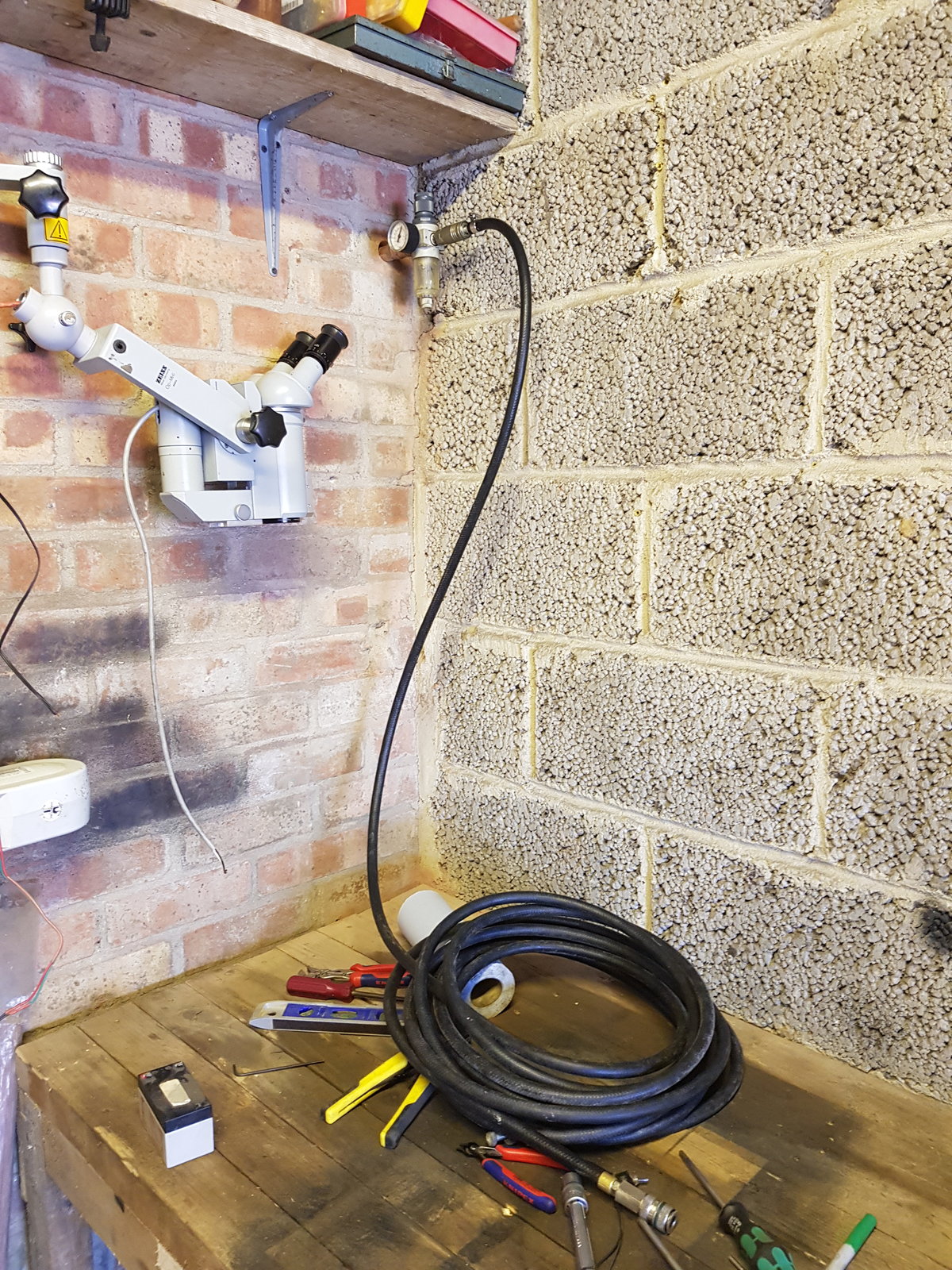

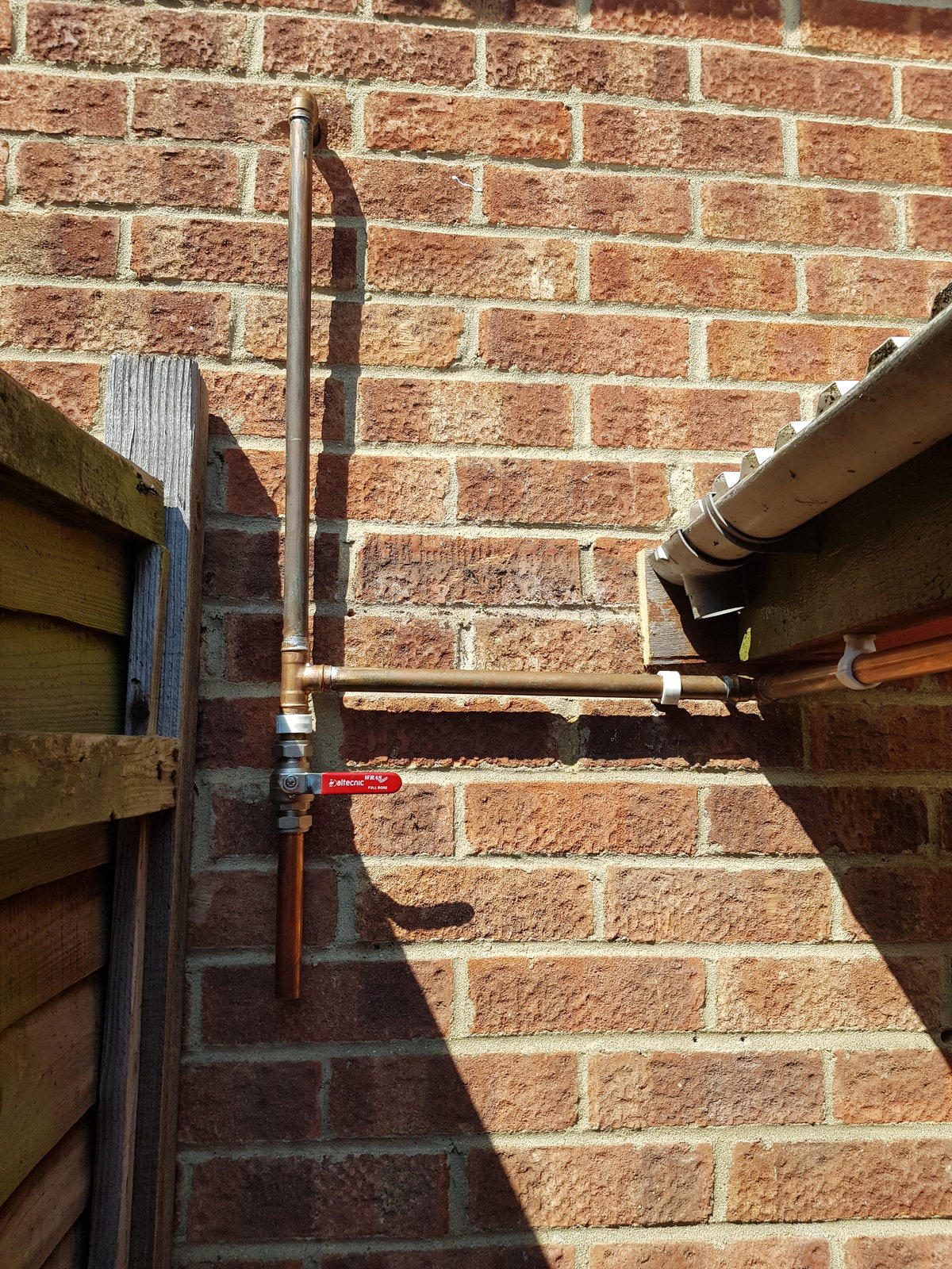

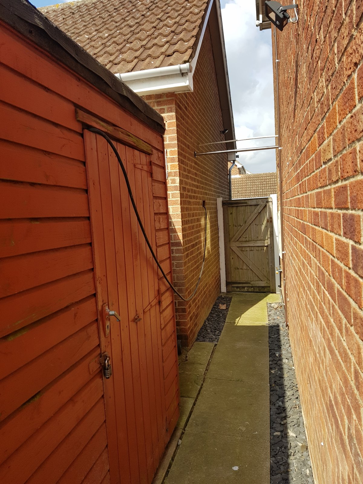

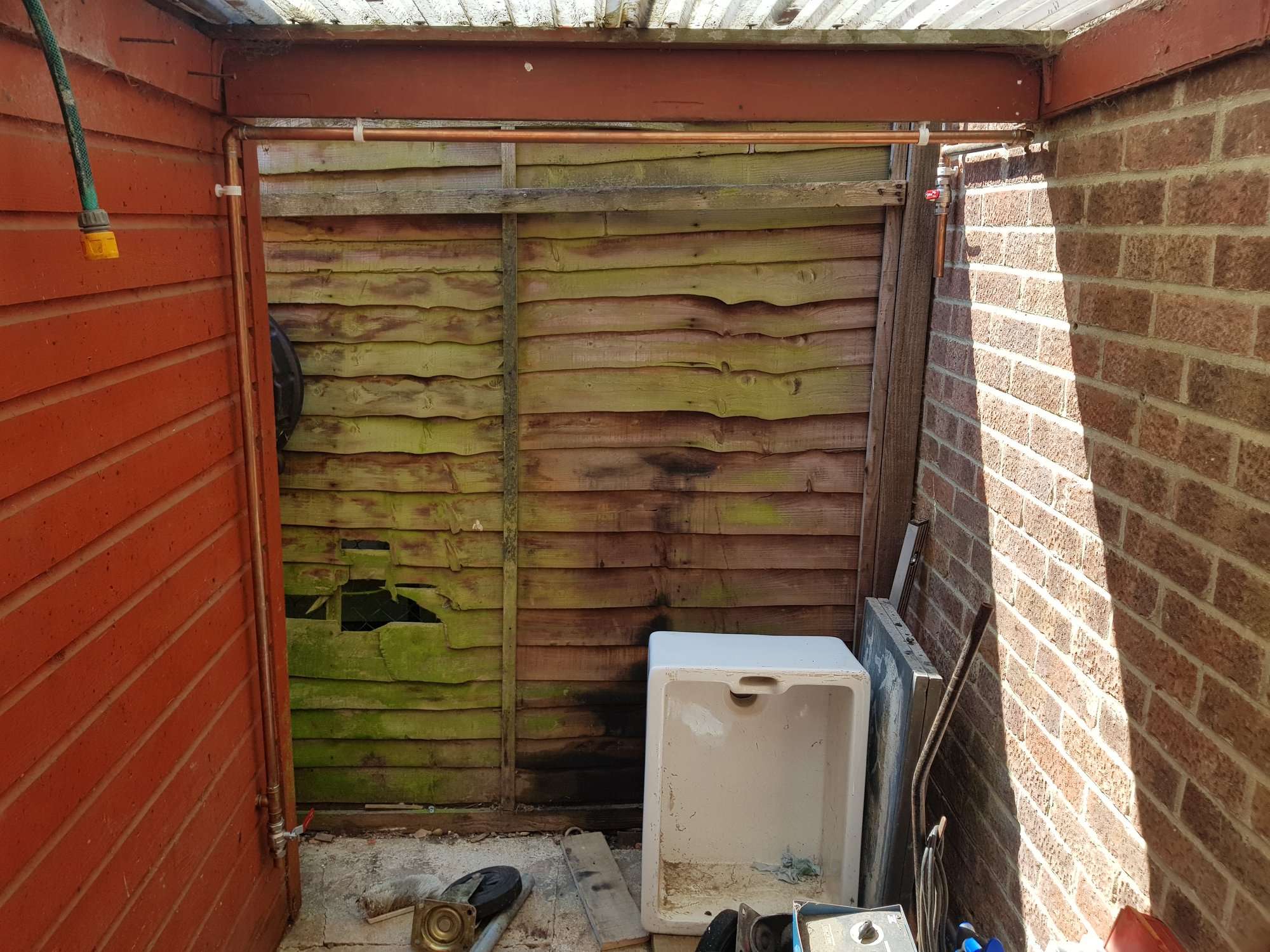

That black hose is my current air line and while it's worked for about three years it's always needed doing properly. The plan is to use 22mm copper tubing and soldered fittings (Might be able to get my hands on a bender too) to get air from the compressor in the shed through to the garage where I'll use the same black flexy hose. A few questions first though;

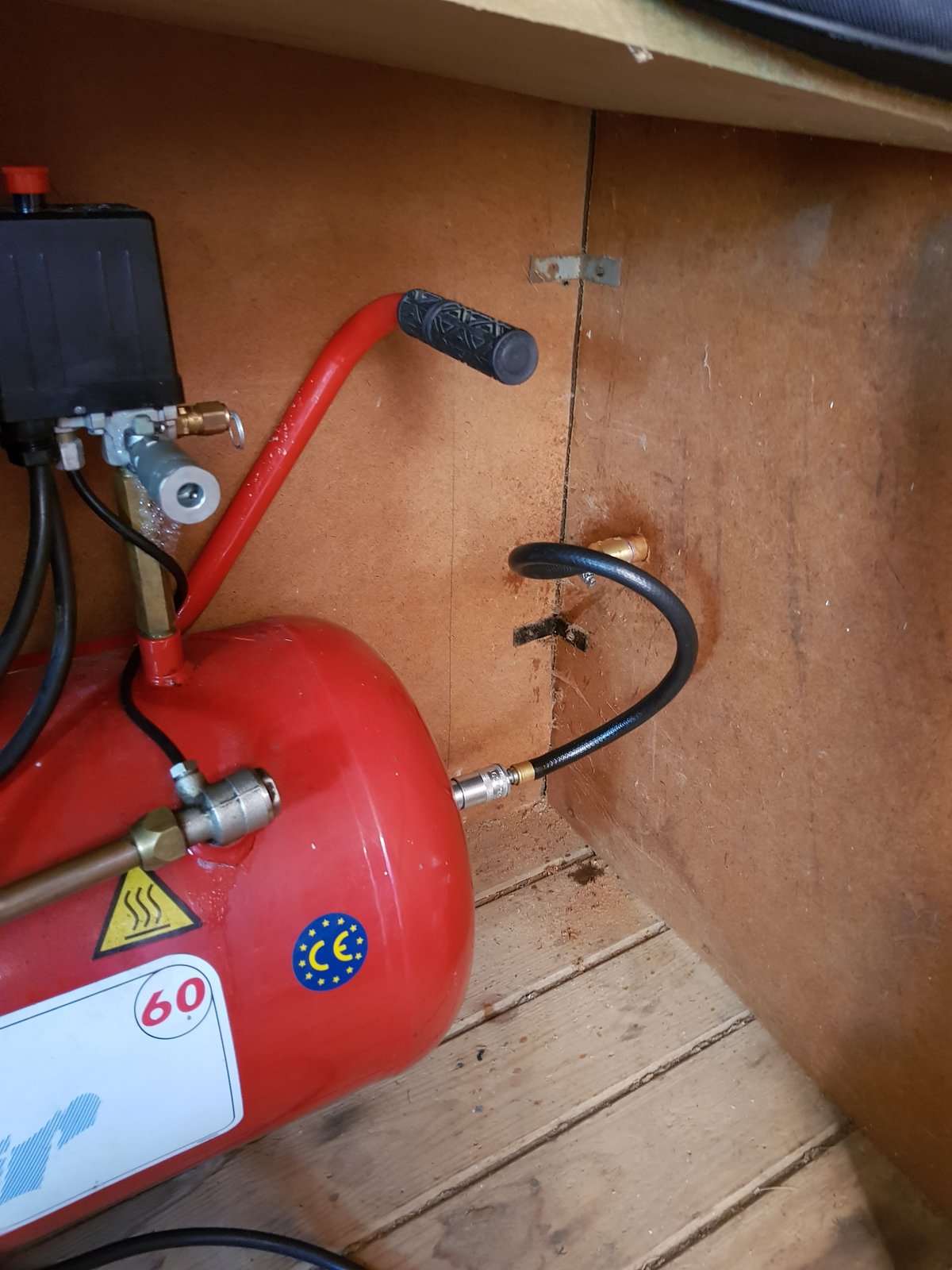

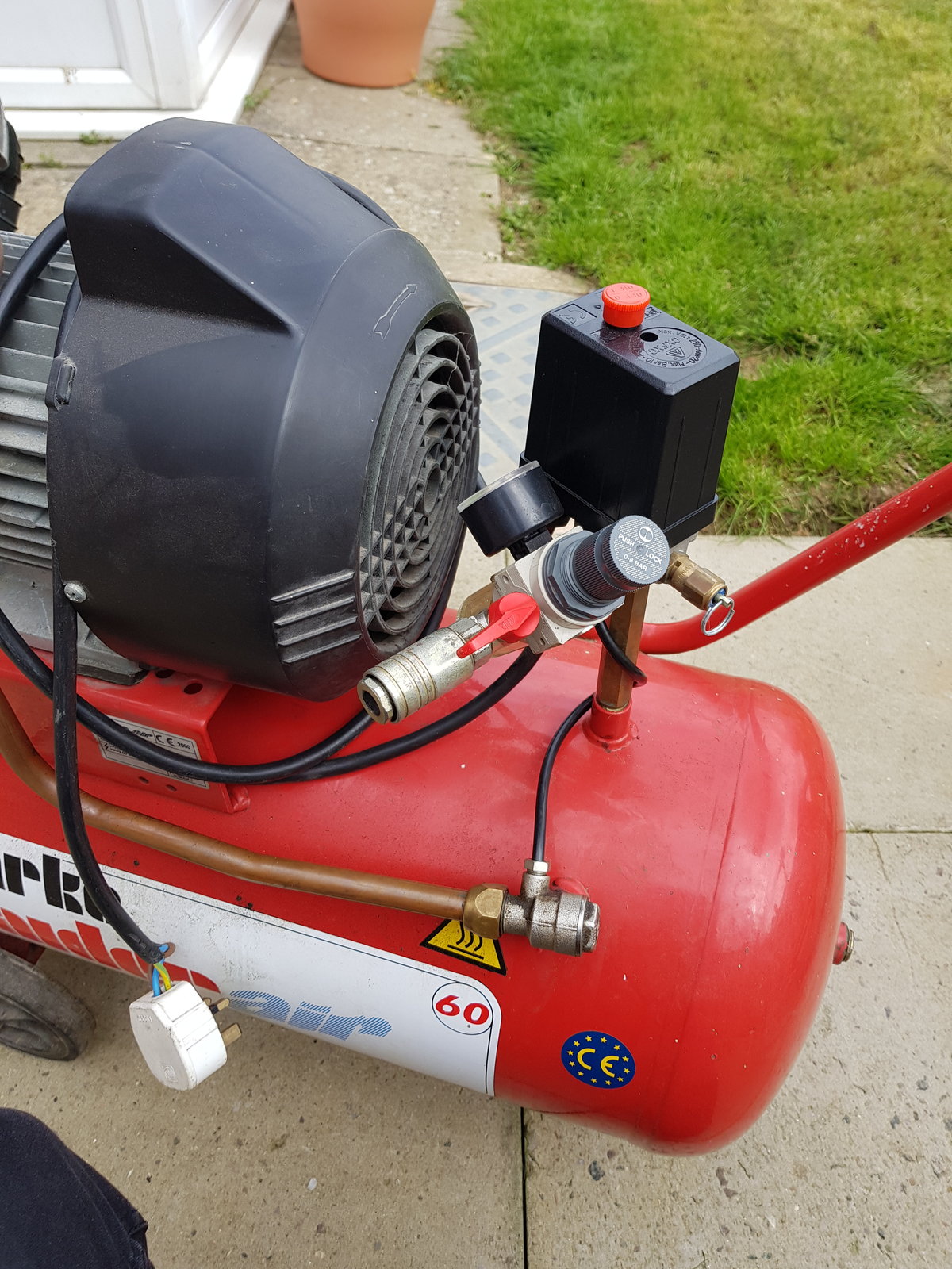

The regulator/filter thing (not sure why it's at a funny angle) is that best left on the compressor or moved to the garage on the other end of the new piping? Would I also be better connecting to one of the big bungs on the end of the tank? Or even the one underneath so water cant build up in the tank?
I want a short bit of flexy between the compressor and the pipe, I've seen tap connectors like this rated for 15 bar, that would be fine wouldn't it?
There will of course be a couple of tees with a valve to drain any water. I' only gonna have the one QR fitting in the garage for now but in the future I may extend it. Am I overlooking anything?
