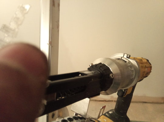

I've wanted a collated screwgun for a good while but the dewalt one bare is £230
The Makita as a set with a battery is cheaper, but having used them a good amount id never buy one
So i thought ill try an attachment for the drill, that was only £16 i trialed it an the mechanism is fantastic plus simple but it doesnt fit any of my drills well enough to use.
A solution had to be created, also a good opportunity to play about in the workshop and have a break from the house.

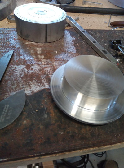

Marking out
The part was turned eccentric to allow space for the clamp screw simple set up
As my mill isnt set up i held the part in the chuck and used a large endmill then finished with hand tools

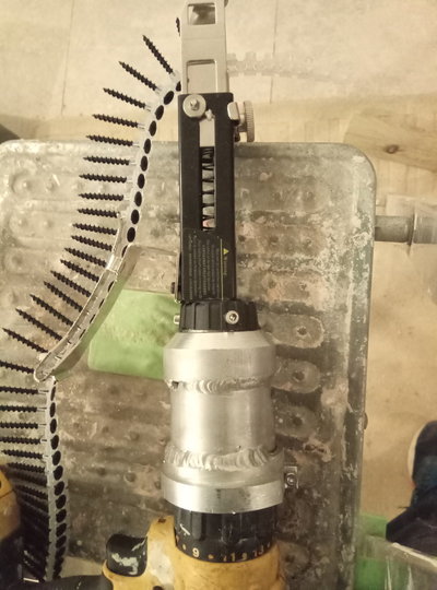

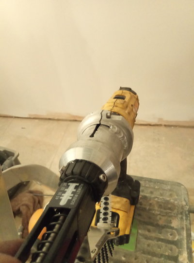

Little bit of tig welding shes complete
Took 3 and 1/2 hours a good deal was looking through unsorted boxes for tooling
