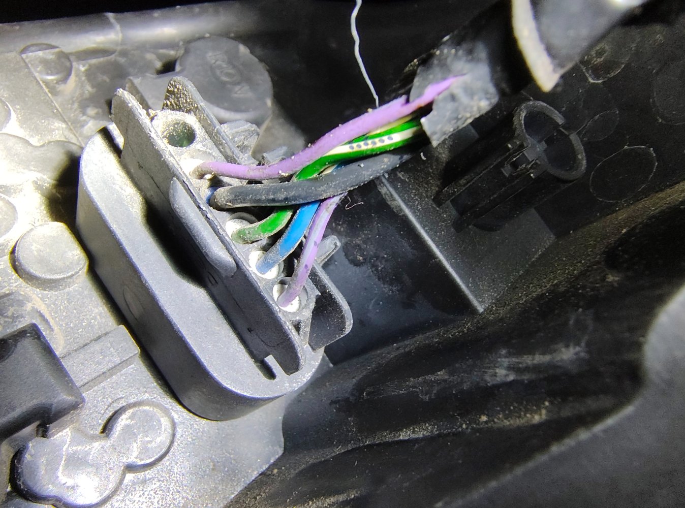

Hi, I've fitted and wired a towbar to our 2012 insignia but got a slight issue with the wiring.
The brake lights on the insignia are combined stop/tail lights so when the car lights are on, the bulb lights up like a sidelight, then when the brakes are applied the same bulb gets brighter indicating brakes on, it's not a dual filament bulb. I've used a universal bypass relay as when I fitted a P F Jones vehicle specific wiring kit on our old car (meriva) it was basically a bypass relay with a few piggyback fuses and you still had to tap into the wires with scotch locks. Anyway, all other lights work fine but the trailer brake light now comes on when either the brakes are used or the lights are switched on! It's not differentiating between the two. I assumed one wire leading to the stop/tail bulb on the car carried two signals depending on the situation and the purpose of the bypass relay was to separate the two? Anyone have a solution?
Many thanks!
