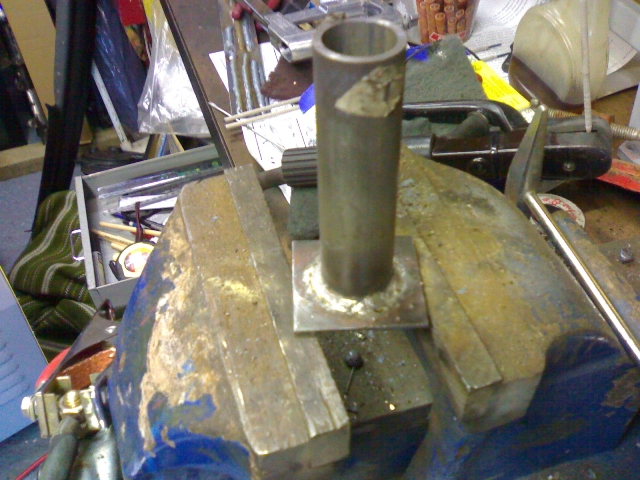

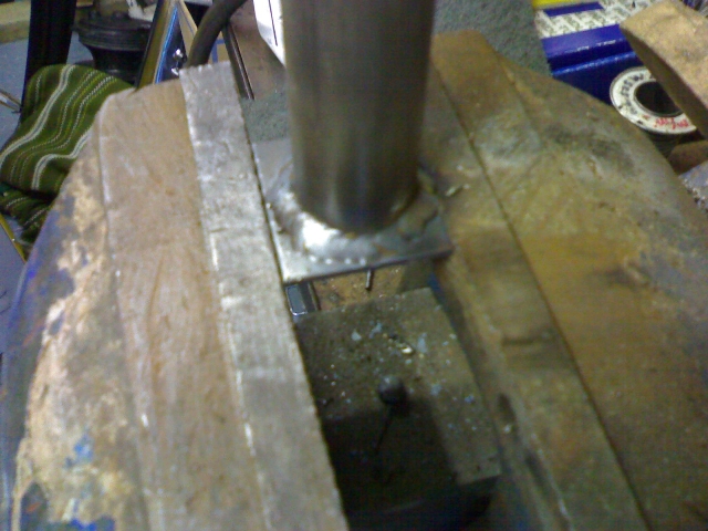

Been out messing about with me new toy.
Noticed how poor the start of the weld is with a MIG! You have to start forward of where you want to and go back on yourself, or you get an area with poor penatration
Been ages since I had a MIG set, think the weld I did with the stick set was neater
The top is the MIG. The bottom 2 are done with low hydrogen rods with the Oxford set
