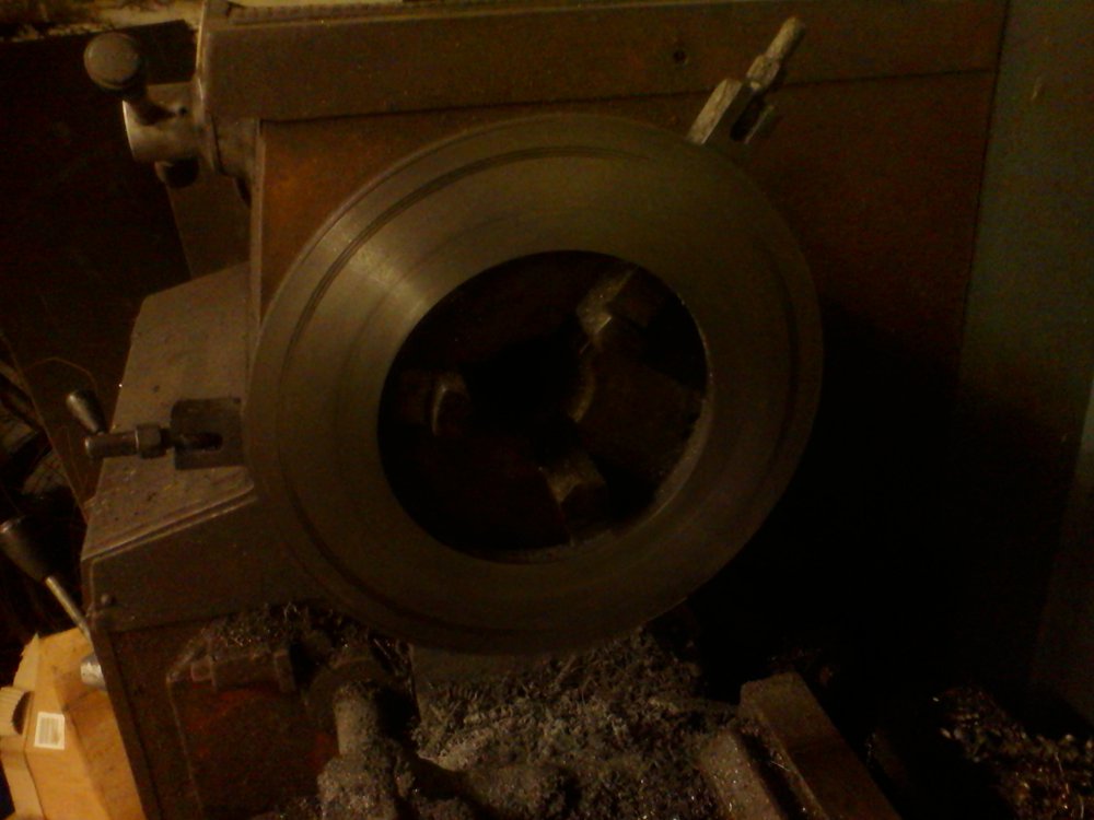

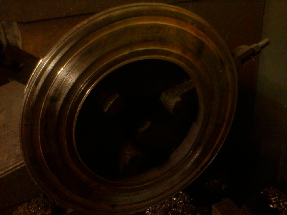

Managed to take a pic after the first light cut,
A real toe curler this one for all clutch lovers-result of a ceramic plate decimation and some big old rivets. Then some kind chap had wazzed in a new plate and flogged it..lasted no time at all really. So a few hours of lathe therapy and she's trued up lovely.
You can see the high points where the plate has distorted over time. Seeing those come through was reassuring as it was a pig to set up in the chuck with 3 high spots. I recon I got it within 0.06mm using a cutting tool and tool post no dti. Cheeky...
