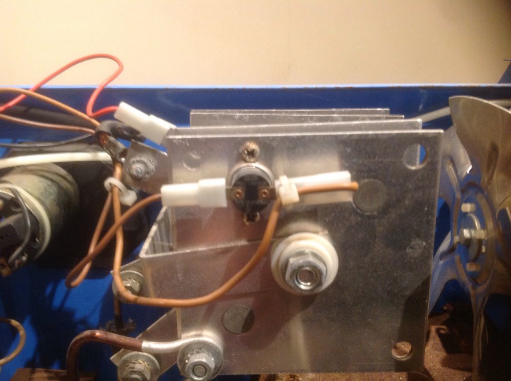

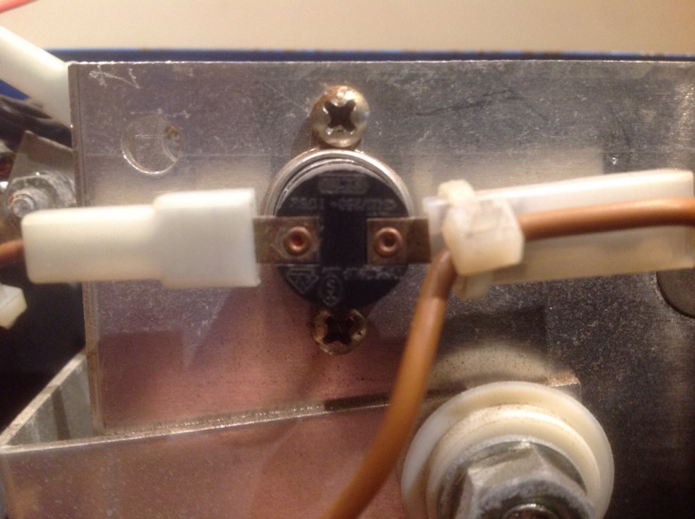

thats a thermal switch, its used to turn the power off if the welder overheats. I've got them off ebay in the past but you'll need to get one with the same switching temperature. As a temporary fix for light usage you may be able to just join the wires until you get a replacement, but if it overheats you might end up needing to get a new welder, or call the fire brigade out.
