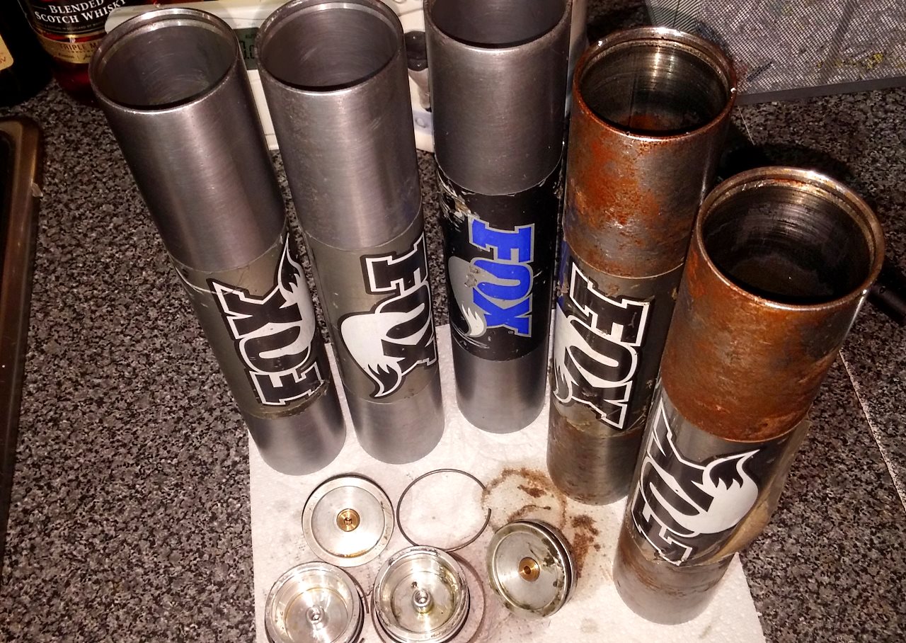

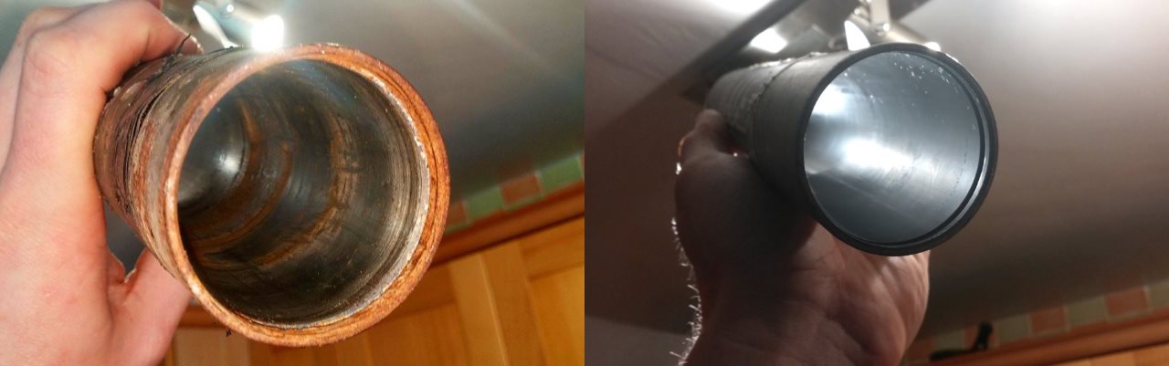

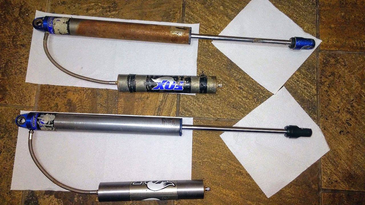

Get a 20L tank, stick 500g of citric in it, stir.
Really is as easy as that.
Citric acid is my go to situation. Bucket with hot water, some citric acid and away you go. Never measured anything. Always works
