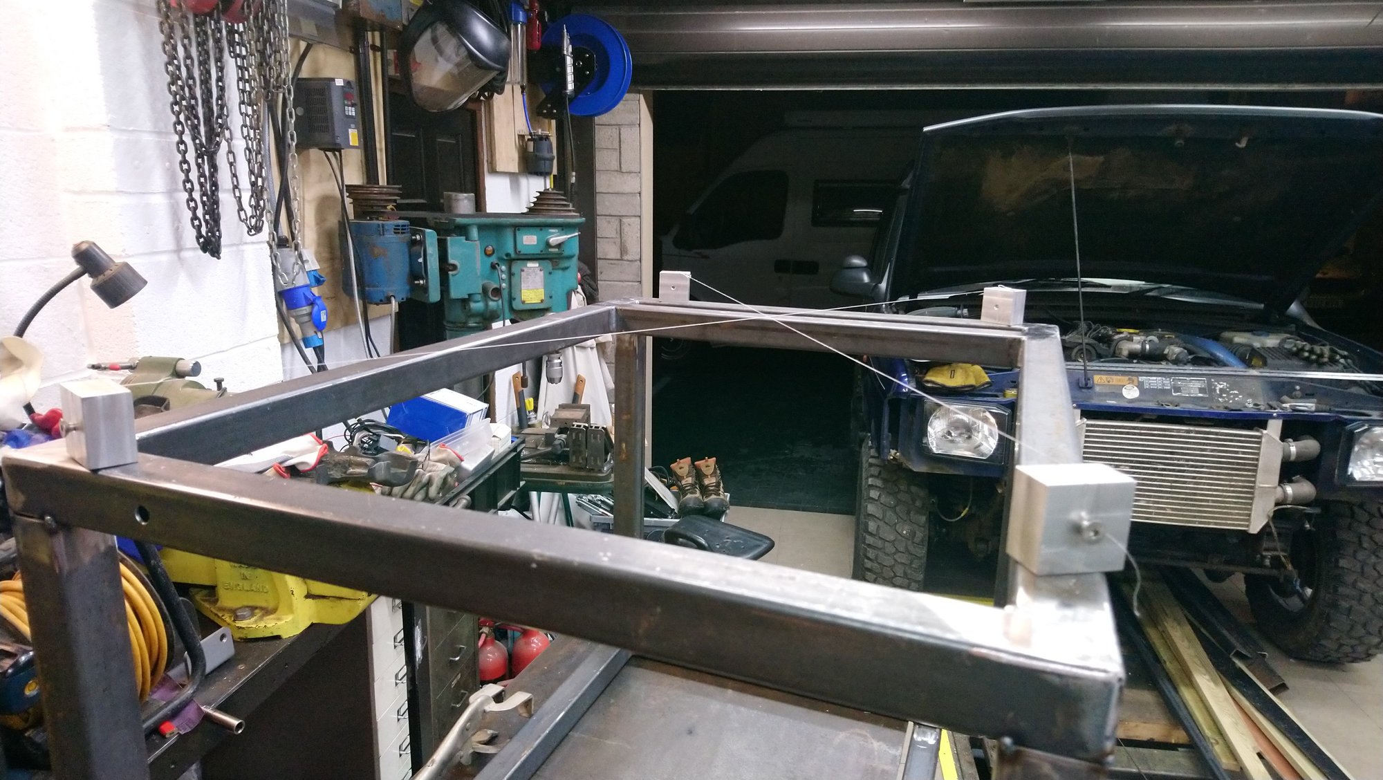

I have made a couple of frames for a job I am doing and I want to make sure they are not twisted
I had a think about it and made 4 aluminium blocks and they are machined so they are all the same size
Drilled a recess in the bottom and glued in some neodymium magnets
Have placed these on each corner and tied some thin cotton thread across the diagonals and where the cotton crosses in the centre it just touches
Can the collective give me a second opinion as to does this actually make sense and give me the result I'm looking for as my brain is mush ATM
