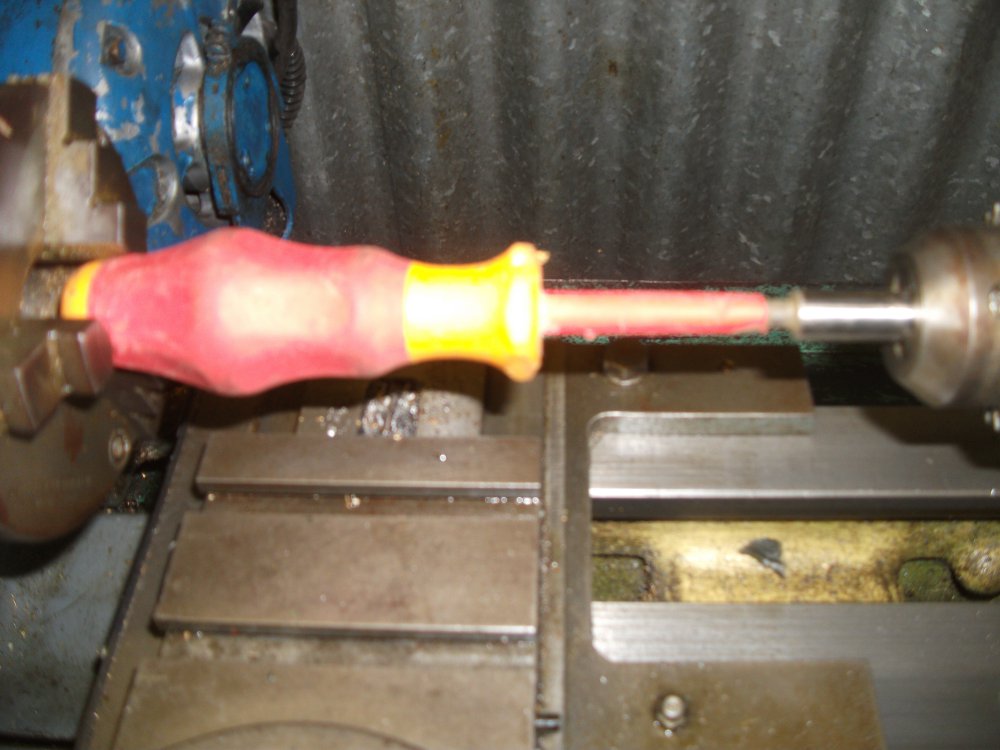

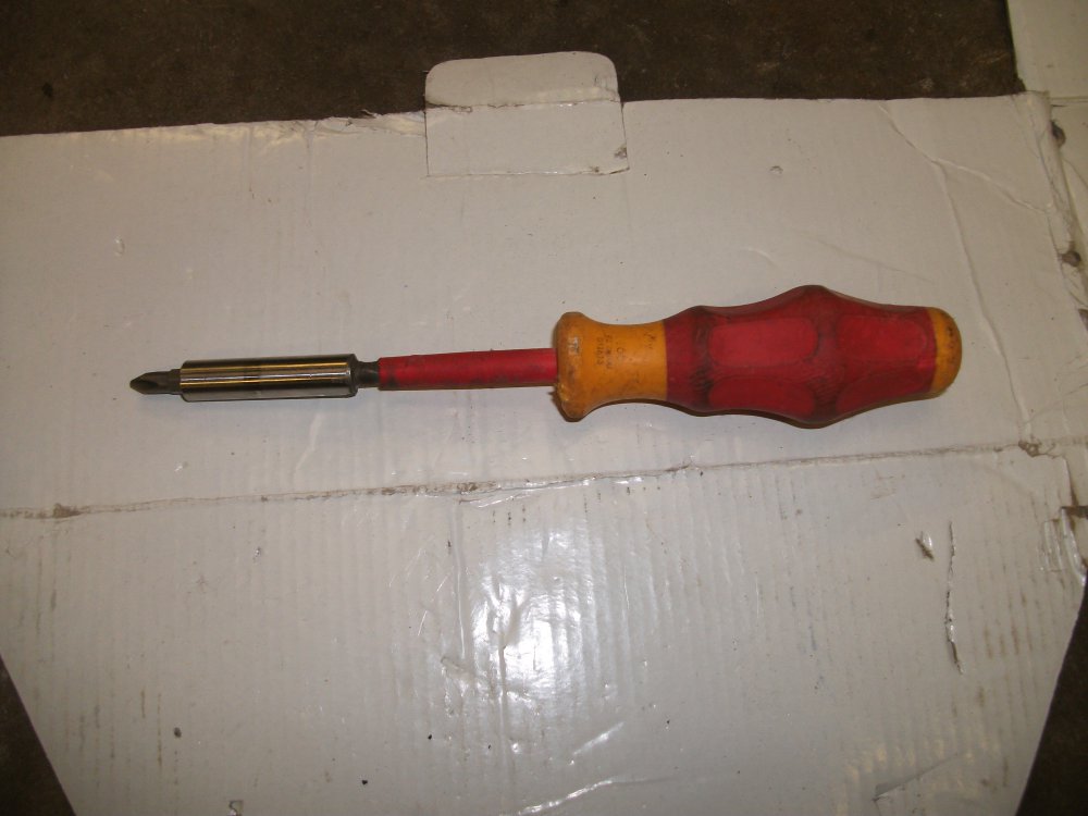

having decent phillips or pozi screwdrives used daily only last under a year and at a fiver a pop its a waste to throw them .buy a cheap magnetic screwdriver bit holder and knock the hexagon drive from it. grind the end of screwdriver flat grind a couple of flats on the sides. fill the bit holder drive end with plastic metal or simlar and push the driver in .i set mine up in lathe to harden off so that the end was parallel decent bits are a fiver a box and interchangeable
