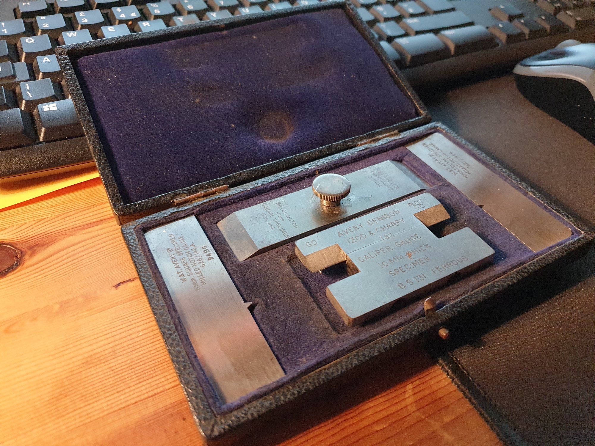

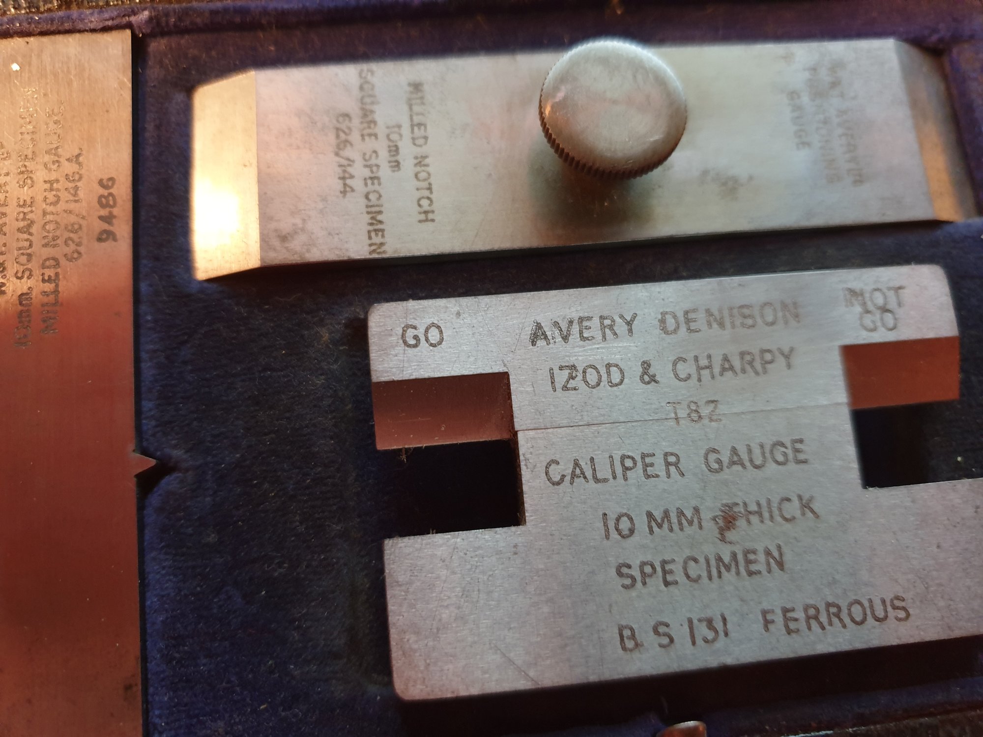

    Found these in a drawer. Cant remember how I came by them but they are for checking the dimesions of Charpy V Notch test pieces
    Im thinking they could be alloy steel so good for making a blade...a small one

    If you’d be willing to part with them they would be good to show my students

    Too nice to make into a knife!

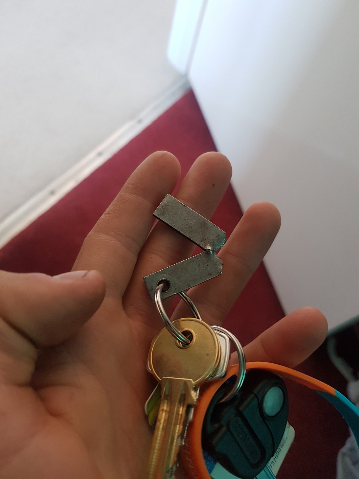

    Sort of relevant: I've got a Charpy test specimen on my keys. :laughing:
    We did it in first year, I thought it looked cool so I kept it, broke the corners and drilled a hole in it.

    It must have been a good one....they usually break in two
    I used to have a tensile test piece with a big slag trap in it....it was to remind my Apprentice of his first go at welding a test plate.
