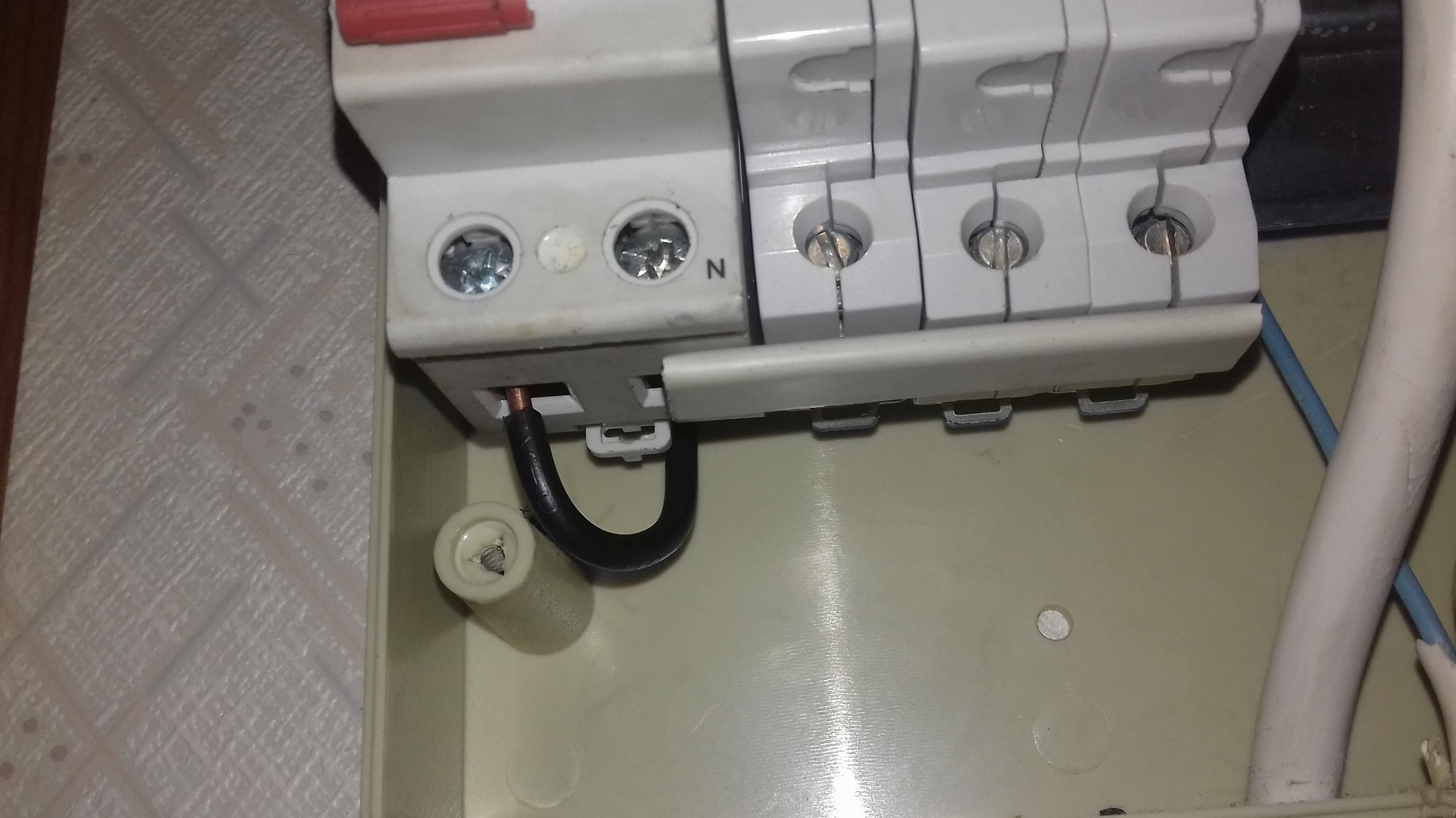

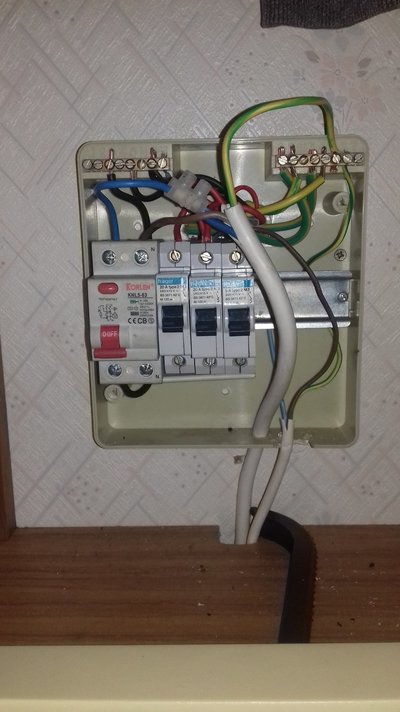

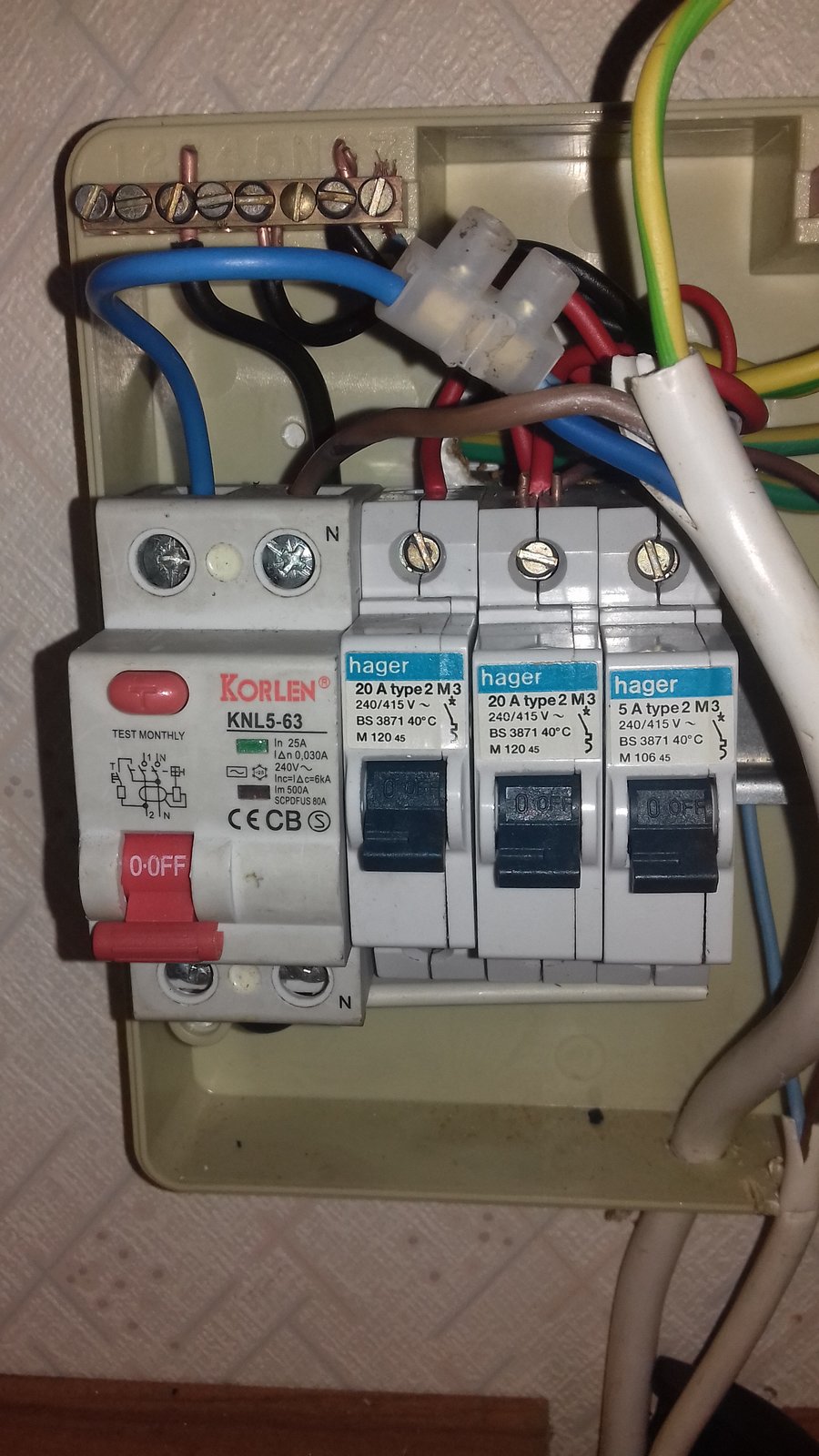

    Anyone on here any good with caravan electric more specific about static caravans over loaded the trip box burnt out the rcd. I've changed the rcd but soon as I turn it on the hole lot trips out have I burnt out one of the individual trips I can't afford an electrician at 90 an hour lol any help is much appreciated

    Could have damaged the cabling after the fusebox. Have you connected up the new RCD correctly?

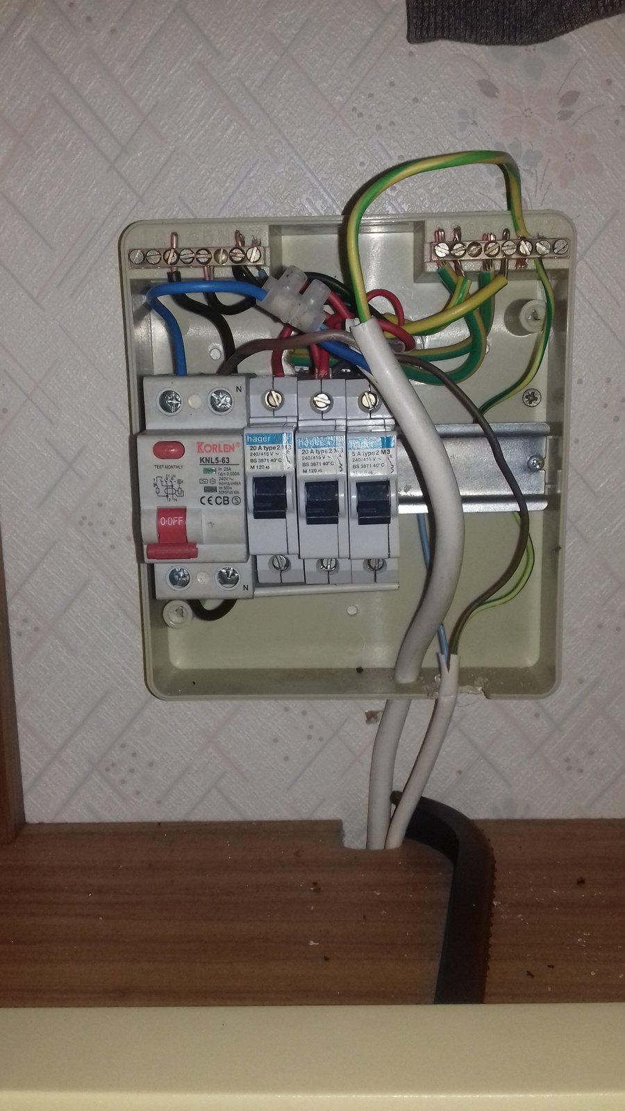

    I've connected it exactly as I took it apart but I don't think it was ever put together properly will post a pick I've check the cables coming out the top of rcd and all trips no burns breaks or kinks

    That RCD May be Polarity sensitive as its connected back to front as the way the board is configured live is where the neutral should be.
    If this is living accommodation you need to find an electrician, That Is Not Safe.

    Take it out move everything along to the left and fit the main switch on the right then polarity will be correct

    To test turn off all the other breakers switch main on and see what happens

    Yeah I did that all trips off then only main rcd but stills trips

    The replacement RCD could also be faulty. How did you manage to overload? The overload could have damaged things not visible. You need to be checking the cabling further down the line and the only way to do that is with a test meter and somebody who knows what they're doing.
    It could also be a neutral to earth fault that turning off the MCBs won't rectify which is why it's still tripping.
    Without being rude it looks like a bit of a lash up and just because it is/was working doesn't mean it is/was safe.

    Is that main switch new, doesn't look new

    There are only 45amps worth of breakers the main is 63 so how did you burn it out ?

    Correct but if there is a neutral touching an earth it will trip the RCD whether the breakers are on or not.
