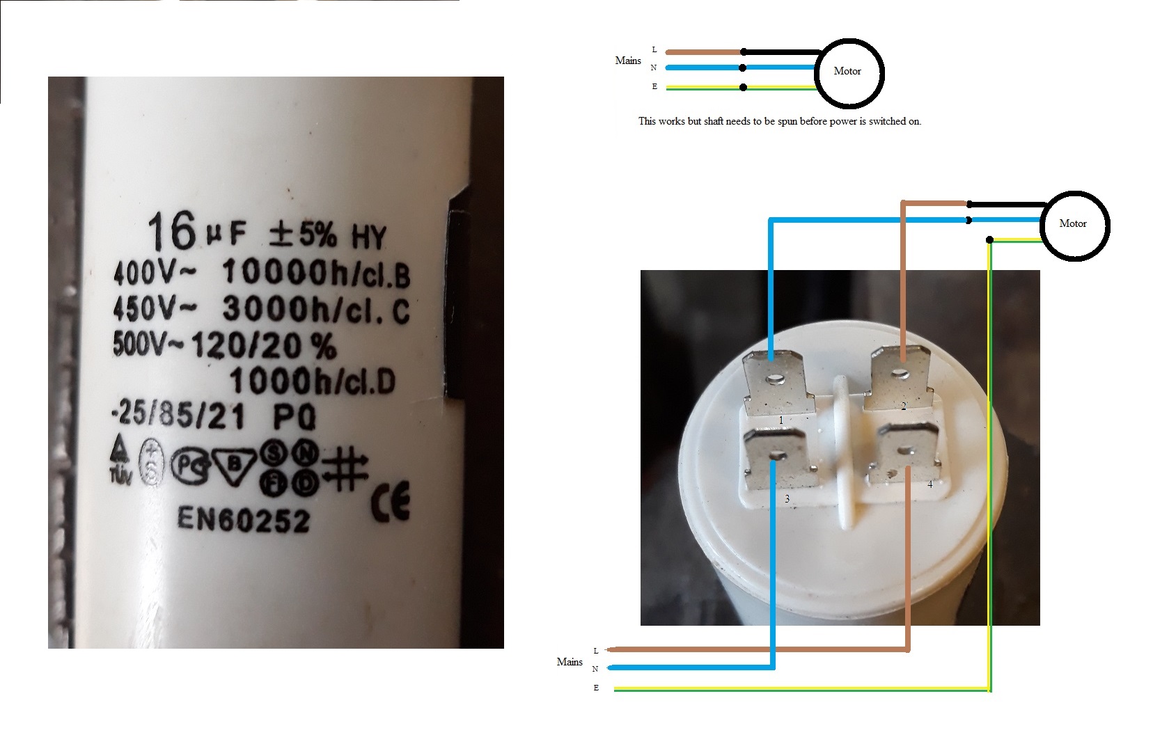

Hi folks,
Long time since I've been around these parts. Hope all are well.
Years ago I got some excellent help here re wiring an old motor.. thread here - https://www.mig-welding.co.uk/forum/threads/sole-washing-machine-motor.31228/
Finally getting around to fitting a cap to it, I'know! I got a cap from a domestic appliance parts place.
In the attached pic/drawing I have shown the way it currently works (albeit I have to spin up the shaft first) and the way I was thinking of wiring the cap in. Thought I would ask here before I do it.
I have numbered the terminals to make any corrections to my plan easier. There is continuity between T1-T3 and T2-T4
Thanks.
