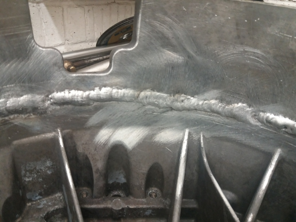

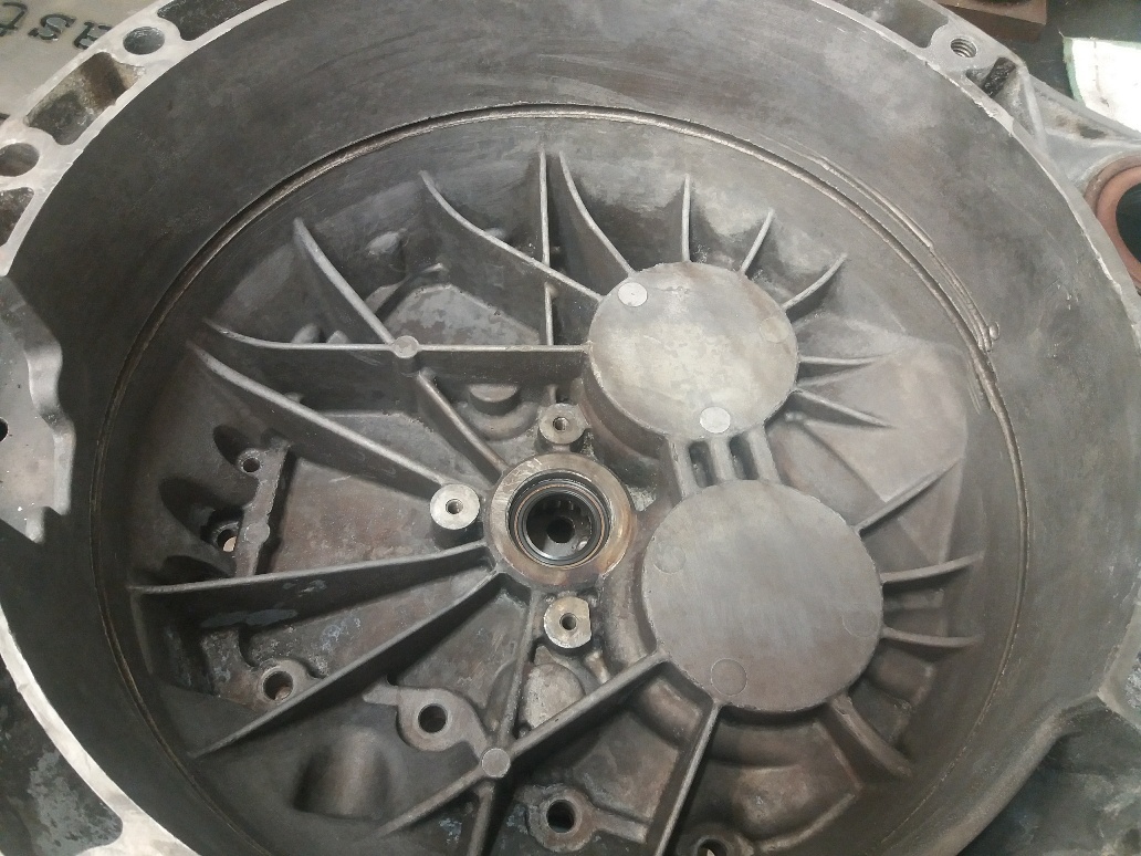

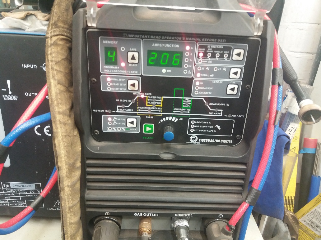

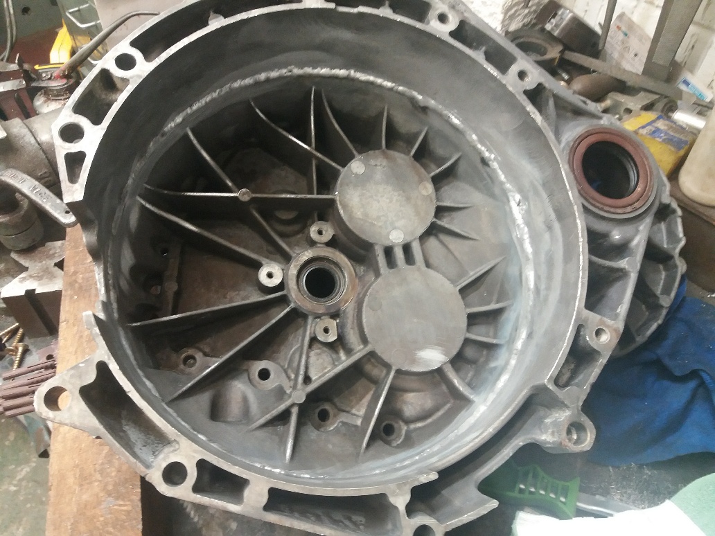

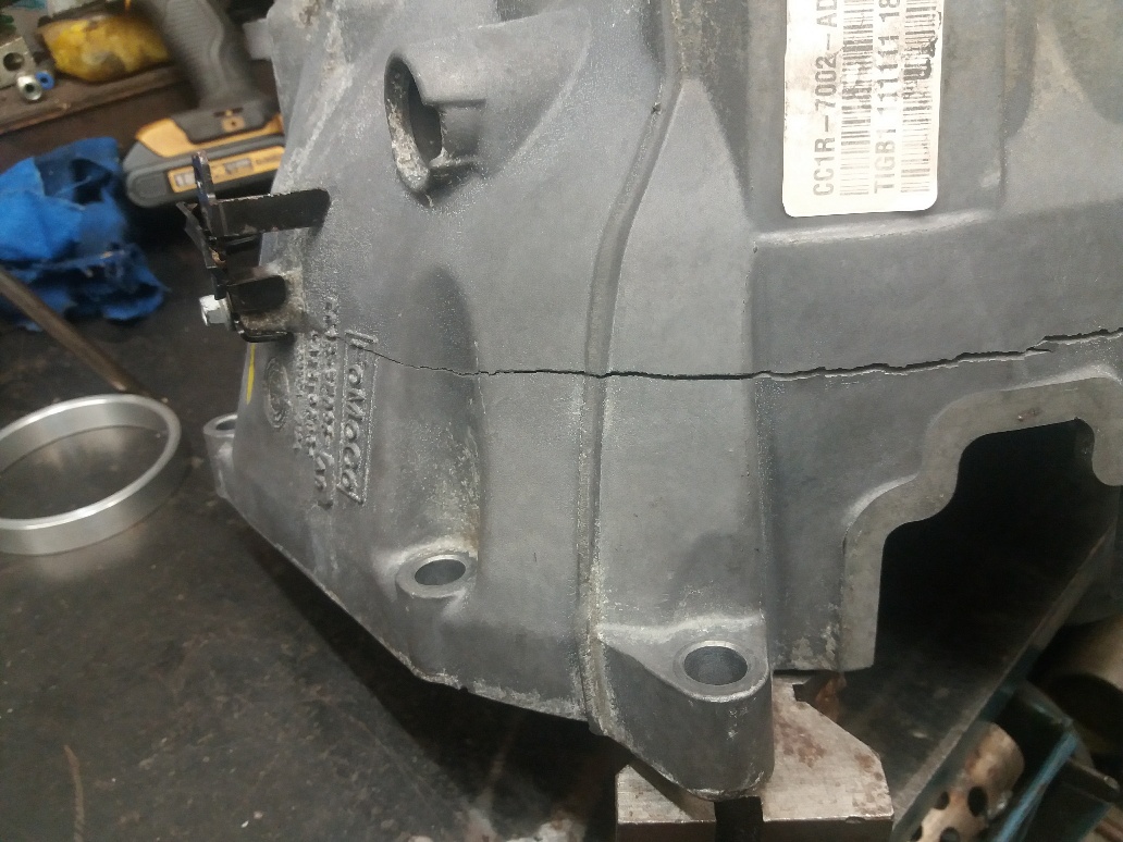

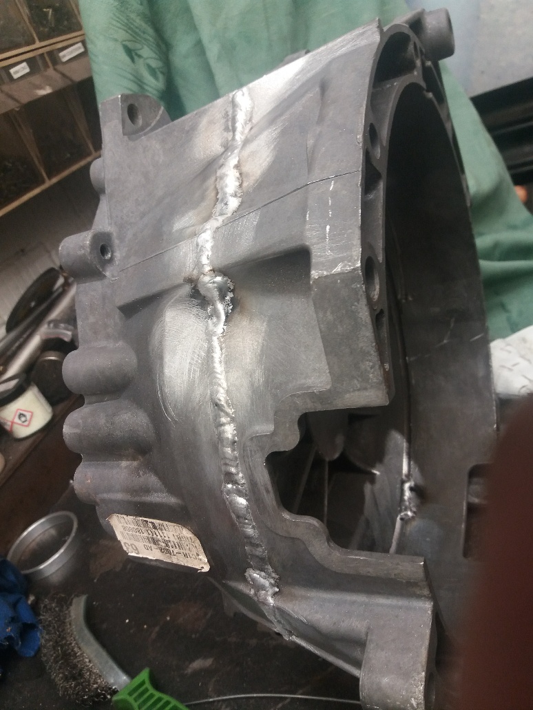

6 speed ford gear box casing

A small pin came out of the starter motor & thought it was a "Trepan" cutterHow did it break in the first place? Looks like it was cut around from the inside? Clutch or dmf?
They will find out tomorrow It welded very well for a automotive castingWell done....Id have said it would collapse if you got heat anywhere near it......does it still fit?
Ive seen cast iron ones done but the few times Ive known anyone try the die cast alloy ones have collapsed....They will find out tomorrow It welded very well for a automotive casting
how much is a new one....Id base it on that....perhaps 50 or 60%.....hopefully that makes it worthwhile for all involvedJust out of curiosity what price would you put on this repair
45 min prep 15 min welding
