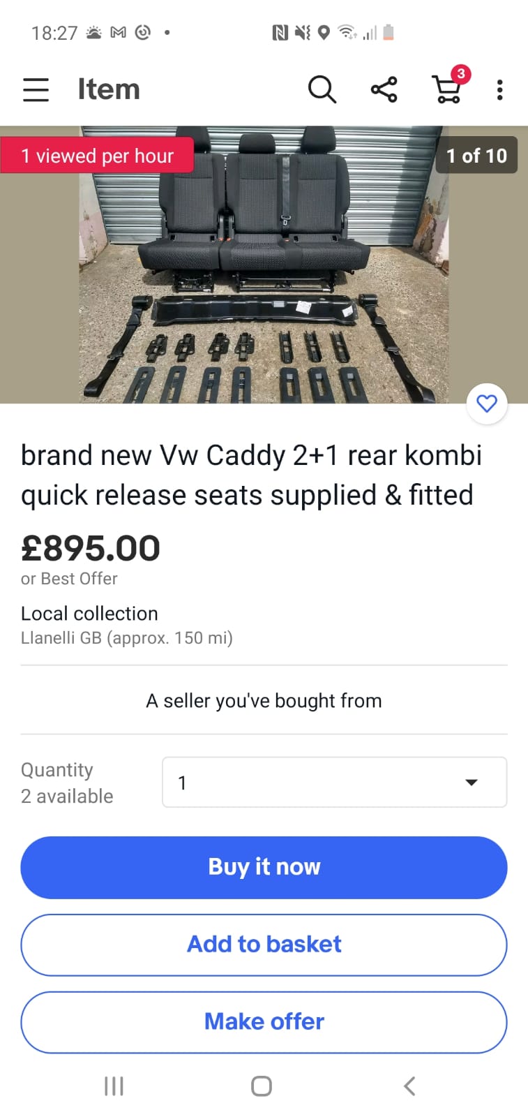

I haven’t but I would have expected decent instructions with the kit?
Yep done it.
Was a pain as ended up removing brackets and braces from a touran for all the bits.
Worked as same floor pan as the caddy just has an extension to remove. (Spot welded tray)
Not sure if the kit younlinked to is genuine or aftermarket or a maxi kit though.
the kits on route but will see what’s in side when it turns up
